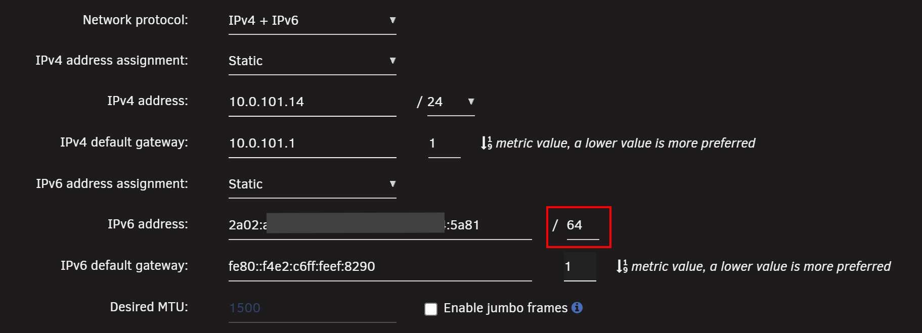

Your static IPv6 configuration is wrong for eth0.
  • Stop the array
  • Go to Settings -> Network Settings -> Eth0
  • Change the prefix to 64 (see example below)
  • Start the array
Docker should now be able to properly create the custom network.
