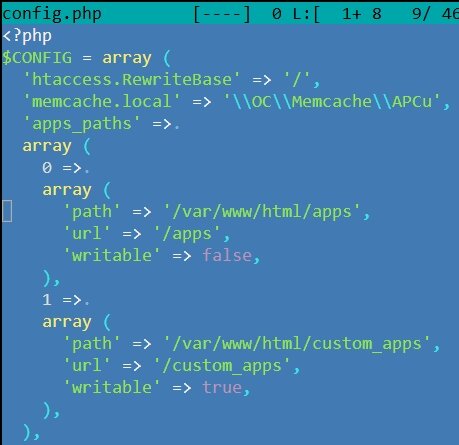

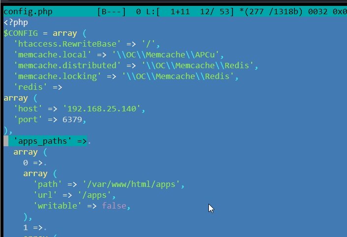

  8. I added a static IP to the Redis docker and it now "appears" to work. It opens and there is no longer a security & setup warning about Transactional File Locking. Outside of that I assume it is working, not sure how to tell for sure. But in my config.php, I have an entry 'apps_paths' =>. Seems to be misplaced now. Where does it go. Attached are my original config and the modified one.

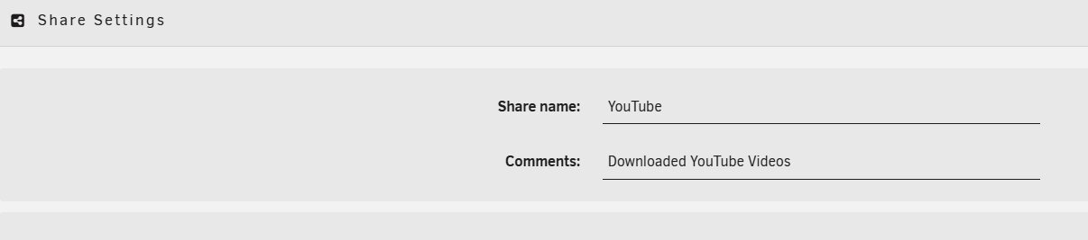

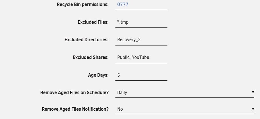

  14. I have a share called "YouTube" and I have it set in the Recycle Bin plugin to be an Excluded Share. Yet it is still creating the .Recycle.Bin folder. What do I have set wrong? I do not want to have the deleted files in this share to go into a recycle bin.
