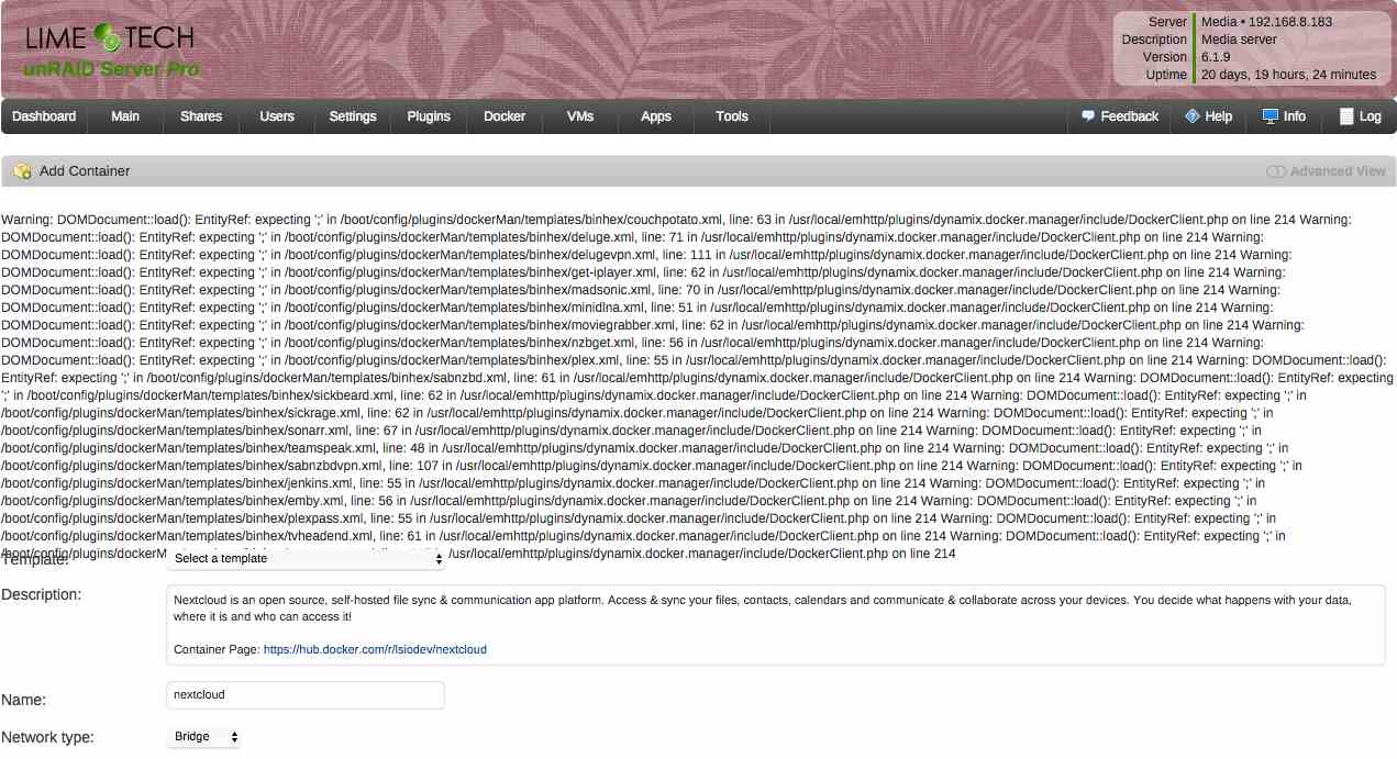

Tried to install using community applications and got a screenful of error messages. Screenshot attached. I updated the Community applications to the latest version before clicking on the add button. Running UR 6.1.9
If I was going to take a guess, either unRaid lost track of your flash drive, or your flash is corrupted.  Its not CA  Diagnostics should tell the story
I just used CA to install Linuxserver.io's nginx docker without any problems. Could it be that the flash drive is only a problem for the nextcloud docker?
Looked a bit closer.  Those errors are from the repositories.  Since you're using CA, there is zero reason to use repositories.
Go to Docker - Docker Repositories and get rid of everything in there.
Thank you Squid. That fixed it. I did not realize that CA eliminated the need to have the repositories entered on the docker page.
