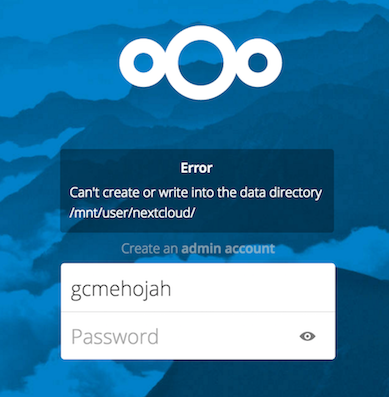

Thanks for the reply.  I tried putting in /mnt/user/nextcloud but I get an error that states can't create or write into the data directory /mnt/user/nextcloud.  Any thoughts?  I know I am close here :)
from unraid command line type.
ls -lah /mnt/user
and paste the output here.
ls -lah /mnt/user

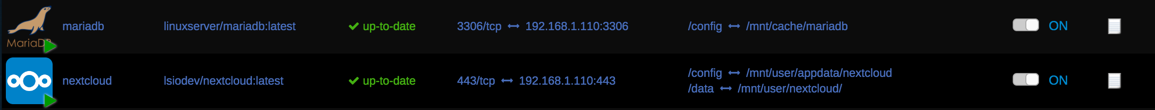

Here's mine:
Your permissions look ok to me.  So I'm confused as to what is going on...
Can you post a screenshot like mine above but for both Nextcloud and MariaDB please?  And what version of Unraid you using?  And just to check, this is a completely fresh install?

Here you go.

Here is the error I get when I try to finalize the setup:
don't change the storage location in that window from /data
/mnt/user/nextcloud doesn't exist inside the container
How do I change it to use the mnt/user/nextcloud share?
you don't.
http://imgur.com/a/FLANd
set your folder in the add/edit docker screen like this.
then, don't change the /data in the setup screen for nextcloud.
/data and /mnt/user/nextcloud are the point where the folder inside the container and the folder outside the container become the same point, provided you set it as shown in the add/edit screen.
