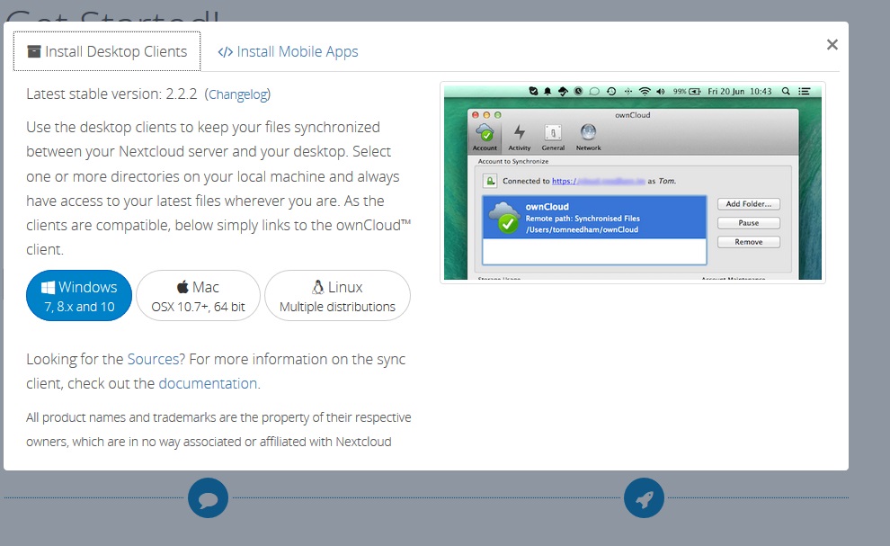

Side note: I am using the lets encrypt docker and proxy, working great i can get to my nextcloud, however when i try to setup a sync client , the sync client tells me it cannot find the server instance. anyone else having that issue. i have not tried just port forwarding nextcloud on my router because i really want to use the lets encrypt SSL.
I'm not sure I follow you with the sync client thing...  What sync client?
I assume the Owncloud Sync client for desktop systems.
yes

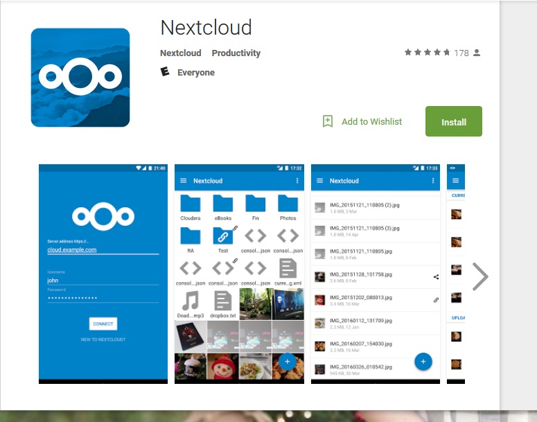

android and there's an apple one
I don't use the desktop one but my Android one works fine...

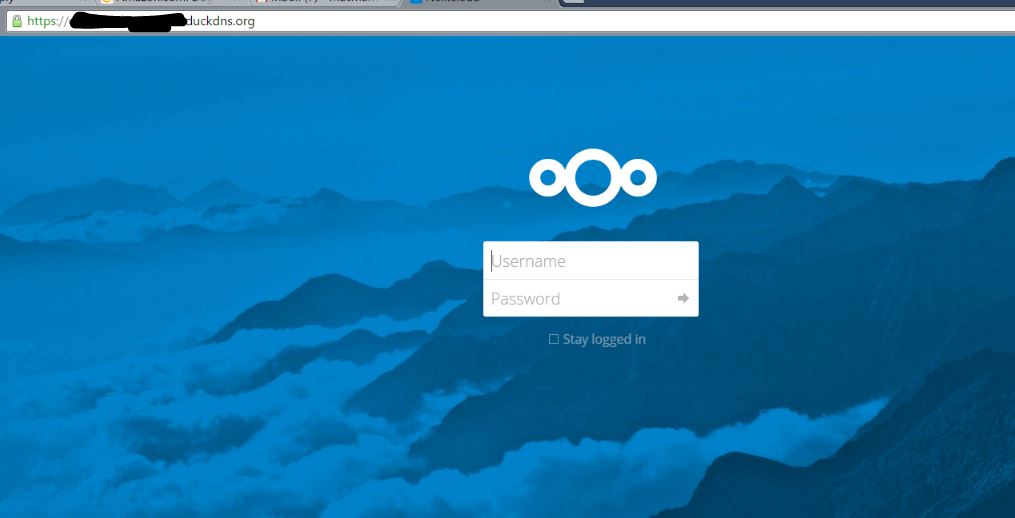

I can get it from my web address just fine its the sync client that wont connect. i not sure its because i am using DDNS or what. i'll post on the nextcloud forums, just happy its up and running.

Can you get to the web address from outside your house?
Yes,
Both the Android and Desktop clients connect fine for me outside my LAN.
I probably will have to work on my let's-encrypt docker, that probably the issue.
