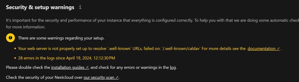

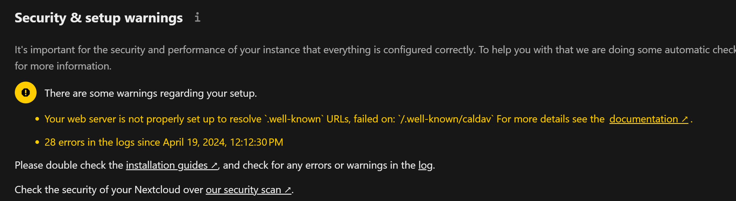

5 minutes ago, blaine07 said:
Upgraded to 29 and can't seem to figure out how to fix this. Configured exactly the same on 28 and wasn't a "error" then so not sure what I have incorrect? Any ideas?
https://docs.nextcloud.com/server/29/admin_manual/issues/general_troubleshooting.html#service-discovery
Ahh found this: https://github.com/nextcloud/server/issues/45033#issuecomment-2079306503
In HERE: https://github.com/nextcloud/server/issues/45033
Had to change THIS: orig-cal-nc29.thumb.jpg.a027b7d11ec872d813844c167bfa9a9e.jpg
To THIS: image.thumb.png.049012a41ff7a0953813b2cdd2809f11.png
