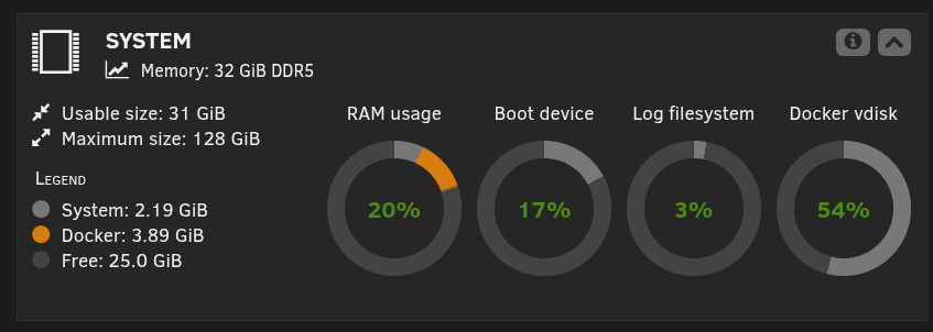

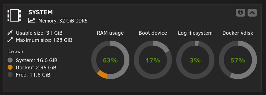

I recently started seeing out of memory conditions every night in my syslog since October 6, 2026. Using 7.3.2 while I wait to be comfortable enough to go to 7.3.3. It seems to be a different process each time but mostly Plex transcode. I have 32GB of RAM and a fairly modest(compared to others here) set of containers(Nextcloud, Immich, Arrs, a few others but nothing crazy). I rebuilt my Plex database index per some suggestions. I also added the parameters to limit RAM usage(Extra Parameters = --device=/dev/dri --mount type=tmpfs,destination=/tmp,tmpfs-size=4000000000 --no-healthcheck --memory=4g). Here is the memory usage right after a reboot: And then in the morning: And then I see another OOM condition in the logs in the morning. Any suggestions? flores-diagnostics-20261019-0844.zip
