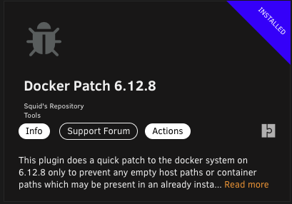

This plugin does a quick patch to the docker system on 6.12.8 only to prevent any empty host paths or container paths which may be present in an already installed template (or on a new installation) from triggering an error (and creating an orphan image) when updating the application.
This is NOT fixing any bug in Unraid at all.  Previously, the docker run command (eg: on 6.12.6) would not return an error if there was no container path specified.  The docker system in 6.12.8+ does return an error (which is the proper operation).  This quick patch simply has the docker system not add in to the docker run command any paths which has either the container or host side of it blank.
If you did update an application and then had it orphan due to an empty path, then simply installing this plugin and then going to Apps, Previous Apps and reinstalling will get you back and running without changing the template to how it should be set up

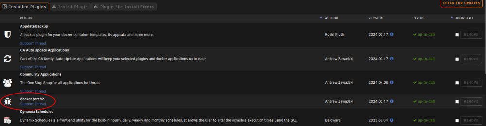

I guess a restart is required after installing the plugin right?
My question was more general, is a reboot requiered after the install of the plugin?
no

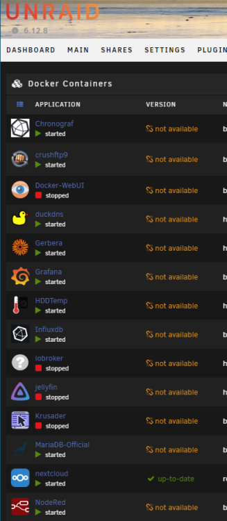

34 minutes ago, lawrence1986 said:
I install this patch
This plugin has nothing to do with any other settings etc you may have.   I've moved your posts (and itimpi's) to here
I have the "Problem" that are the Borgserver Docker Container sometimes disappear on 6.12.6. It this the same Issue that this Patch are fixed on 6.12.8?
I reinstalled the Docker Container again after I see this are disappear.
IDK. What this plugin very slightly changes on 6.12.8 isn't needed on earlier OS versions
