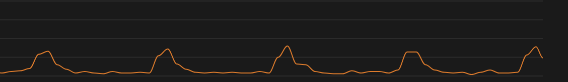

Thanks, I think it may have been my 'snapshots' dir causing it. I use SpaceInvaderOne's replication script to replicate my ZFS cache snapshots to the array. It's possible I didn't have this in the previous caching as it would have been setup after Cache Dirs was setup, however I didn't think adding a share to cache dirs would have caused such a cpu spike! I'm seeing smaller cpu jumps over the same time period, which is only minor, but is there a setting I can use to adjust these? I don't write to the array very often so probably don't cache dirs updating this often.

I'm now having the spiking CPU issue with the latest version of Cache Dirs. The below is from a 30 second window of CPU activity. I didn't have this problem with the old 'incompatible' one. My settings are whatever defaults come with the plugin (including /mnt/user scanning turned off), except I have removed any directories on my cache, so only have array drives cached by the plugin, none of which are written to at the time (the disks are all spun down). These are the settings I've always had and it's been fine. Disabling the plugin completely stops this behavior. Any ideas?
