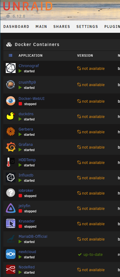

Hi, should it fix also the issue that im not able to see available updates as before?
Now (not sure from which version) show on 90% dockers " not available"
Thanks
No.  This only changes how docker handles empty paths.   If you're seeing "Not Available" then it effectively means that the system can't hit docker hub (or GHCR) to see if there's an update available due to network issues, VPN, etc etc
thanks for point out possible issues, seems is some port issue on VPN, some docker are loading/checking updates and others dont
