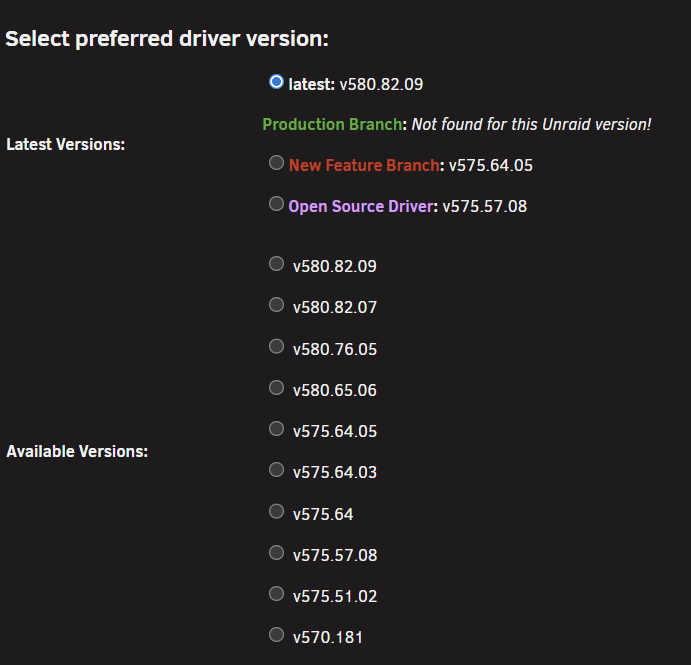

  9. Thanks again for all the help. Managed to grab a NVIDIA RTX A400 and was able to successfully install it today. Everything is working well and updated to the new OS using the v590.48.01 drivers. Appreciate the recommendations and assistance from everyone including @ich777 should be a nice GPU change for the coming years.

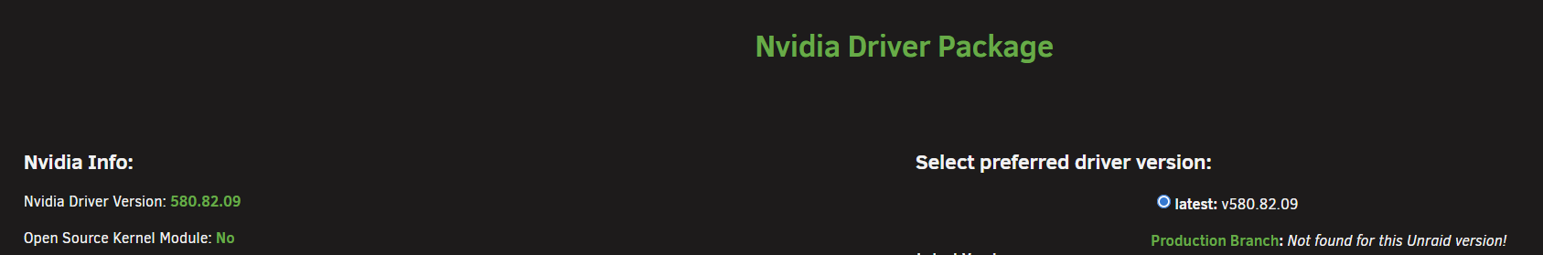

  10. Hello, Appreciate this feedback and attention to detail. I proceeded as per your instruction's and selected the driver version manual/static - v580.82.09, which quickly prompted the Done button. The context and additional information helped, thank you for taking to time to explain that. Regarding the suggestion regarding considering a new GPU, replacing the current Quadro P2000. I appreciate you tossed the A400 in the hat, truthfully the P2000 was deployed strictly for transcoding, and wasn't locked or limited to how many sessions or transcodes it could do. With that, I wouldn't know where to start with comparable replacement GPU and I am happy you mentioned the A400 as it gives me a baseline to go from and look at that card specifically or comparable models. I may circle back with some questions on that. (NVidia vs AMD) Thank you again!
  11. Thanks ich777, respect you and everyone's knowledge here in the community! It has been a busy few weeks which has taken me out of the loop, which required me to reach out for a quick sanity check before proceeding. Was able to update the the plugin successfully today. Attached current status of the plugin Currently I am pending triggering the OS update as I require to select a maintenance window that works best. From what I am understanding, before proceeding, is to manually select/set the radio button to 580.82.09 (screenshot) before pushing the OS update? If I am correct, doing this will keep it on the current version; which will allow further review of the driver, after the OS update/maintenance window? Open to feedback, thank you again! Thank you again.
  12. Hey, appreciate the insight. Yes currently using the Quadro P2000. I was unaware of the driver/hardware support changes. Your feedback clarified the next steps. Thank you for you time to clarify.

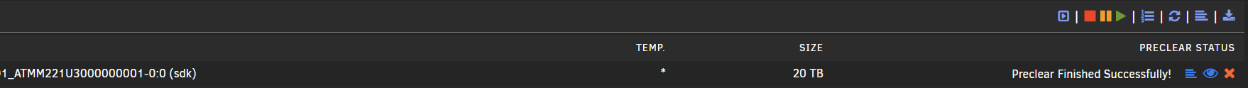

  15. Follow up. Have added a new disk to UD for another net-new pre-clear, however unraid is detecting the drive signature as already cleared, I do believe this a due to how UD mounts the disk seeing 'like disk' as already completed. How would one go about starting a fresh pre-clear when this occurs? Is it possible the previous disk that was cleared successfully, the preclear tool didn't stop the session, and the drive was powered down via external dock... and the GUI requires all sessions to be stopped BEFORE the disk is powered down?
