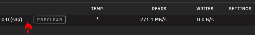

  15. Follow up. Have added a new disk to UD for another net-new pre-clear, however unraid is detecting the drive signature as already cleared, I do believe this a due to how UD mounts the disk seeing 'like disk' as already completed. How would one go about starting a fresh pre-clear when this occurs? Is it possible the previous disk that was cleared successfully, the preclear tool didn't stop the session, and the drive was powered down via external dock... and the GUI requires all sessions to be stopped BEFORE the disk is powered down?
  16. Hello, It has been a while since preclearing a disk with UD Does anyone know where the 'eyeball' icon went in the GUI to view the preclear status window went... am I blind, or does it appear later in the clear? I received the notification the job started and would like to monitor it ... I recall there was a way to do this in the past to see the status window somehow....perhaps I am jumping the gun as the first cycle is pre-read and the status is unavailable during this stage?
