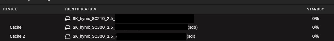

Hello, Apologies for the delay. sdb sdi Are SSD, so they will not spin down Visual here I am not quite sure why your plugin is seeing another SK_hynix -- maybe it grabbed the info when it was plugged into UD, and since unmounted it resides in the db as a logged device? I currently have some nvme in UD as well, staged to become pool devices... haven't got around to deploying them as of yet. I also recently disabled 'Dynamix Cache Directories' to possibly rule that out, been doing some reading on that plugin to see if it performs drive spin ups to cache, which it shouldn't... but it's new to me. As for the connection type, all disk are plugged into the LSI card previously stated: LSI SAS 9300-16I HBA *IT MODE* Learning on the fly with your assistance of things to try, to hopefully assist with overall feedback to tweak this plugin, and to attempt to test the concerns you would like feedback on. Appreciate your time on this and the assistance :-)
