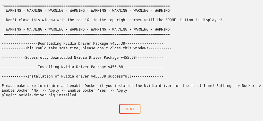

Installation of the Nvidia Drivers (this is only necessary for the first installation of the plugin) :

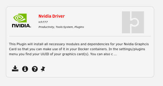

  1. Go to the Community Applications App and search for 'Nvidia-Drivers' and click on the Download button (you have to be at least on Unraid 6.9.0beta35 to see the Plugin in the CA App) :
    Or download it directly from here:
    https://raw.githubusercontent.com/ich777/unraid-nvidia-driver/master/nvidia-driver.plg
  2. After that wait for the plugin to successfully install (don't close the window with the Bildschirmfoto_2020-11-15_20-00-56.png.af97f7863eaa795c54573fbb65544e94.png, wait for the 'DONE' button to appear, the installation can take some time depending on your internet connection, the plugin downloads the Nvidia-Driver-Package ~150MB and installs it afterwards to your Unraid server) :
  3. Click on 'DONE' and continue with Step 4 (don't close this window for now, if you closed this window don't worry continue to read) :

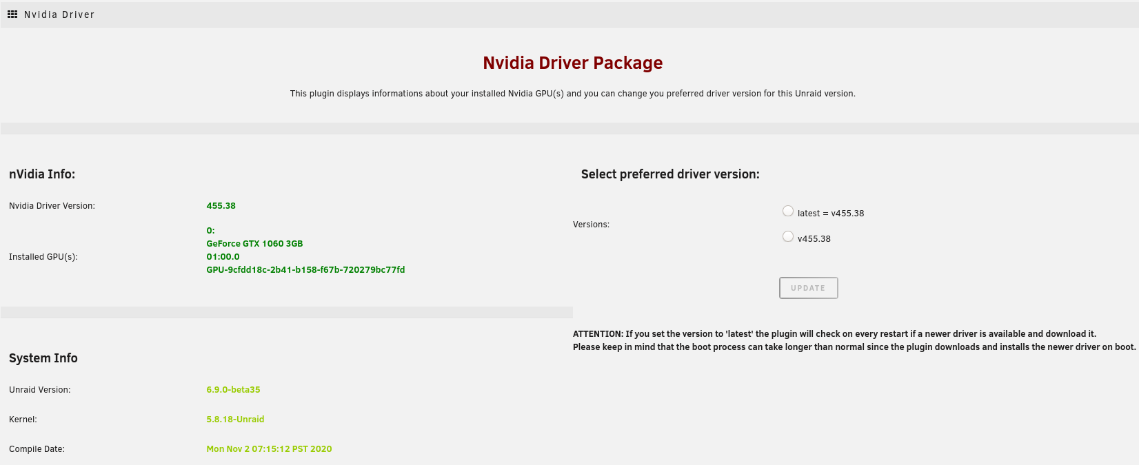

  4. Check if everything is installed correctly and recognized to do this go to the plugin itself if everything shows up PLUGINS -> Nvidia-Driver (if you don't see a driver version at 'Nvidia Driver Version' or another error please scroll down to the Troubleshooting section) :Bildschirmfoto_2020-11-15_20-17-13.thumb.png.41a9d7df236bbb8974687b91b7a100ad.png
  5. If everything shows up correctly click on the red alert notification from Step 3 (not on the 'X'), this will bring you to the Docker settings (if you are closed this window already go to Settings -> Docker).

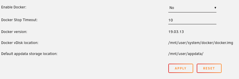

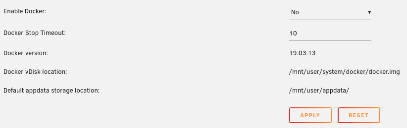

  6. At the Docker page change 'Enable Docker' from 'Yes' to 'No' and hit 'Apply' (you can now close the message from Step 2) :
  7. Then again change 'Enable Docker' from 'No' to 'Yes' and hit again 'Apply' (that step is only necessary for the first plugin installation, you can skip that step if you are going to reboot the server - the background to this is that when the Nvidia-Driver-Package is installed also a file is installed that interacts directly with the Docker Daemon itself and the Docker Daemon needs to be reloaded in order to load that file) :

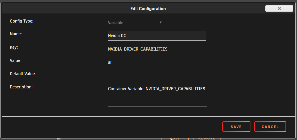

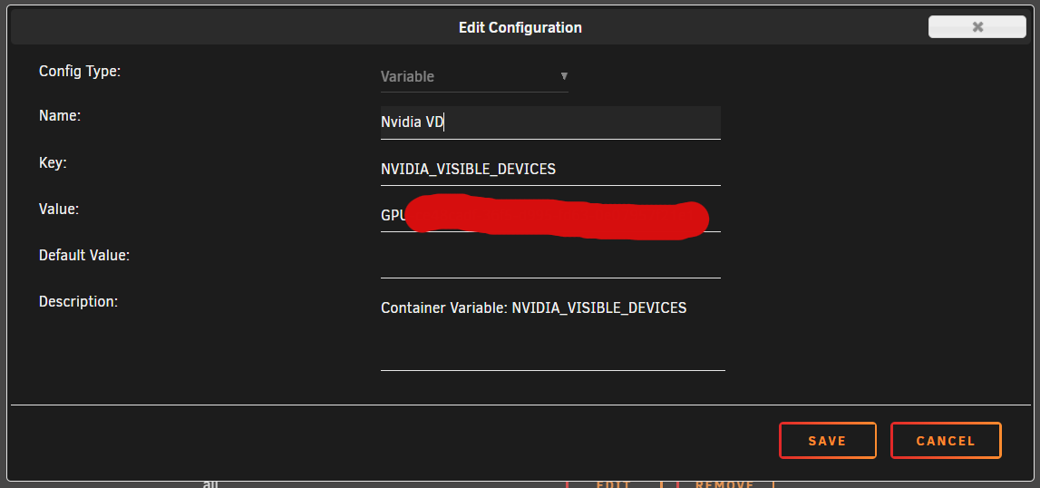

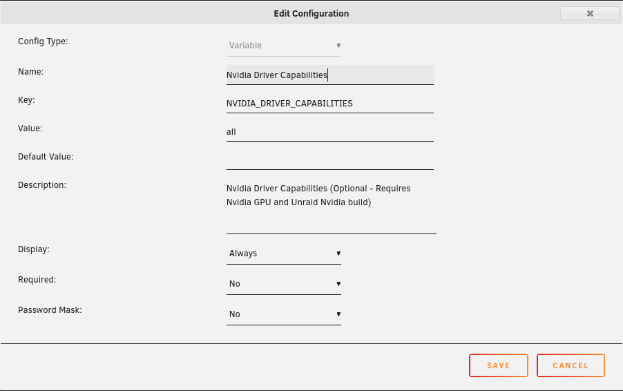

To utilize your Nvidia graphics card in your Docker container(s) the basic steps are:

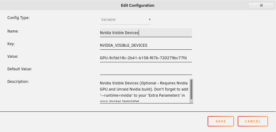

  1. Add '--runtime=nvidia' in your Docker template in 'Extra Parameters' (you have to enable 'Advanced view' in the template to see this option)

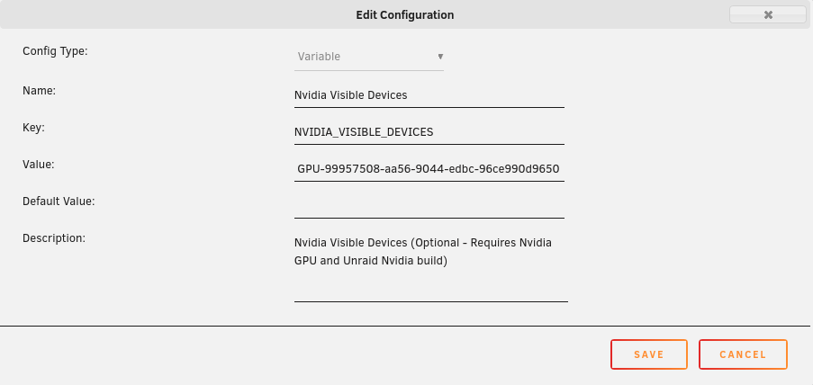

  2. Add a variable to your Docker template with the Key: 'NVIDIA_VISIBLE_DEVICES' and as Value: 'YOURGPUUUID' (like 'GPU-9cfdd18c-2b41-b158-f67b-720279bc77fd')
  3. Add a variable to your Docker template with the Key: 'NVIDIA_DRIVER_CAPABILITIES' and as Value: 'all'

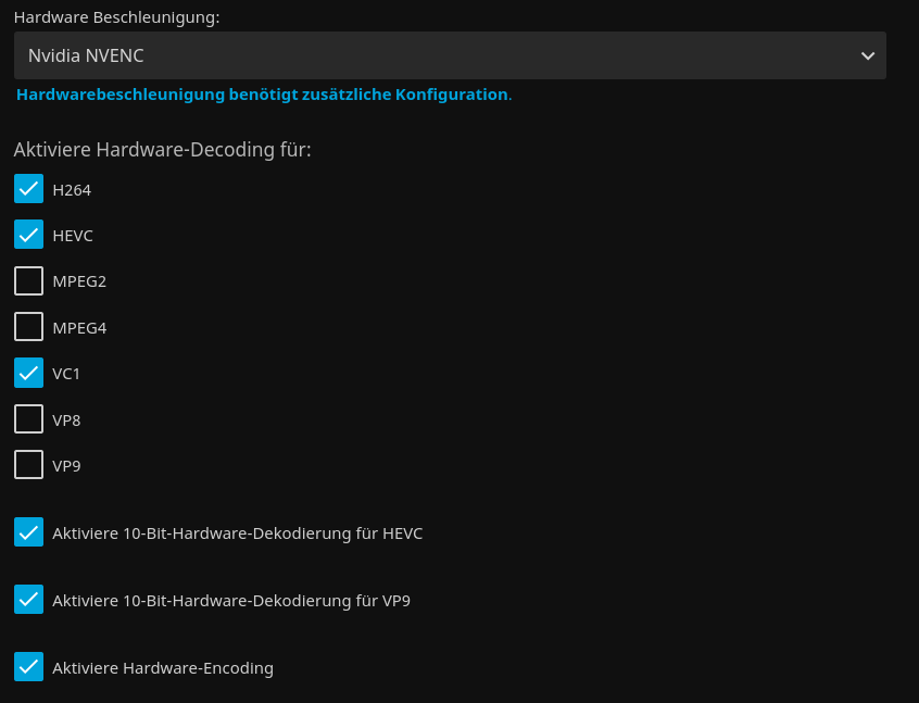

  4. Make sure to enable hardware transcoding in the application/container itself

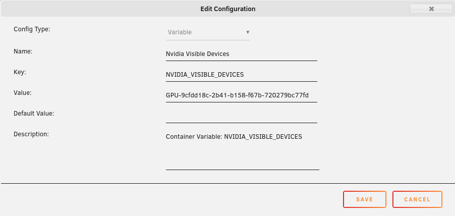

UUID: You can get the UUID of you graphics card in the Nvidia-Driver Plugin itself PLUGINS -> Nvidia-Driver (please make sure if there is no leading space!) :

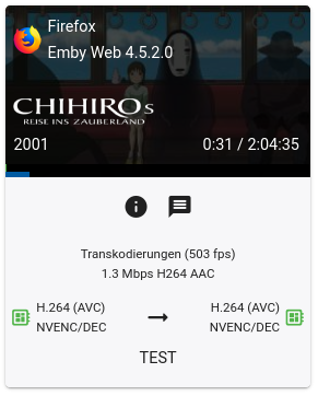

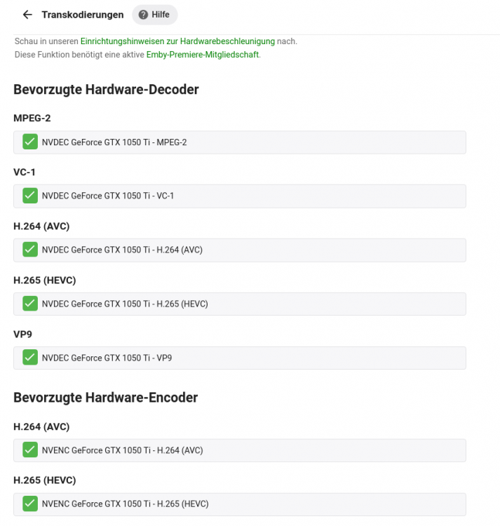

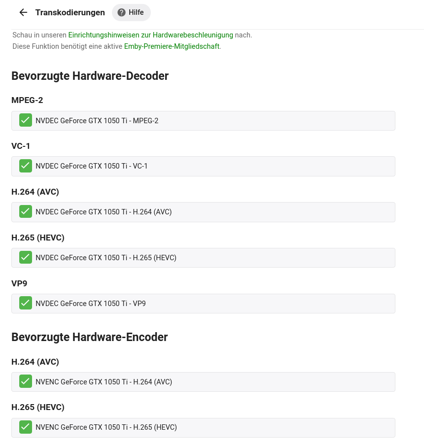

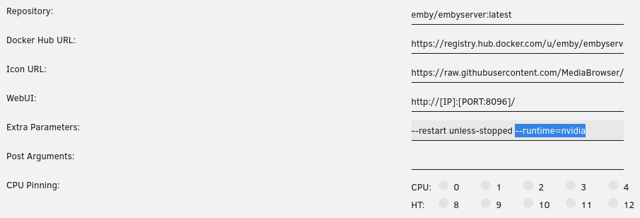

Emby:
Note: To enable Hardware Encoding you need a valid Premium Subscription otherwise Hardwar Encoding will not work!
  1. Add '--runtime=nvidia' to the 'Extra Parameters':
  2. Add a variable to your Docker template with the Key: 'NVIDIA_VISIBLE_DEVICES' and as Value: 'YOURGPUUUID':
  3. Add a variable to your Docker template with the Key: 'NVIDIA_DRIVER_CAPABILITIES' and as Value: 'all':

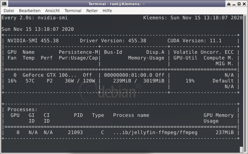

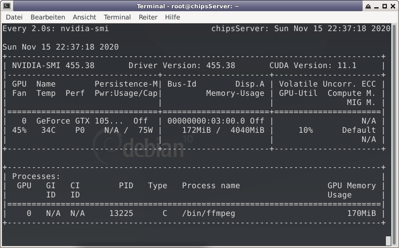

After starting the container and playing some movie that needs to be transcoded that your graphics card is capable of you should see that you can now successfully transcode using your Nvidia graphics card (the text NVENC/DEC is indicating exactly that) :

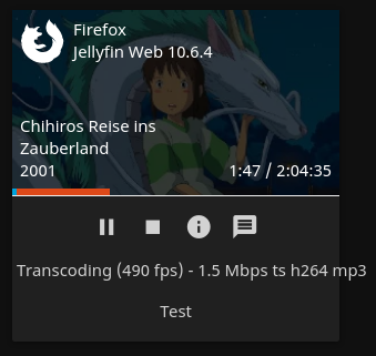

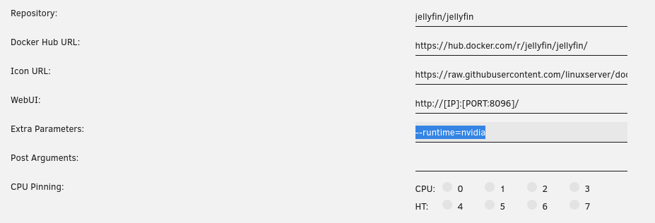

Jellyfin:
After starting the container and playing some movie that needs to be transcoded that your graphics card is capable of you should see that you can now successfully transcode using your Nvidia graphics card (Jellyfin doesn't display if it's actually transcoding with the graphics card at time of writing but you can also open up a Unraid terminal and type in 'watch nvidia-smi' then you will see at the bottom that Jellyfin is using your card) :

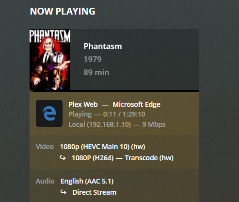

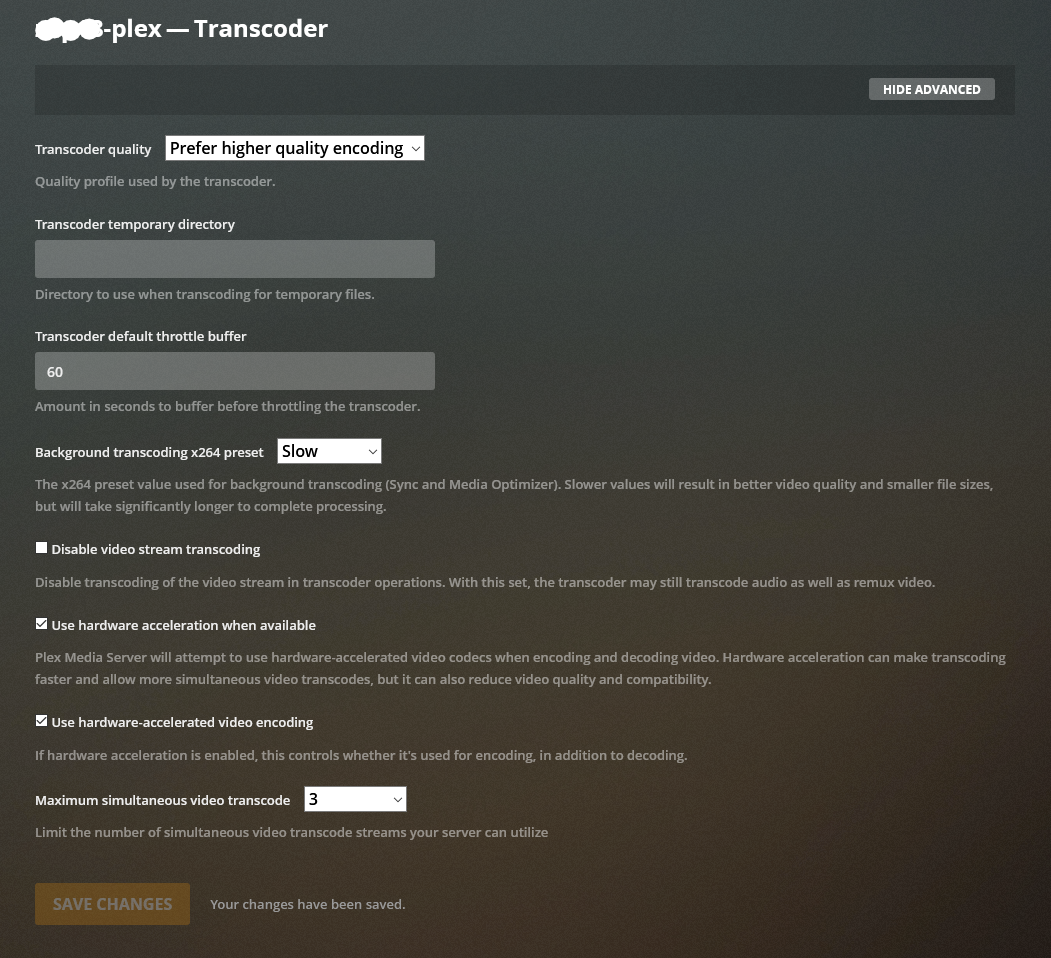

PLEX:
(thanks to @cybrnook & @satchafunkilus that granted permission to use their screenshots)
Note: To enable Hardware Encoding you need a valid Plex Pass otherwise Hardwar Encoding will not work!
    image.png.e7936df6655fa8b2631edee82907bf8e.thumb.png.eca65efab0d22d08f48dbcad91bcc173.png
  4. Make sure to enable hardware transcoding in the application/container itself:mXoPaDq.thumb.png.01042484359ad04ec25a52741ccb3e67.png
After starting the container and playing some movie that needs to be transcoded that your graphics card is capable of you should see that you can now successfully transcode using your Nvidia graphics card (the text '(hw)' at Video is indicating exactly that):

I had an issue with the linuxserver plex container. For some reason even with all of the correct parameters it would not do hardware accelerated encoding. My nvidia-smi process showed no use. I added the same parameters to the binhex plexpass container and everything started working correctly. I am using Unraid 6.9.0 beta 35. Thanks to ich777 for the suggestion.
Sounds pretty similar to my issue with the binhex plex container. After switching to binhex plexpass everything worked fine.
