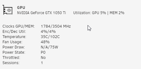

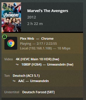

when i run a 4k movie and transcode to 1080p, the ENC/DEC Util is very low.. just 4%.. and cpu is much higher...
should it not be the otherway? first use gpu and then use cpu?

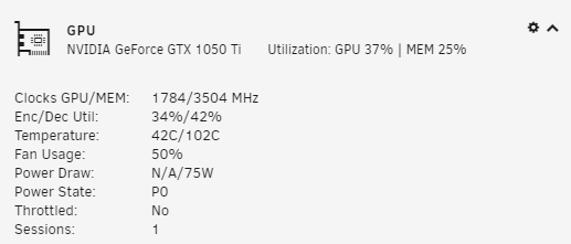

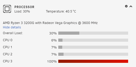

edit: when i give him just 1 core it looks like this:
the 4th core of cpu(which is the assigned one) is at 100% and the gpu is at 37%.. seems this is very strange
Seems totally fine but I could be wrong...
The CPU is normally used to transcode the audio of the file that you are playing.
Can you try to disable the HW transcoding in Plex (uncheck both boxes), save, restart the container and then again enable both boxes for HW transcoding.
Is this the same file that you are playing and also at the same position?
The GPU transcoding is usually lightning fast and it could also be that it finishes before the audio transcoding is finished.
One side note please don't use the plugin in the dashboard for comparison, better you open up a terminal from unraid and type in 'watch nvidia-smi' and send a screenshot from the output there you see detailed what your graphics card is doing, like in the second post of this thread at the end you see also the output of nvidia-smi or at least what it should look like).
