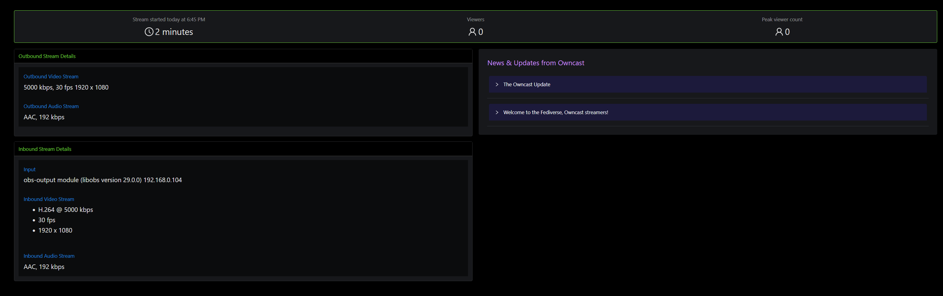

  13. Ok. So this was my error. I was streaming at a rate "passthrough". This means, while encoding appears to be happening (according to the log), it is not. No encoding is happening server side - the stream is literally just passing through. I discovered that you can have multiple streams of different bitrate, frame rate, resolution, etc (low, medium, high and passthrough if you will). It's here that encoding actually happens. Once you set the different rates and begin the stream, the hardware transcoder using the gpu is engaged. Great work on nvidia plugin and this docker OP!

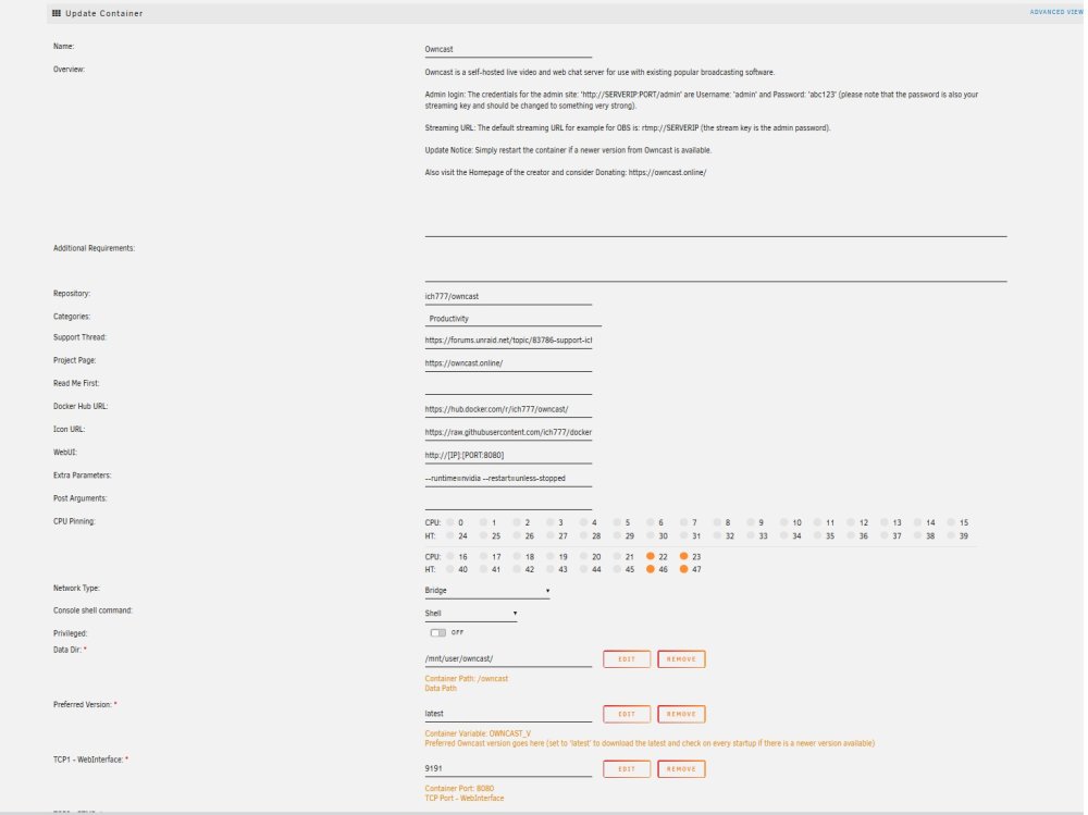

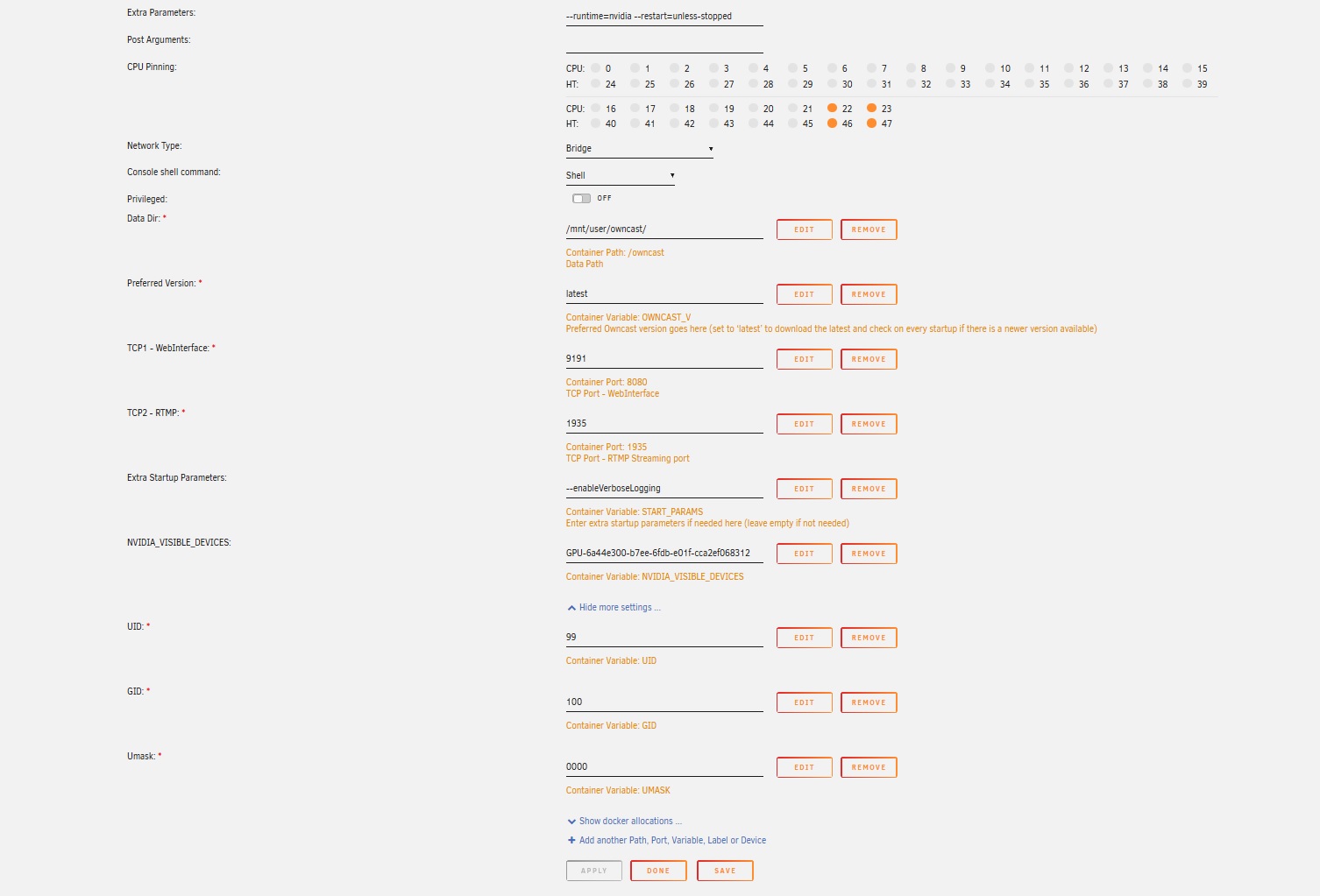

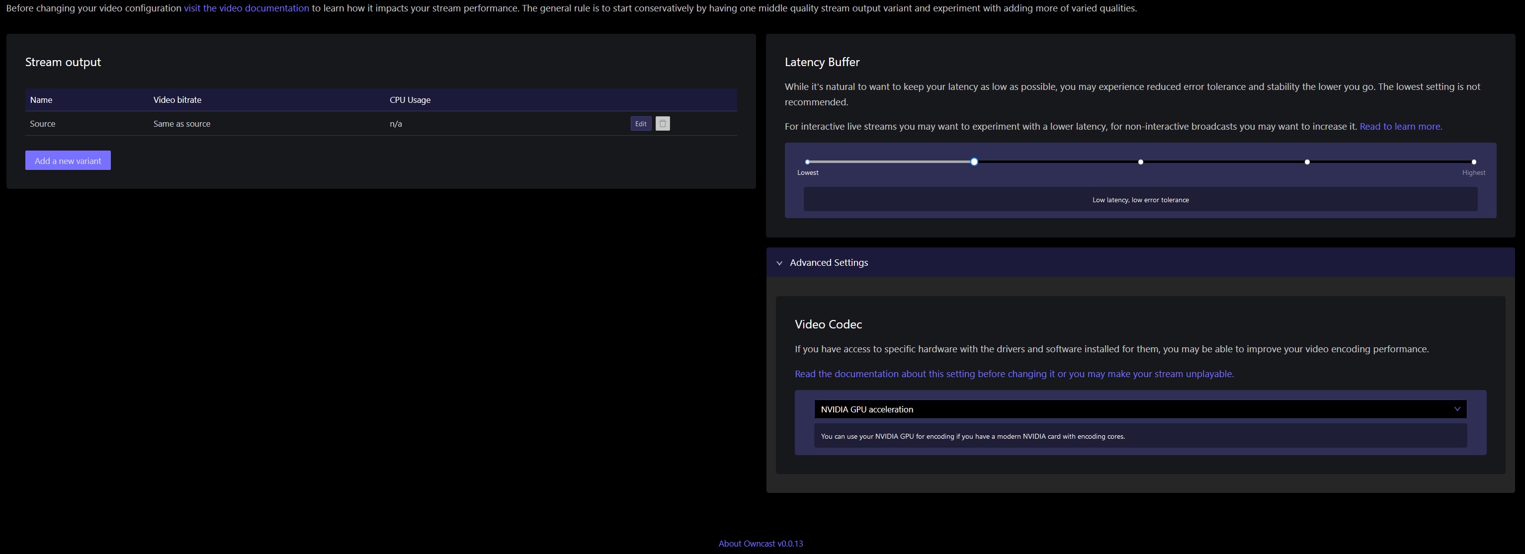

  14. Thanks for catching that missing variable. I added it -- still no go. GPU is not being used when encoding. nvidia-smi shows nothing running when a stream is being sent to owncast. Will play with it some more tomorrow and see if I can narrow down the issue. Thanks again!
  15. Thanks for the quick response. Not sure what you want to see from the owncast config. The owncast log says: "Video transcoder started using nvidia nvenc with 1 stream variants." But I can see no evidence of that. Is there a command in the docker that can be run by ffmpeg to give data on the nvidia hardware that is using the nvenc codec (like the gpu id)? Below is what i see in the admin area which appears to be normal. And attached is the advanced view. I pretty much guessed by using the docker notes (and having done this for other dockers) where everything goes. Let me know your thoughts..
