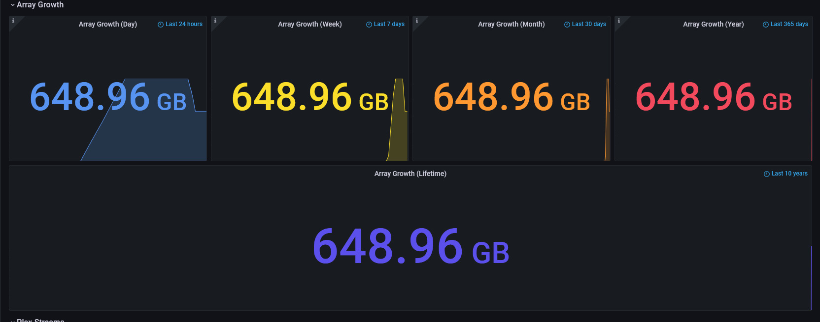

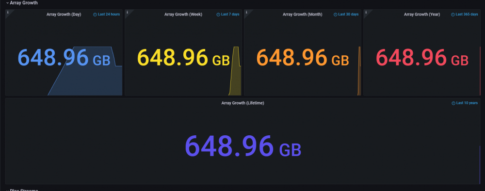

  13. Is this equation you have for SSD Life Used still correct for a 1 TB Samsung 970 Evo Plus with a TBW of 1200? *512/1000000000/600*100 I'm trying to figure out what each of the numbers are standing for or how I need to update that equation in the future if I get different SSD's with different TBW's. Confused on the Array Growth section. My assumption is that this number should always be increasing. I've been doing a ton of downloading the last couple days and at one point it was showing 1.1 TB of growth which made sense, but today its showing 648 GB like it went down but I haven't deleted anything?
