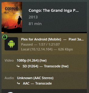

Tried a 1080p to 720p and while plex still tells me it's HW transcoding, I still don't have a running process on the nvidi-smi. (I know the pic says SD, but I did both 720 and SD just to see)
Can you look at the CPU usage? If it's very low while transcoding it's definetely working :)
Eventually that's also a thing that's Nvidia-SMI is not showing in your case...

Unfortunately the CPU usage was maxed out, so I think it's doing it through that and just not touching the GPU.  I'm beginning to wonder about it's compatibility in general.  It is listed as part of the driver supported cards, but again, it is 6+yrs old.
