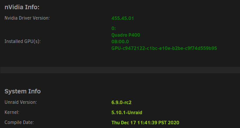

I have the following setup:
  • ESXi 6.7 with the latest patches
  • UnRAID 6.9.0-rc2
  • Nvidia Quadro P400
Passing through both the nvidia card and audio device.
Other passed through devices like sas hba, and nvme drives work perfectly.
Without any flags in the vex file I can boot the UnRAID virtual machine and can see the Nvidia card

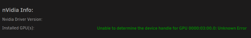

But anything else has errors like
root@XXXX:~# nvidia-smi
Unable to determine the device handle for GPU 0000:03:00.0: Unknown Error
Nvidia Driver Settings page gives me this error
If I add the hypervisor.cpuid.v0 = FALSE variable to the vmx file it freezes after bzroot and won't boot :(
Edited by zer0zer0

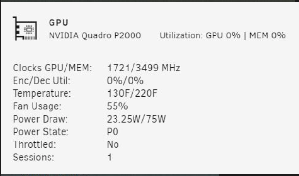

Ever since upgraded to the new version of the Nvidia driver I'm getting crazy cpu spikes. Any ideas? I had zero issues with this until I just upgraded. In top I see Nvidia-smi as using the most. If I uninstall, I level back down to almost zero cpu usage. This is all while idling. Can I roll back or what can I do?
From someone else's post but I don't see "GPU" in Dashboard like this:
The HW transcoding in PLEX works just fine.
image.png.6c7b06847dd5e11f41c3c74914d99973.pngimageproxy.php?img=&key=e5eec7c5c933ca16
Thats a separate plugin
Have you installed the GPU Dashboard? Try to uninstall this plugin first.
nvidia-smi isn't active if you install the Plugin and shouldn't use any CPU power, something must use it.
To follow up on my issues, I can boot if I choose just one cpu, so it's probably not an issue with this plugin specifically.
It is more likely to be UnRAID itself.
If I set one cpu and also hypervisor.cpuid.v0 = FALSE in the vmx file I can get it to boot and the plugin appears to be working as expected.
@ich777- if you can think of any logs etc. to get this resolved let me know
Edited by zer0zer0
Sorry I really want to help but I don't know much about ESXI. Eventually @StevenD can help, isn't there also a subforum here in the forums about virtualizing Unraid?

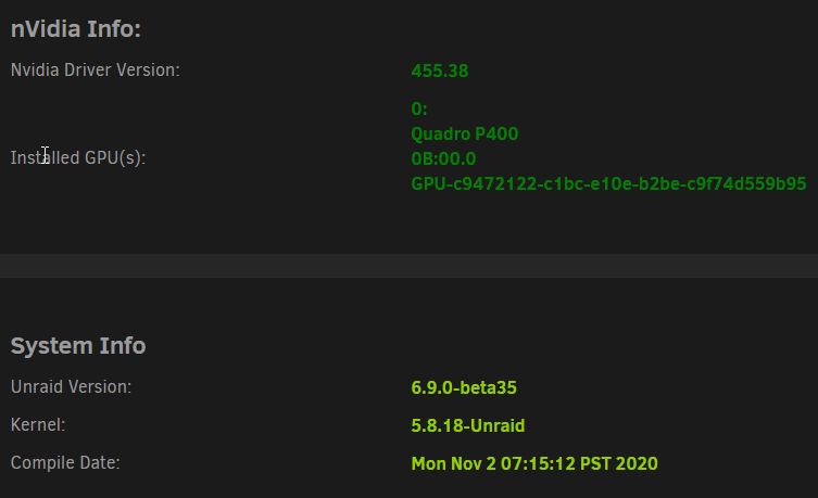

I talked to @StevenD and dropped back to UnRAID version 6.9.0-beta35 like he's running, and this issue is resolved :)
I went right from 6.8.3 to rc2 so I have to go back to that then forward to beta35.
Thank you so much for commenting and helping I really appreciate it, you saved me so much time of messing around and attempting to trouble shoot.
Im very sorry. Thank you.

  10. Went to the Dashboard to view the GPU stats, and it showed the P2000 stats
  11. Edited the Plex container, removed Device /dev/dri, Added Extra Parameters, Added Variable NVIDIA_DRIVER_CAPABILITIES and NVIDIA_VISIBLE_DEVICES, Apply changes
  12. Tried to force transcode with P2000...now it works.
