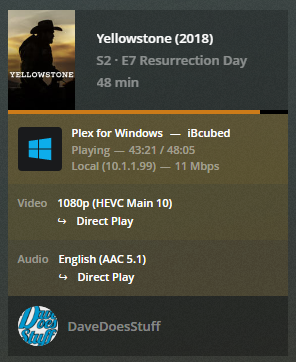

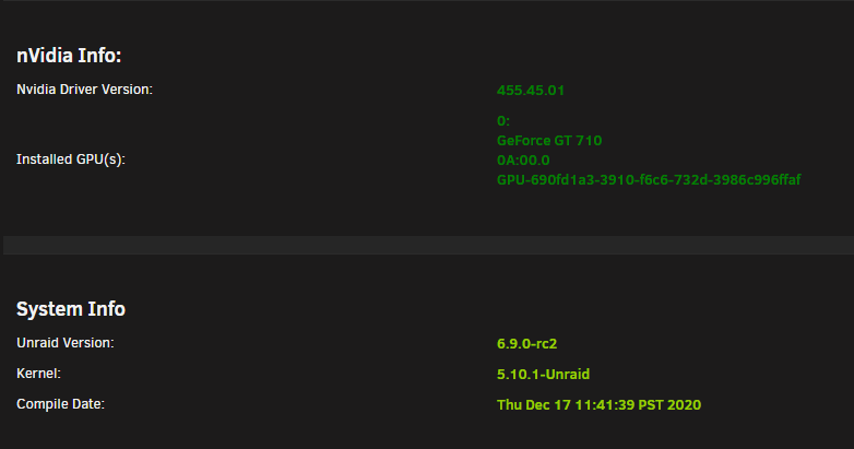

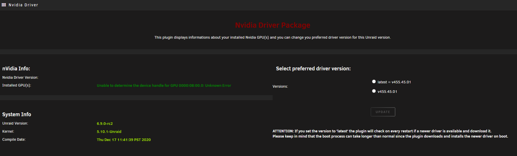

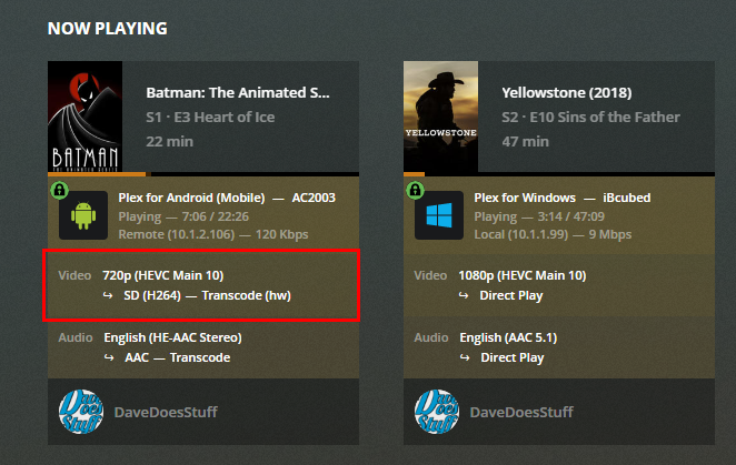

Firstly, great plugin/work!
Unfortunately I'm having some issues getting plex transcoding to work on my GT710. The very first time I installed the plugin and set everything up it worked fine until my next system restart. Since then every combo of troubleshooting steps I've tried failed to get it to ever work again.
I'm running binhex-plexpass with a lifetime plex pass. Rest of the info is in the screenshots, I've tried to include any/everything I've seen in the other posts in this thread that seems to be of help. Sorry if I've overdone it :D
It should be noted I have no errors in the systemlog or the container log for plex. None whatsoever.
EDIT: For clarity I'm doing the PCI override because I have a dual intel nic for a dedicated pfSense VM, so it's not really optional.
First of all the GT710 isn't capable of transcoding h265 so I think that's the main problem here and from what I've seen this is Direct Play anyways, you have to force a lower quality to initiate the transcoding.
For a full overview of what you card is capable/can transcode look here: Click
For a full overview of what you card is/can be capable look here: Click
That's actually a really cool website, bookmarked.
It never occured to me that the media, coupled with lack of 265 support was the problem...but it does make total sense thanks for the steer.
I'll try a different format and lower the quality and report back!
EDIT: So the HW transcoding kicks in when playing this second show and transcoding to h.264...but it seems to be using CPU not GPU...or am I misreading this?
Hmm, does the source also have to be h.264 or could a GT710 transcode HVEC Main 10 to h.264 at all? I clearly need to improve my knowledge in this area :P
Edited by DaveDoesStuff
No it uses both, the GPU does the encoding of the file to h264 and the CPU is used (because it can't decode the h265) for the decoding the source file.
Try a file that is for example 1080p h264 and transcode it to 720p h264.
If you want something that is decent for transcoding try to get a used GTX1050 or GTX1050Ti
So I was wondering if I could get some help. I am not extremely versed in all this yet. But I Previously had UnRaid 6.8.3 Running with the previous Nvidia driver support. I am running an Nvidia Quadro P2000. As I stated everything worked awesome with plex. It would transcode everything I threw at it.
Last week I decided it was time for an upgrade and I built a new system installed my P2000 into that new system and installed a fresh version of UnRaid 6.9.0-rc2. I went ahead and installed the new version of the Nvidia Driver as well. I got all my dockers installed and configured. I was initially able to see the card and get transcoding working. I was a happy camper. Then the card started disappearing randomly not even under load. I have to reboot the server every time in order to get the card back. So I am not sure what to do or what to check here. If you all can provide some guidance I can provide whatever necessary logs you may need. I am hoping I can get this fix and not have to revert back.
I noticed that the Nvidia Driver was no longer available unless I upgraded to 6.9
Edited by SiRMarlon
Can you give me the diagnostics after it starts to disappear?
Maybe something is wrong with the card but that is just a guess...
Have you bound the Card to VFIO or are you using it in a VM too?
Are you running Unraid on something like ESXi oder VMWare?
Have you installed any power tweaks to the system or something in the syslinux.cfg?
Have you changed anything to the system lately?
Are you booting UEFI or Legacy, if you are booting UEFI try to do a Legacy boot.
With what kind of hardware are you using the card (have you built the server on your own or is it a prebuilt one?).
The first thing I would recommend is to reseat the card in the slot or at least try another slot if one is availlable.
The last thing I can recommend is that you build your own images with the Nvidia driver builtin but I would do that after we troubleshooted this.
4 minutes ago, ich777 said:
Can you give me the diagnostics after it starts to disappear? Where can I pull that from?
Maybe something is wrong with the card but that is just a guess... It worked flawless in my previous system
Have you bound the Card to VFIO or are you using it in a VM too? Don't use VMs
Are you running Unraid on something like ESXi oder VMWare? Don't use any Virtualization on this server
Have you installed any power tweaks to the system or something in the syslinux.cfg? Nope
Have you changed anything to the system lately? Brand new build, just installed docker apps.
Are you booting UEFI or Legacy, if you are booting UEFI try to do a Legacy boot. UEFI
With what kind of hardware are you using the card (have you built the server on your own or is it a prebuilt one?). Brand new system I just built. It's a ASRock B450 Mobo, with an AMD Ryzen 9 3700x and 32GB of DDR4 3600mhz Memroy.
The first thing I would recommend is to reseat the card in the slot or at least try another slot if one is availlable. I honestly tried that. It was one of the first things I did. The thing is my monitor doesn't wig out. I can see the login screen.
The last thing I can recommend is that you build your own images with the Nvidia driver builtin but I would do that after we troubleshooted this. You lost me bud that is way beyond my scope of knowledge! lol We can talk networking and PC Building all day. But coding and building images is over my head. You guys are rockstars for all the work you do for this community!
Tools -> Diagnostics -> Download
As I said only a guess, but I think you know sometimes such things can happen even if you are upgraded or changed something, but as said before only a guess and that don't have to be the case here.
7 minutes ago, SiRMarlon said:
UEFI
Please try to switch to Legacy since UEFI causes often trouble with Nvidia cards...
Please try to remove the monitor cable from the card since another user reported that this caused troubles on his build.
This is really easy, I've created a Container for it that does everything for you but that would be the last thing that I would recommend. :)
I understand that this sounds a little bit too much but it's really easy, trust me, but as said this is the last thing I recommend to try.
As said above please try to boot with Legacy or CSM (however it is called in your BIOS ;) ) and remove the HDMI cable to your screen (I think it was THIS post).
