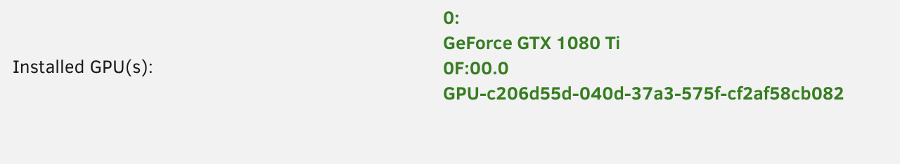

Hi, is there a way to use older drivers?? i got a NVIDIA Corporation GF100GL [Quadro 4000] (rev a3) and it needs driver 390.141 i think.
i'm getting:
Installed GPU(s):Failed to initialize NVML: Unknown Error
Hardware:
ASROCK X570 TAICHI
5950X
1080 TI (used for video passthrough to VM)
1660 Super (used for video passthrough to docker container [plex])
Let me know if you need to know anything else, I don't know unraid well enough to just know what log to grab
Solution: Double check VFIO binding make sure you aren't selecting even part of the card...i had the usb controller selected which stopped the driver from loading.
Please make sure that you are on the latest Motherboard BIOS, check if you got above 4G decoding enabled.
If this all doesn't help try to boot with Legacy or CSM mode.
Please post the Diagnostics here (Tools -> Diagnostics -> Download -> drag the file here in the textbox) if you don't get it to work.

2 hours ago, ich777 said:
This line says that the container autmomatically installs the "old" driver but only because selected I think (I have built in a routine that checks if the container can actually get all releases and fall back to the installed one if it has no access to the internet or even Github.
Please try to select 'latest' in the Plugin, press 'Update' and then restart (you can actually check what version would be installed before rebooting if you do 'cat /boot/config/plugins/nvidia-driver/settings.cfg' in the terminal).
I did select latest, it then asks me to restart which I did twice.
This is what I saw.
I guess I'll try reinstall the app again too... Thanks for your efforts.
