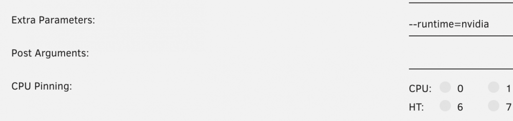

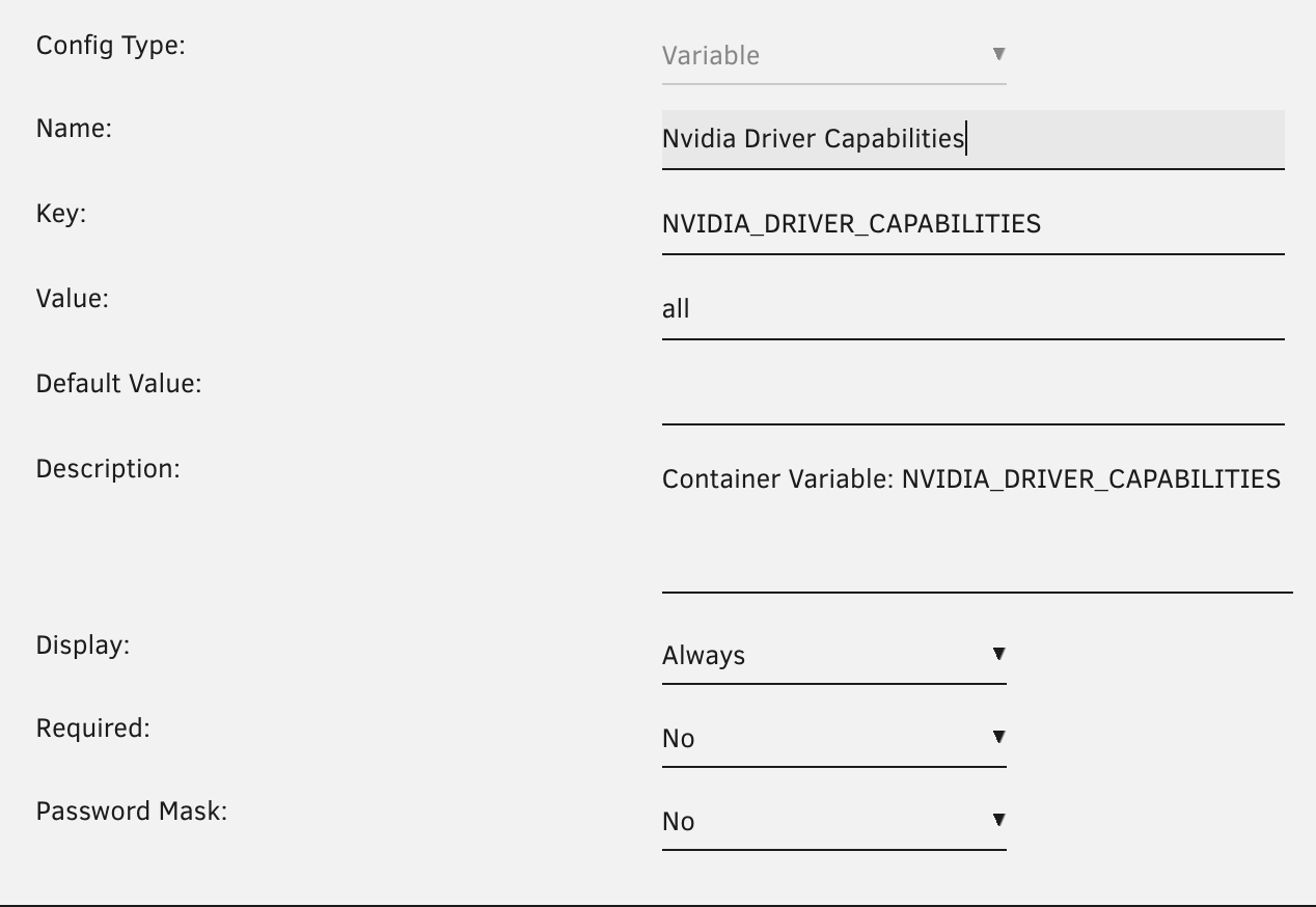

  • To utilize your Nvidia graphics card in your Docker container(s) the basic steps are:   Add '--runtime=nvidia' in your Docker template in 'Extra Parameters' (you have to enable 'Advanced

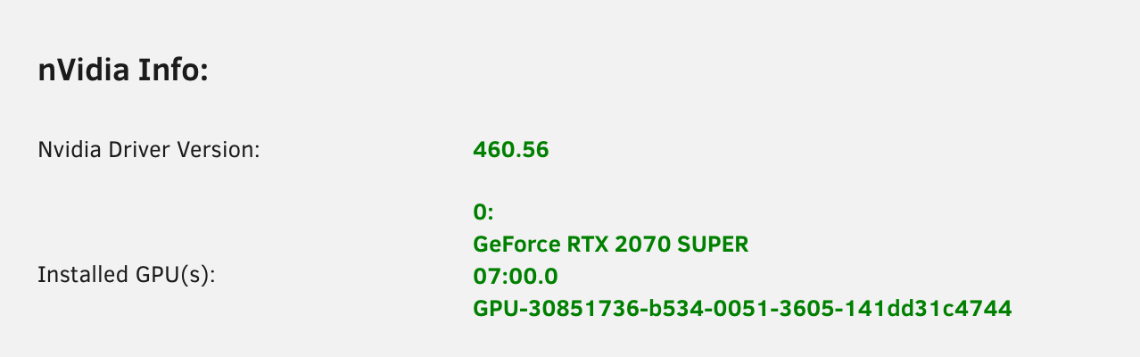

Thabks for looking into this @ich777! I like the idea of the download within the plugin.
I encountered the need to uninstall and reinstall your plugin when upgrading from 6.9 rc2 to 6.9, wasn’t too much of an inconvenience for me once I figured it out.
I also plan on going to full metal pfSense soon, this wasn’t the only thing that becomes a minor annoyance when running it as a vm.

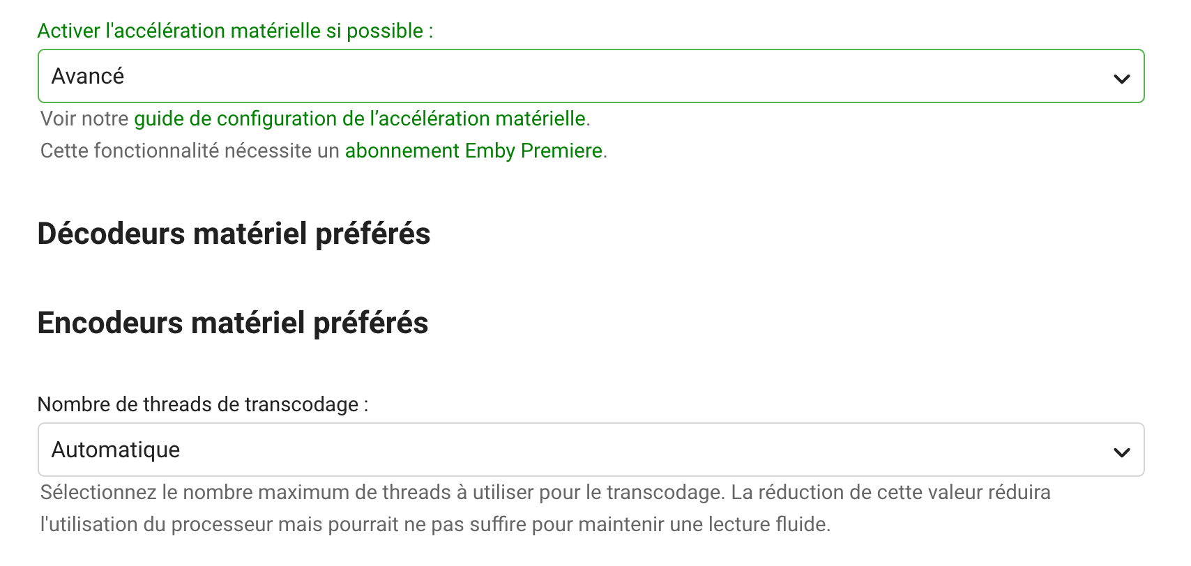

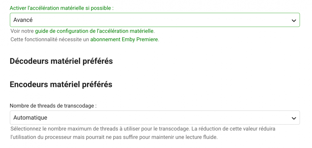

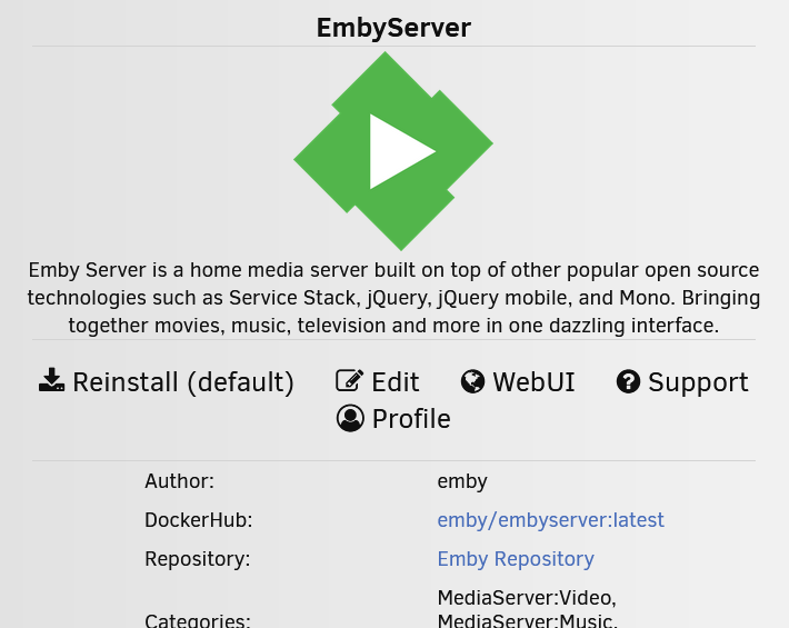

nothing works on my EMBY :( GPU not detected on EMBY
"Binhex-Emby"
I don't know why...
Edited by thymon
"Binhex-Emby"
I don't know why...
Can you try the emby/embyserver build from the official source just for troubleshooting reasons (you find it also in the CA App)?
I have no problem with the above mentioned Container:

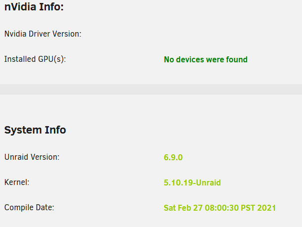

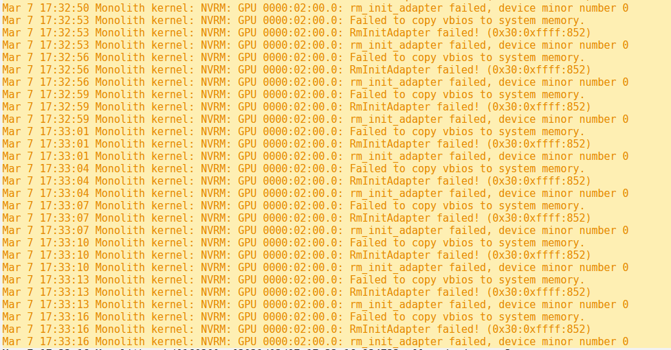

Hi, I'm getting the "No devices were found" error in the plugin and when trying "nvidia-smi" even though it detects my Quadro K4000 in system devices and with "lscpi" in terminal. I'm on stable Unraid 6.9.0 and Nvidia-driver version 2021.03.07. I am using a Gigabyte Z77X-UP4 TH motherboard and have Vt-x and Vt-D enabled in the bios. I tried it with and without the card plugged into a display. I've also tried bios resets, many restarts, re-seating the card, legacy boot mode, checking and unchecking vfio bind as advised by previous posts. I've also confirmed that the card can be detected in a Windows VM. Any advice would be greatly appreciated. Thanks!
Edit: I'm also getting a weird error in the logs RmInitAdapter failed and failed to copy vbios to system memory whenever i tried to run nvidia-smi or open the nvidia-driver settings page, as per the image.
Also the card outputs properly to the external monitor and functions normally in a windows computer.
Edited by quizzy99
Included log
Can you please post your Diagnostics here (Tools -> Diagnostics -> Download -> drag the file here in the textbox).

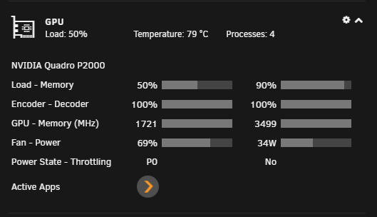

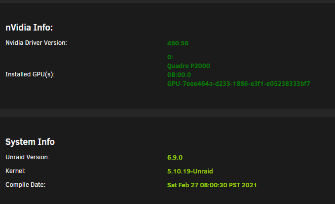

On 3/5/2021 at 7:28 PM, SiRMarlon said:
Just as and FYI on this system.
AMD Ryzen 7 2700x / Asrock B450 ITX / Nvidia Quadro P2000 its been about 24 hours since I installed the card back into the system. I disabled C-States in the BIOS, I am running the card with the SMI instance as mentioned above and the card has not fallen off the bus like it was doing before. I am going to let it run through the weekend and if by Monday it has not fallen off the bus I will go ahead and re-configure PLEX to use the card and put it under load with a transcode to see if still stays stable.
I am on Driver version 460.56
It's been 36hrs and the GPU has been stable and has not fallen off the bus like it was doing before! I've gone ahead and configured Plex hardware transcoding and I have 4 streams going right now. All of them are trancoding 4K HDR to 1080p SDR
As you can see HW transcoding is working. So I have the movies on repeat and I am going to let this run all night hopefully when I wake up the server is still running and has not blown up! 😂
So for those of you who happen to be on AMD Chips and are having issues go into your BIOS and disabled C-States as this seems to be working. But we'll see where I am at tomorrow morning!
Also I do have my Plex transcoding quality set to "MAKE MY CPU HURT"  the server never sees this much workload so this is def making the system work.
Edited by SiRMarlon
I had a similar issues fixed it by doing the following.
- delete the nvidia plugin
- grab fresh unraid kernel
- install plugin and latest driver.
Maybe it helps.
I have not changed any hardware  settings.
Ryzen 3700x, strix b450-f and a gtx 1660

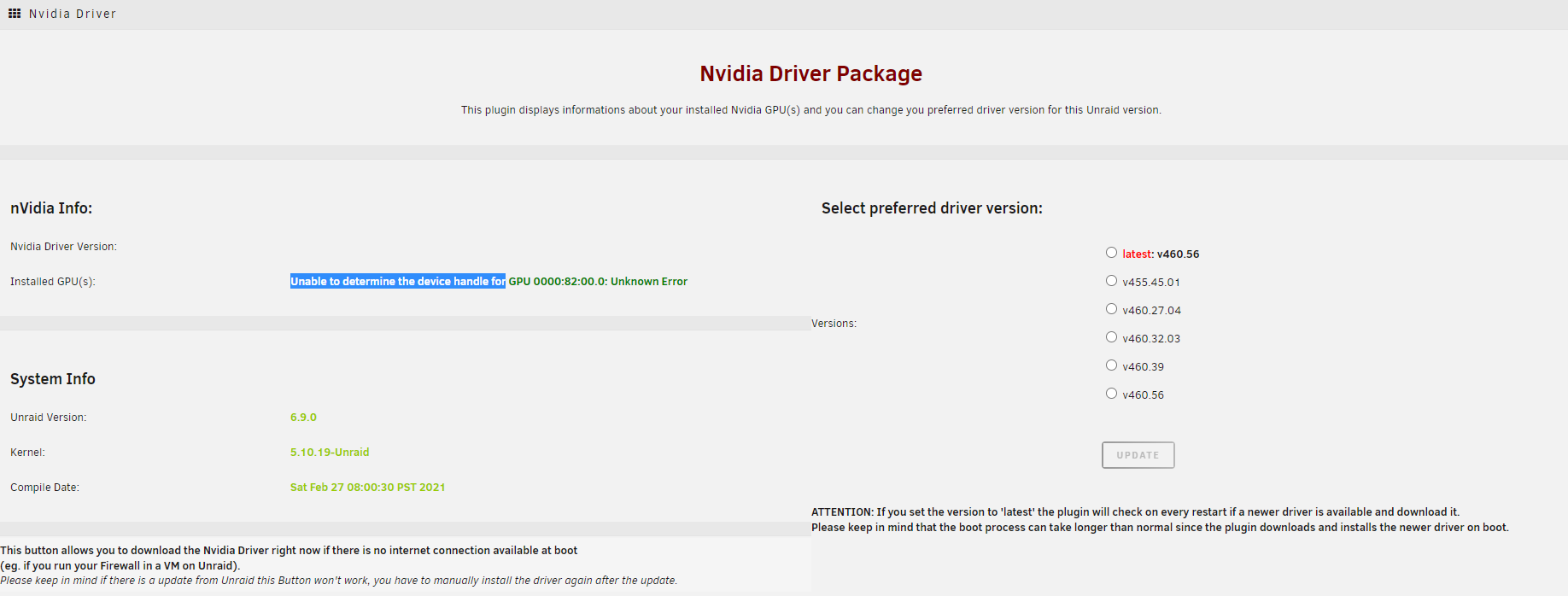

hi all.
i am having  where by the nvidia is not detecting installed GPU.
Unable to determine the device handle for GPU 0000:82:00.0: Unknown Error
i tried "nvidia-smi" but also getting the same error Unable to determine the device handle for GPU 0000:82:00.0: Unknown Error
here is my diagnostic log also
tower-diagnostics-20210308-1703.zip
5 minutes ago, winterkid310 said:
hi all.
In your syslog I see a lot of this messages:
Mar  8 16:41:51 Tower kernel: NVRM: GPU 0000:82:00.0: GPU does not have the necessary power cables connected.
Mar  8 16:41:51 Tower kernel: NVRM: GPU 0000:82:00.0: RmInitAdapter failed! (0x25:0x1c:1262)
Mar  8 16:41:51 Tower kernel: NVRM: GPU 0000:82:00.0: rm_init_adapter failed, device minor number 0
Also is this done by accident in your syslinux.cfg:
BOOT_IMAGE=/bzimage vfio-pci.ids=8086:10bc initrd=/bzroot
I can't even find a device in your system that has the id 8086:10bc
All systems go! No issues to report, the server handled it like a champ, looks like we are good! Thanks for your help!
Edited by SiRMarlon
