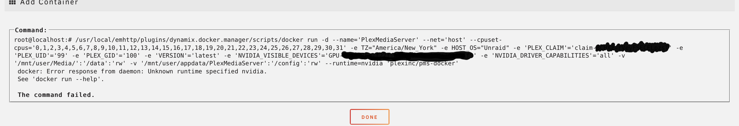

I cannot get this to work in any Plex docker including binhex-Plexpass or the official Plex docker. Ive also tried every other Plex docker as well. Using your recommended variables. I keep getting the following errors when I do it. The attached error is from the official Plex docker.
Screenshot 2021-03-13 at 10.27.36 AM.pdf
check if you don't have any space " " at front and back of the Nvidia Visible Devices ID, this will happen when you did copy the ID
Have you restarted the server or disabled and re-enabled the Docker service like the instructions on the first page and also the red box that appears told you?
I think not because your Docker service told you that the runtime 'nvidia' isn't found and that's exactly the problem when you install the Driver and don't read the instructions or even the red box... :D
