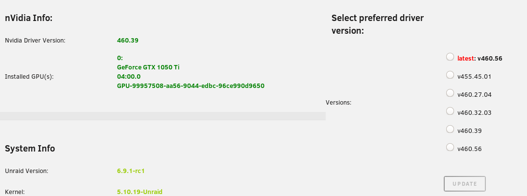

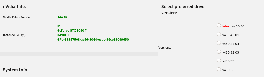

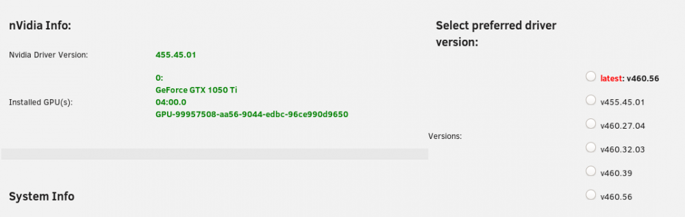

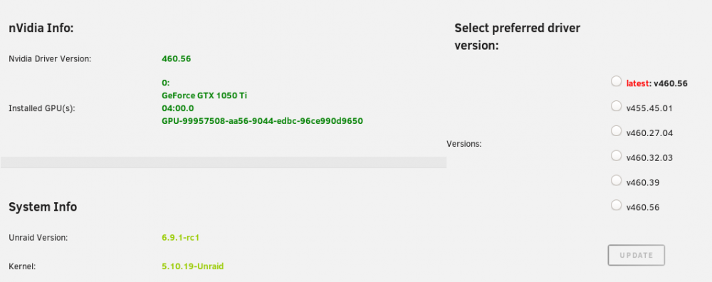

This is the first boot driver 460.56 installed and changed to 455.45.01:
after the reboot it looks like this:

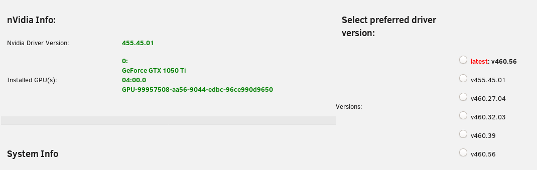

then I tried again to change back to a differnt driver manually 406.39 and after the reboot:

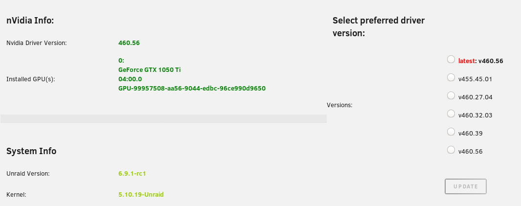

and at the last one I've set it to 'latest' and after the reboot it looks like this:
Also here is the log from the last boot it should look something like this: nvidia.log

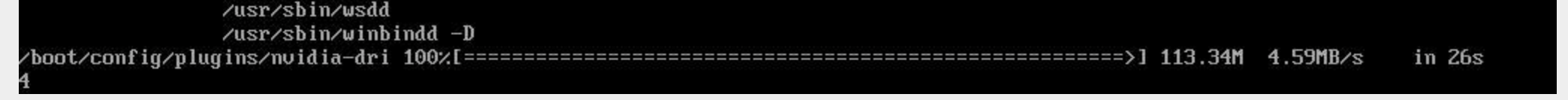

So I rebooted, got back into unraid, im now re-installing the plugin.
Its pulling the latest driver as we speak.
