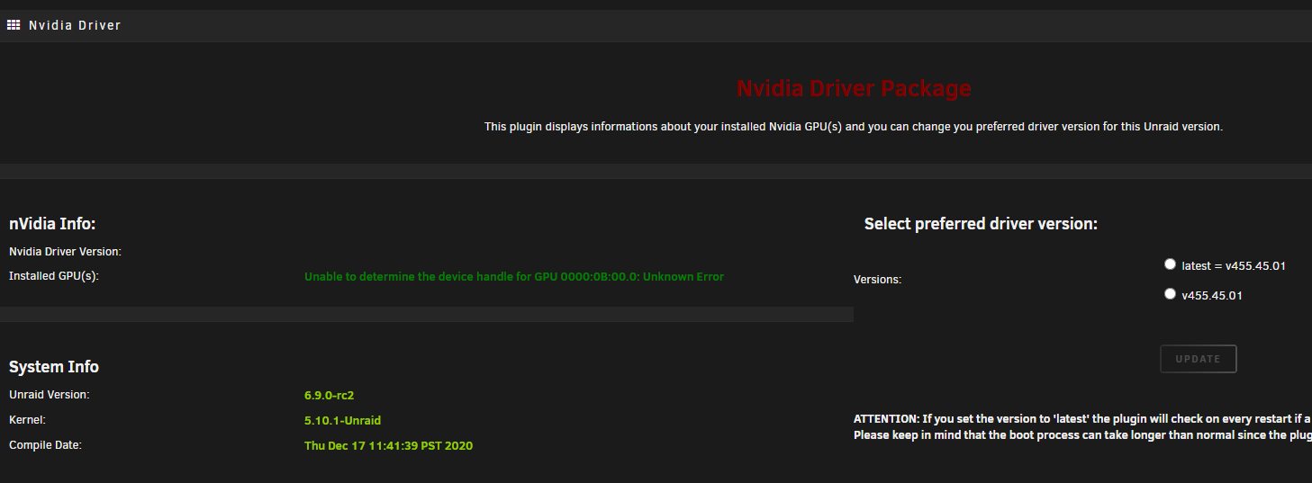

Okay so looks like it ran great for a day and a half as my server just crashed. So I took the opportunity to move the card to another slot and boot the server up legacy instead of UEFI. I've attached the diagnostics that I pulled once the server came back up. Hopefully you can find something in there that may lead to finding out why the card is crashing.
plex-unraid-diagnostics-20210227-2232.zip
I just noticed that the card is not working anymore I've attached the diagnostic logs again. This time the server hasn't hung up. It's still working.
plex-unraid-diagnostics-20210228-1628.zip

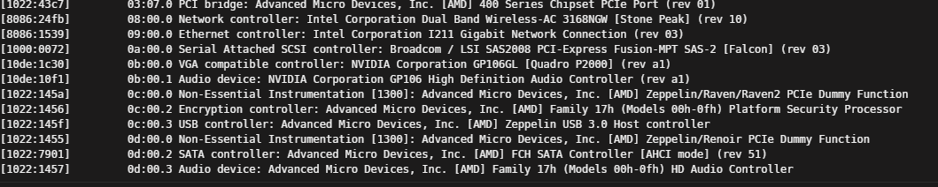

Looking at system devices I can still see the card listed there ...

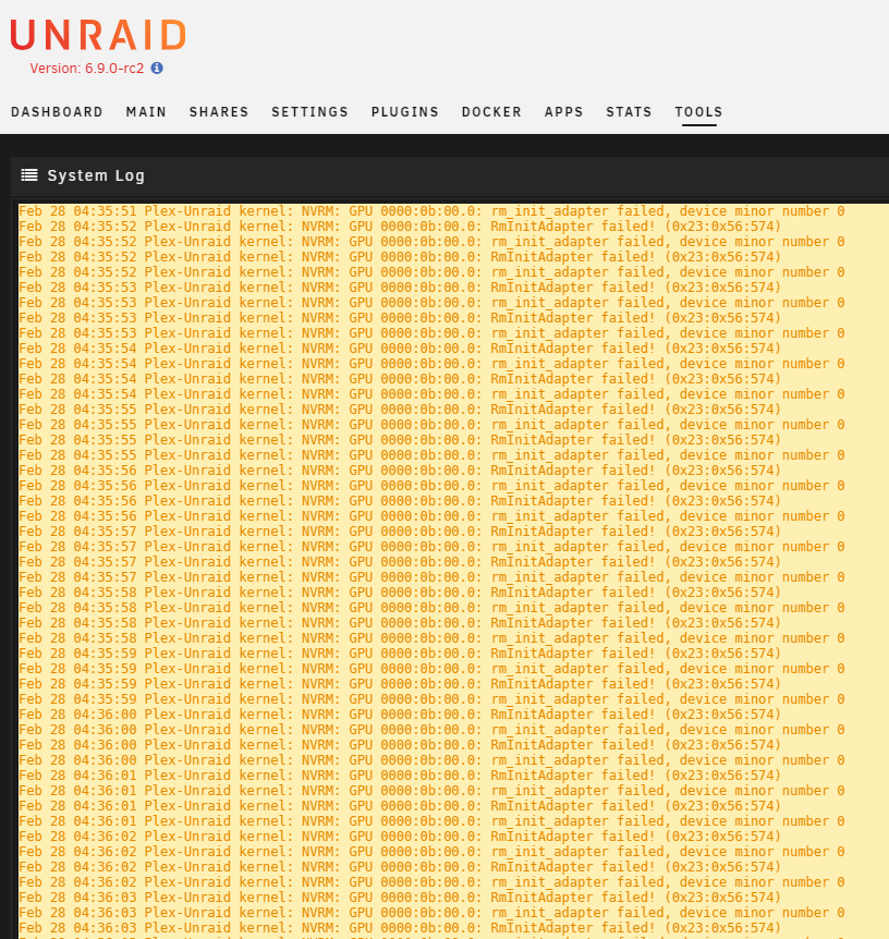

Okay so looking at the system log it's full with nothing but this ...
'Plex-Unraid kernel: NVRM: GPU 0000:0b:00.0: rm_init_adapter failed, device minor number 0'
What have you done now? Have you disconected the monitor from the Card and are you booted with legacy.
May I ask if you are able to pull out the Card from the server and test iton a desktop system?
If you can do that please be sure to install the drivers, the basic display output works always, after that run something like furmark for a few minutes and see if it crashes.
The last way thing I can recommend is to go with a build with the drivers integrated, I think I have one lying around somewhere.
The only difference this time is that I did boot the server in legacy mode and there has been no monitor hooked up to the server. I am just accessing the server via the web browser from my main PC. I know the card doesn't have any issues because this is the same card that I was running on my 6.8.3 server for more then a year with no issues. So for it to fail by just switching it to another system seems highly unlikely to me.
When you say go with another build are you referring to a 6.9.o-rc2 build that has the drivers already in it? So that I won't need to run the NVIDIA plugin?
Edited by SiRMarlon
