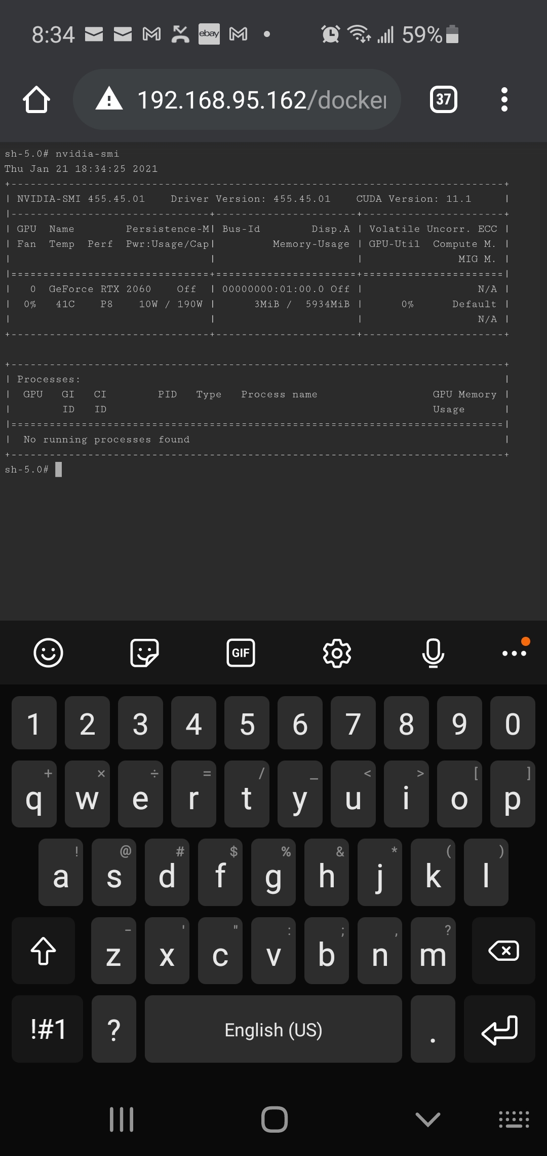

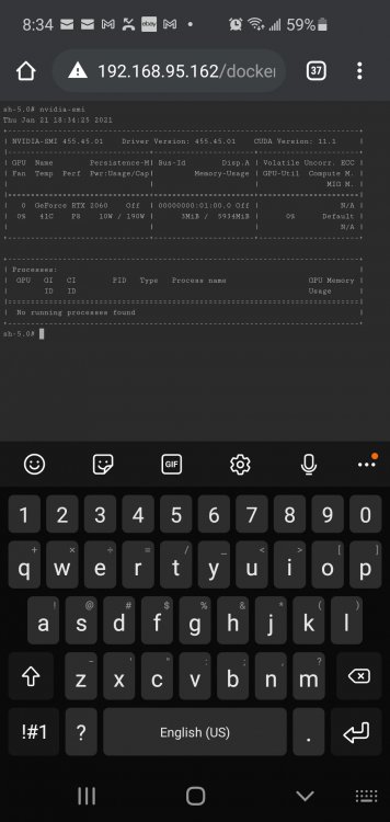

2 hours ago, Spucoly2 said:
This is what I get from inside the docker container terminal.
This seems perfectly fine to me.
Is this the first time you try hw transcoding?

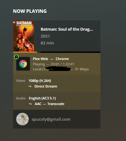

I got it. I had to go on the actual unraid server in GUI mode and sign in to plex with my plex pass account. That is strange as I have never had to do that before.

Or are you running Unraid in GUI mode?
yes it was in GUI mode
Eventually this is the problem, please try to boot the server in console mode and see if you got a output. :)
