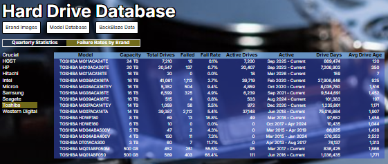

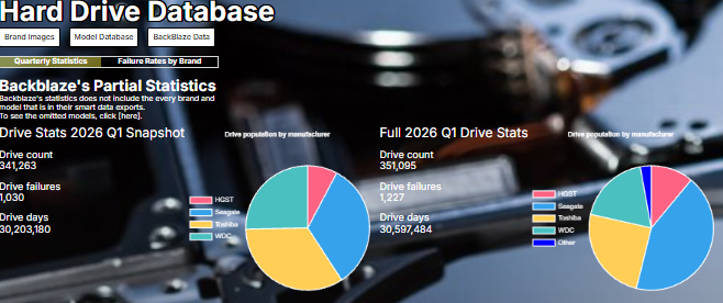

  2. Added the initial Backblaze statistics to the HDDB site. https://strangejourney.net/hddb/BackblazeData.cfm After loading the Backblaze smart data files, I was able to duplicate their results but discovered that they had excluded data from several models which was broken down in a dialog window that you can view for yourself if you click on the "[hear]" link on the site. The right graph shows the same stats including all drives they collected smart data from which appears that they don't exclude any. I've also discovered that it seems some serial numbers have been repeated with newer drives, at least it appears that way with the smart data itself looking like it is from a new drive but using the same serial number as a much older drive. I plan on adding logic to treat the repeated serial numbers as a new drive but haven't done so yet. The "Failure Rate by Brand" tab lists every drive model ever hosted by Backblaze with detailed information. One note about the average age of drives is that it's the difference between the first date the drive was reported on and the date it was removed - it doesn't yet take into consideration if a drive was pulled and then added back at a later date. I only found a few drives impacted but fractions count. I plan on adding a new column representing the average active days. I plan on adding additional charts soon'ish detailing the data on each model showing it's activity and failure trends.

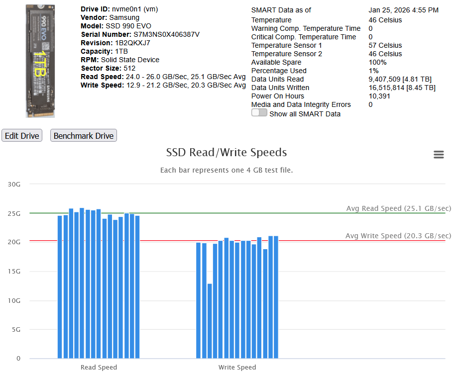

  15. Version 2.10.10: USB & SSD Pool Benchmarking Catch rare error fetching platter info Allow benchmarking of SSD pools Allow benchmarking of USB devices Allow editing of USB devices Correct scaling of left side axis of SSD benchmarks Version 3 is taking awhile due to life stuff so I added into the version 2 branch the ability to benchmark SSD pools and USB devices. On fresh installs or reset, it'll try to identify images for any USB drives. You can now edit the image on existing USB devices. When benchmarking pools, select the first drive in the pool to see the benchmark button. If you click the "Benchmark" button on the home page, you can set the checkbox for the first drive in a pool but not for any other drives in the pool. Benchmark of three Samsung 990 EVO nvme's on the motherboard in a ZFS ZRAID1 pool with the default 4 GB test file size With ZFS pools, try a larger test file to see if it steadies out the benchmark.
