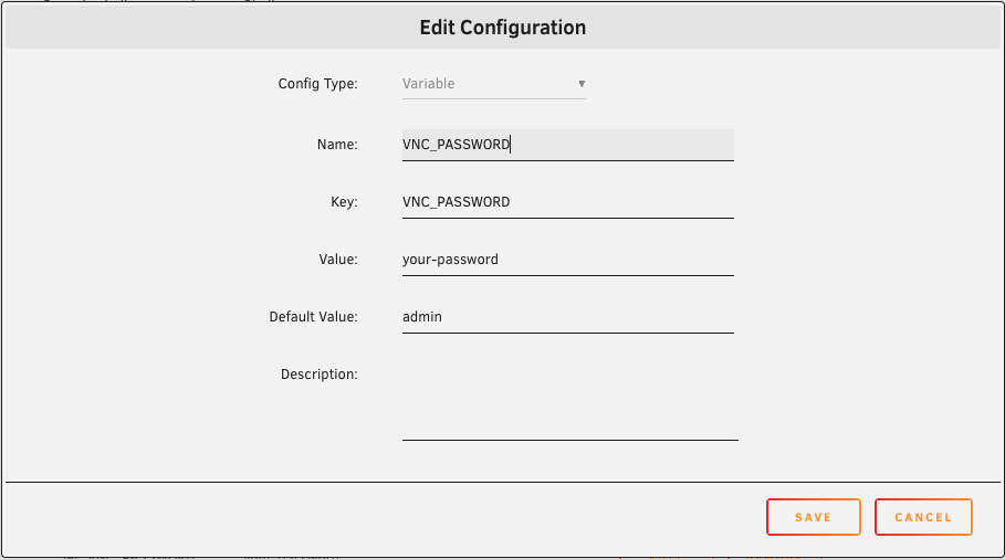

  1. Update, just add a variable to the docker config and you're good to go. Lots of other variable on the github page.
