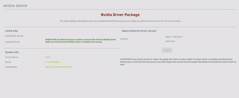

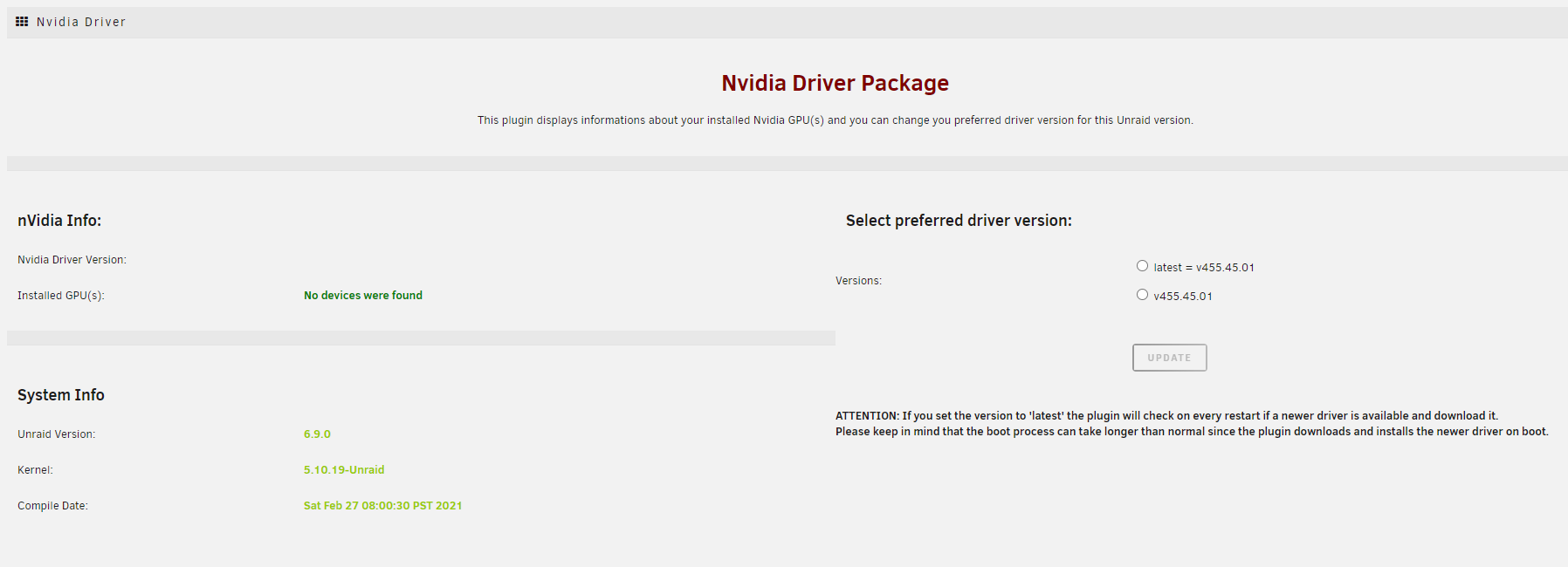

Hey all - congrats on the success so far!
So, I'm wondering where I'm going wrong here - I think everything should be right - but it doesn't seem to be working for me.
I have a Quadro P400 hooked up to my server, but the server doesn't seem to want to show it in the plugin:
The card is unbound:image.png.5b391f395675cf55489e09884adf3f33.png
Finally - I did set the driver version to latest (and restarted)
I really hope I included all the info needed, and more importantly, I hope I didn't miss someone else having the same issue in the thread.
Are you booting with UEFI or Legacy?
Is the Card assigned to a VM?
Can you post your diagnostics here Tools -> Diagnostics -> Download
Honestly - I cannot recall offhand - is there an easy way to tell without restarting?
Couldn't be - no need for VM's yet
tower-diagnostics-20210302-1204.zip

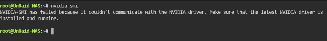

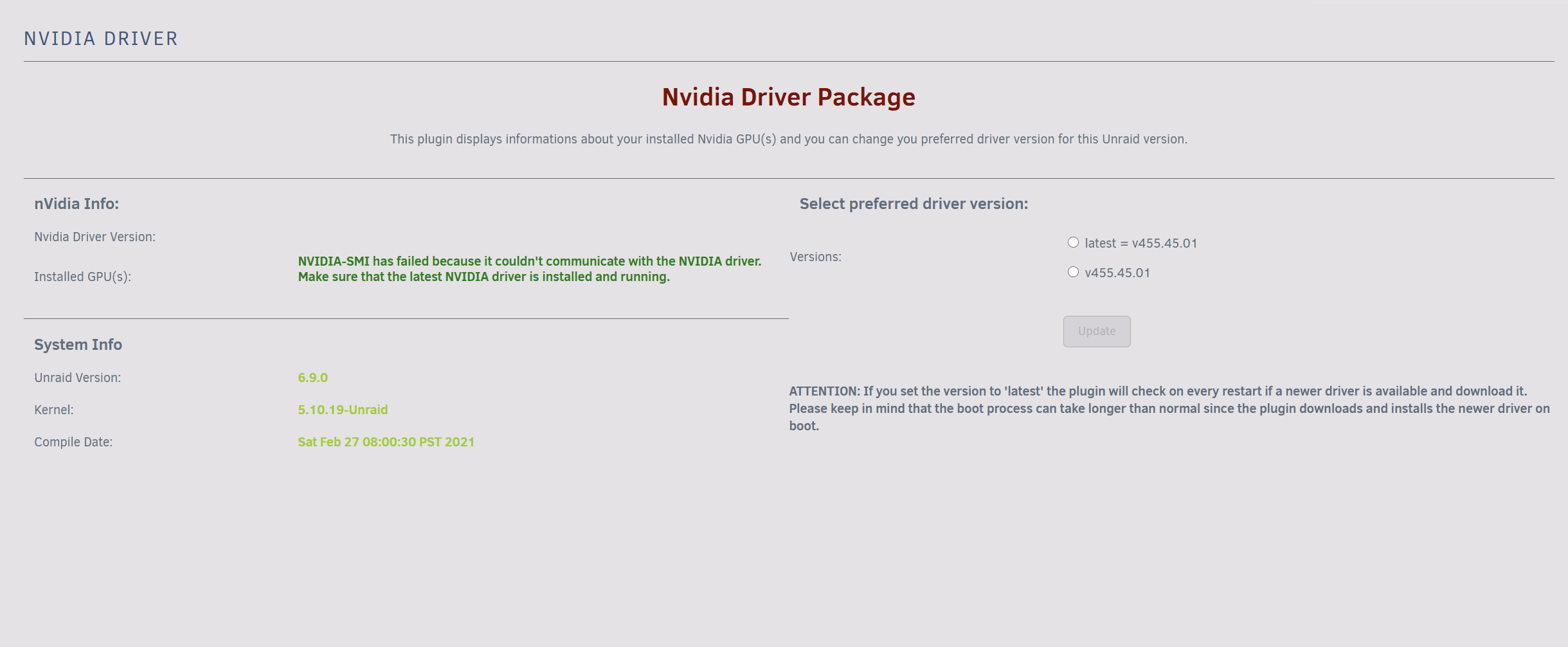

Maybe you are right because the server doesn't want to work with the card today. I was running your version of 6.8.3 with the integrated drivers. I checked this morning when I woke up and the card dropped off the bus again. Kept getting the same error in the sys logs again as in my previous pictures. This time even after I rebooted the system it would drop off within a few minutes. I don't know what gives ...
Maybe it is a hardware issue. My previous setup was an old MSI Mobo with an i7-3770K 32GB RAM using the same LSI controller and the Quadro P2000 on 6.8.3. Now the the card doesn't seem to want to hang out at all. I've disabled all hardware transcoding and removed the NVIDIA settings from the docker container so that it at least works. Guess I am going to have to stick to transcoding from the CPU for now.
Figured I might as well move back up to stable 6.9.0 that was just released. Doing some searching it looks like other people have experienced the issue on Linux systems as well.
What's crazy is that UnRAID sees the card the whole time in system devices ... it never falls off of that.
10de:1c30]0b:00.0 VGA compatible controller: NVIDIA Corporation GP106GL [Quadro P2000] (rev a1)
So yeah I don't know what else to try at this point. I've moved the card between PCI slots, I've tried the card on both 16x and 8x, obviously tried different builds, I am booting in legacy mode ... so who knows. This P2000 is not even a year old.
Please try it in a desktop PC and install the drivers...
Also look at this post please (it was a similar problem like yours):
The P2000 was released 2017 I think.
Eventually it's some kind of hardware combination that won't work. Have you looked also at your C-States in your BIOS? I have something in my head that there where problems with the "older" Ryzen and the C-States.
I bit the bullet and restarted - Legacy
Edited by nicknick923
Main -> click on the blue 'Flash' text -> scroll down and at the bottom you see the 'Server Boot Mode'
Unsure if you saw the reply above - I am running Legacy
