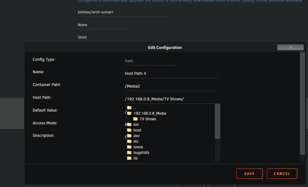

It's currently read/write. I tried 'read/write shared' and got this. Then tried 'read/write slave'. The docker updated OK, but it fails to start. The other share (which is local to that unraid server, so it's not the same I guess) is set to just read/write. But maybe it's not supposed to be the same when it's a share from a separate unraid server. Edit: I should add... maybe this adds an extra level of complication to this setup as well, but the network for this docker, runs through another docker. Like this; Maybe this will be my limitation As I don't really want to change that. Edit2: I can ping it from that Docker tho; hmmmm.

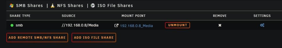

Hi, I'm trying to make an Auto Mount share accessible to my dockers from a 2nd unraid server. It seems to successfully auto mount and I can browse files from the 2nd unraid server on the main unraid server file browser. But when I added the path to my docker, it seems like only the top path is visible, I can't see any of the files inside when I try to use the path in the docker. Any ideas or settings I need to check/double check?

Yep cool. Will do. Without doing it this way. Technically I should be able to use the UNC path directly in the docker right? It's a completely separate server. Even when I set the share to Public, the docker on the main server doesn't see files. I seem to have a similar issue doing it that way too.

Hi, I'm trying to make an Auto Mount share accessible to my dockers from a 2nd unraid server. It seems to successfully auto mount and I can browse files from the 2nd unraid server on the main unraid server file browser. But when I added the path to my docker, it seems like only the top path is visible, I can't see any of the files inside when I try to use the path in the docker. Any ideas?
