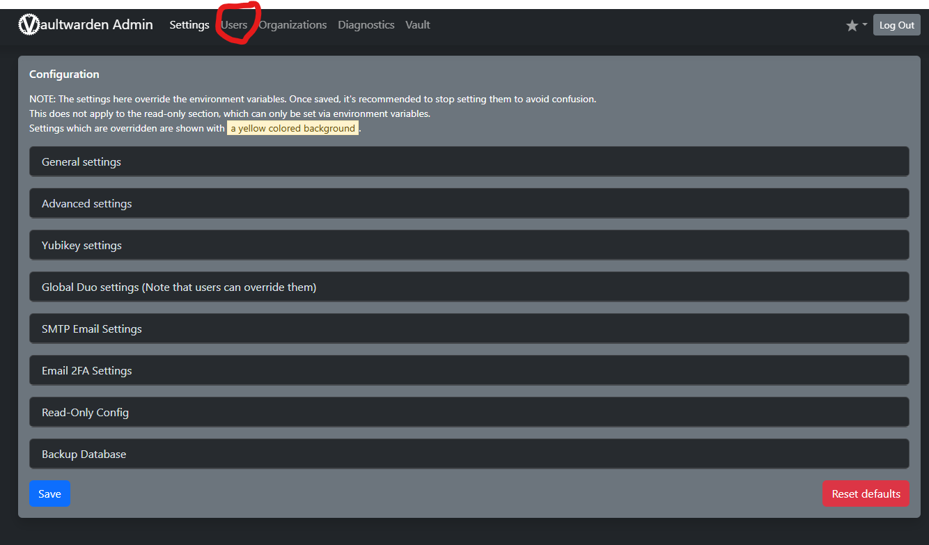

  1. The picture above says he did. Hmm, I'm out of options. Maybe you should change something in the config file.
  2. Maybe a stupid question, but you did test if SMTP Email Settings is actualy working properly?
  3. I can only answer question 2 and 3 since I don't use Swag and I'm not familiar with it. Question 2: you probably didn't configure SMTP Email Settings in the Admin console. Do that and email can be sent to user, the same goes for invitations (but you have to enable that option first >> Allow invitations. Question 3: You just create additional users in the Admin console (see attached picture) with whoom you would like to share passwords within organisation. To be able to invite new users you have to do the same as per question 2, configure SMTP Email Settings and enable Allow invitations.
