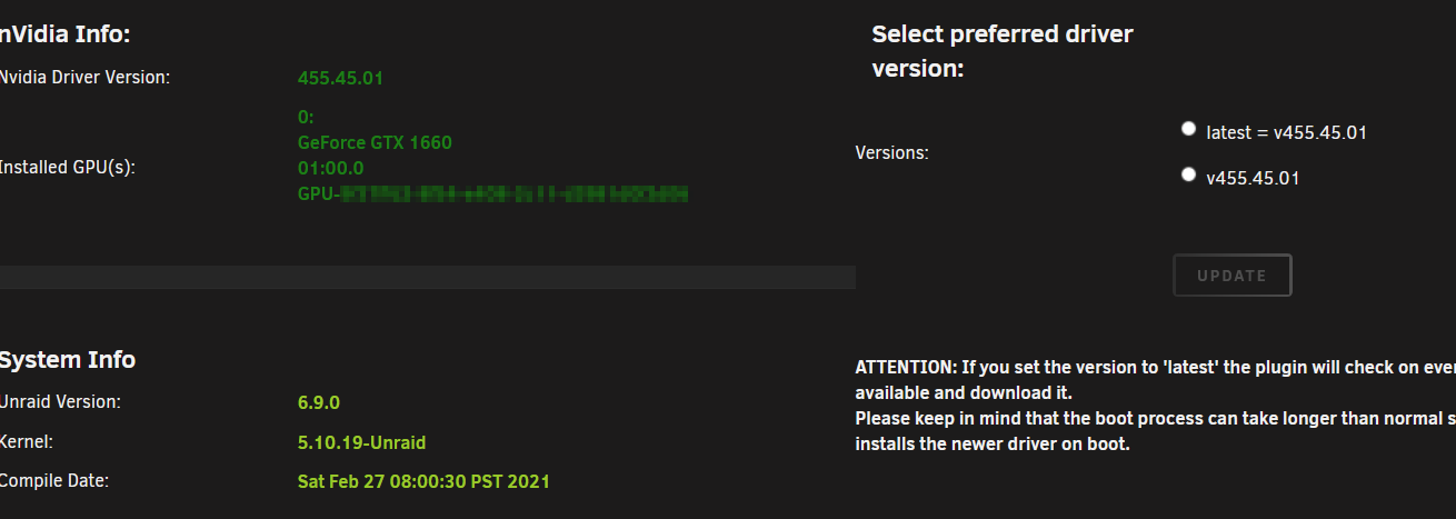

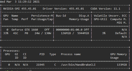

8 hours ago, ich777 said:
Can you give me the output of 'nvidia-smi' also a screenshot from your Nvidia-Driver Plugin and also your Diagnostics Tools -> Diagnostics -> Download and drop it here in the text field.
nvidia-smi (i have plex attempting to transcode but not showing)
nvidia plugin
Edited by repomanz
Please see the first few pages, I think some people got this error too, I think they solved it by reinstalling it or regenerating the token when I remember correctly?
EDIT: But the GPU is working at least for handbrake from what I've see.
