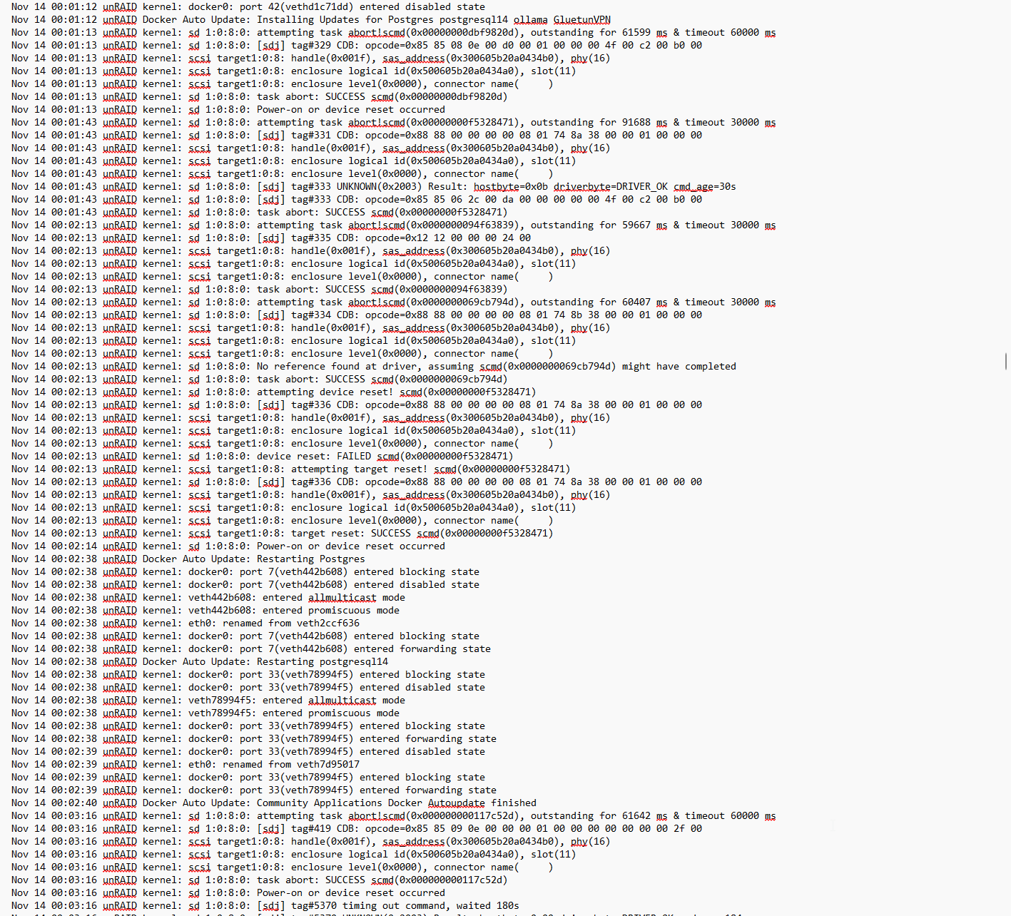

  6. Hello I'm hoping someone smarter can me can point out something obvious I haven't been able to track down. I have 'recently' been trying to get my rig migrated to a new chassis and update some hardware and it has NOT been going well I moved from a Chenbro chassis that had a port multiplier on it's backplanes to a new Hako-Core chassis which utilizes 4-disk backplanes (similar to a Storinator) and I have yet to have the system running in a stable fashion. The current setup is a ASRock Rack ROMED8-2T with a AMD EPYC 7282 I'm utilizing 2x Broadcom branded LSI 9305-24i to wire into the backplanes (System Devices list them as: Serial Attached SCSI controller: Broadcom / LSI SAS3224 PCI-Express Fusion-MPT SAS-3 (rev 01)) All drives are visible in the system, I'm able to start the array without issue Where I begin to see problems is a short time after starting up my docker containers I have 2x Samsung drives in a BTRFS pool for my main cache, this is where my appdata lives After some period of time, usually within 5-10 minutes my syslog begins being bombarded with various errors such as: sd 34:0:15:0: No reference found at driver, assuming scmd(0x000000009270a119) might have completed BTRFS error (device sdah1): error writing primary super block to device 2 There are others but my log did not scroll back far enough, one is related to a "Power-on or device reset occurred" Admittedly, I had a previous forum post regarding this same error, but not the others I have since then replaced both SSD drives that are a part of this cache pool, one at a time, allowing the pool to rebuild in-between I have also replaced the HBA's I was using with new cards from Amazon in the event the original eBay cards were the culprit I have tried moving the drives to different backplanes, which use different SAS cables to different ports on the HBAs The issue persists It seems to be isolated to the SSDs, I do have other SSD pools but they (at least so far) have not gotten enough I/O on them (due to docker containers failing/locking up during these occurrences) I am frankly running out of ideas at this point and I can't keep throwing money at it hoping "maybe this will be the fix" I'm curious if, at this point I could have possibly gotten a bad replacement for one (or more?) of the SSDs despite running preclear testing on the both Also, I'm wondering if in my ignorance if there's something specific with the HBAs that may need to be configured? I've never had an experience where I'd had to do that so I'm not sure where to start. As best I can tell, these cards should be in IT mode as I received them? I'm attaching diagnostics from today's latest foray into trying to make things work If anyone can shed some light on my situation I will be eternally grateful unraid-diagnostics-20250816-1750.zip
  7. Hey All, I'm looking for a sanity check around some issues I've been struggling with. I'm wondering if I've got a dying SSD that is then causing the HBA to re-scan the connected drives. This is pretty speculative at this point but I'm not sure if that could be a valid issue or not. Logs are showing I/O error on SDV (12:0:5:0 if I'm reading this correctly), which is one of the drives in my cache pool and then after some time I see a bunch of "Power-on or device reset occurred" for different devices which look to be on the same HBA I've been chasing this down for a couple weeks, thinking it was an HBA issue but now I managed to catch some more data and I'm hoping someone can finally help me put these issues to rest Diagnostics attached unraid-diagnostics-20250723-2101.zip

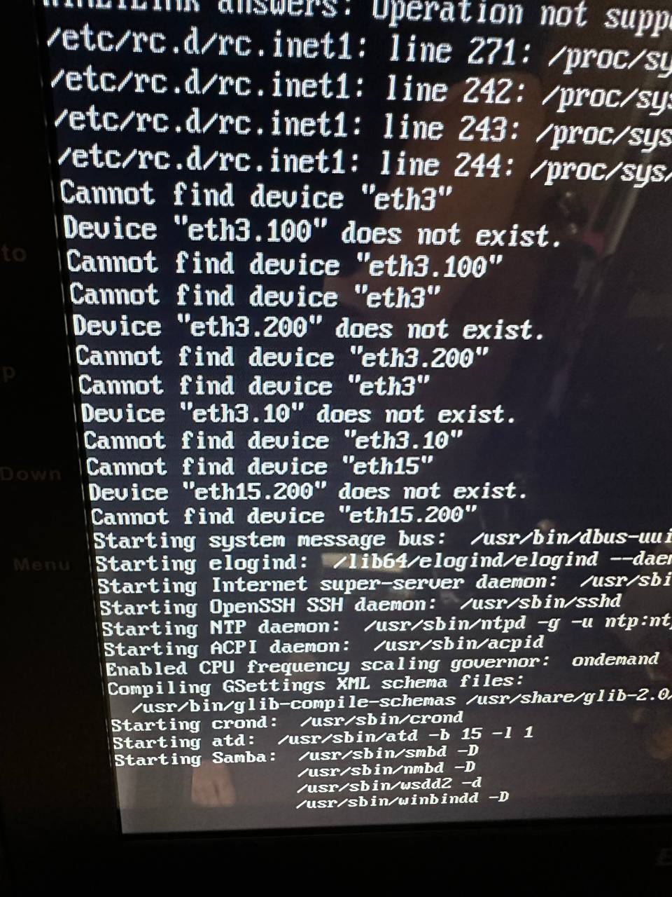

  12. Hey All, I've been trying to track down an issue that's plagued me since updating my system to 6.11 I'm running into instances where my serer is becoming completely locked up and unresponsive Dockers appear to crash as my NGINX ping test is the first to report a problem if I'm not around Web interface, SSH, IPMI console and local console are all a no go. The only way that I've found to recover is by a hard reset. I've turned on syslog mirroring to the flash drive but this appears to be happening in such a way that that's not even writing I've got a few dockers that are running with a eth0 interface and I had previously disabled all but my PiHole instance, following this most recent occurrence I've disabled that one for good measure too Looking to see where I may have something jacked up at. One addition oddity is that I've got some old network interfaces that get listed as "do not exist" during boot I had looked at the network config file but did not find the references there, if that may be causing an issue somewhere? unraid-diagnostics-20221104-1611.zip

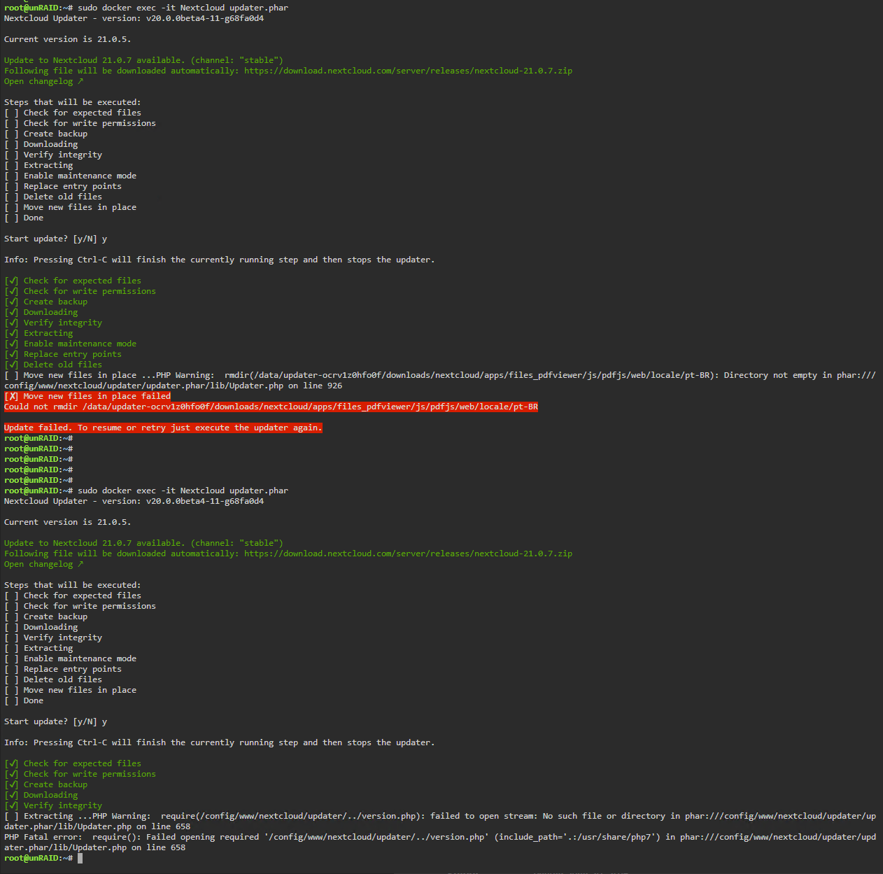

  13. I'm seeing a very similar set of issues as @jafi and @capt.shitface when trying to update from 21.0.5 to 21.0.7 (at this time) and something caught my eye... I'm curious if you're seeing the same thing, if it matters or if I'm going down the wrong path I've noticed that my /data path permissions are not set for 'abc' 'abc' but rather 'nobody' 'users' I was trying to compare with a friend of mine but we're a bit at a loss. I'm not sure if the permissions are screwing me up or if it's just something else I'm not catching For reference; I first tried running the update via the gui but it failed for... honestly I cannot remember but it was on the step for "Move new files in place" I've tried subsequently to run updater.phar and am running into similar difficulties Part of me is curious if it's permissions based but I'm not certain If anyone can assist or point me in a different direction it'd be appreciated

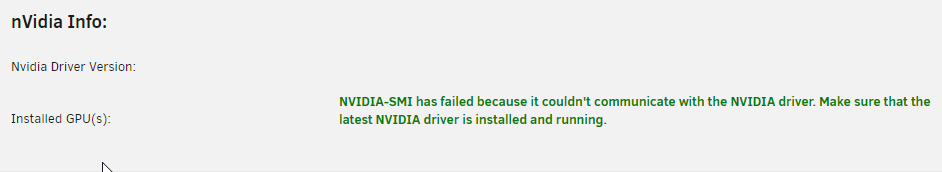

  14. @ich777 thanks for the response I am currently running in Legacy mode, not UEFI I checked the BIOS but (unless I'm seriously not digging hard enough) couldn't find anything related to BAR support
