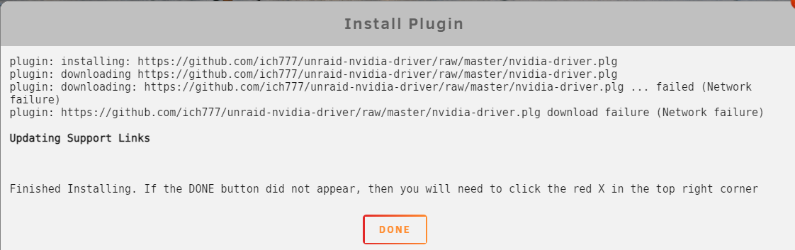

Hi @ich777,
After all the help to get stuff setup on 6.8.3 (thanks again), I updated to 6.9 stable and ran into an issue (I'm very sorry).  I removed all the extra parameters/variables from the Plex container after upgrading and started to follow the directions in the first post.  However, I ran into this error trying to install the NVIDIA driver:
I just assumed something was wrong with my system, so I tried these things:
- pinged the server (success)
- removed the previous unraid-kernal helper plugin (success) and tried redownloading the NVIDIA drivers (failure)
- tried to install manually via the plugin page/link (failure)
- downloaded another docker - your unraid kernel helper (success)
- streaming via Plex both on and off the network (success)
I'm not quite sure why it won't download, but I'm just wondering if maybe I missed turning off a setting or something.  Diagnostics are attached in case they're needed.
Thanks very much!
Can you connect to Github?
This seems like a network related problem since even Plugin the fails to download, have you got PiHole running somewhere in your network, if so eventually try to disable it.
@Squid do you know that message on a Plugin installation? Never saw that before.
Hooooly crap, you're right!  I added github.com to the whitelist, but that didn't make any difference, so I just disabled pihole and github loaded right up.  WOW, that didn't even cross my mind.
I disabled it and installed the plugin.  Thanks so much for the answer AND the quick turnaround - it's most appreciated!
