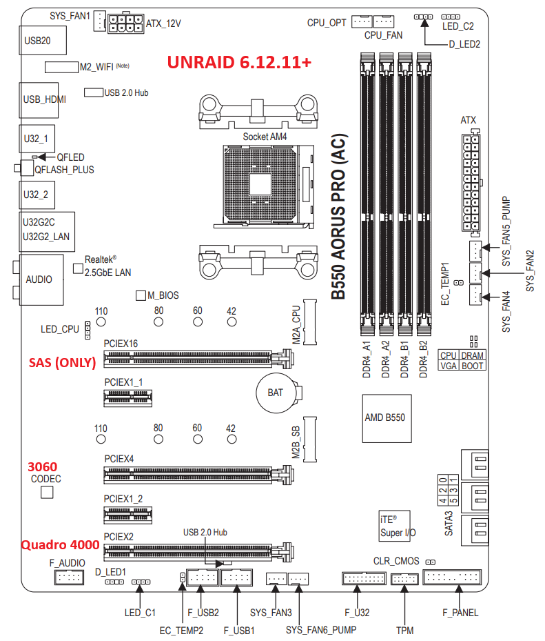

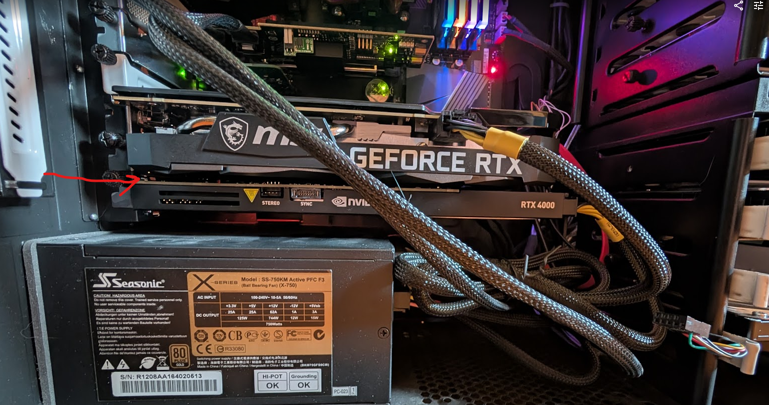

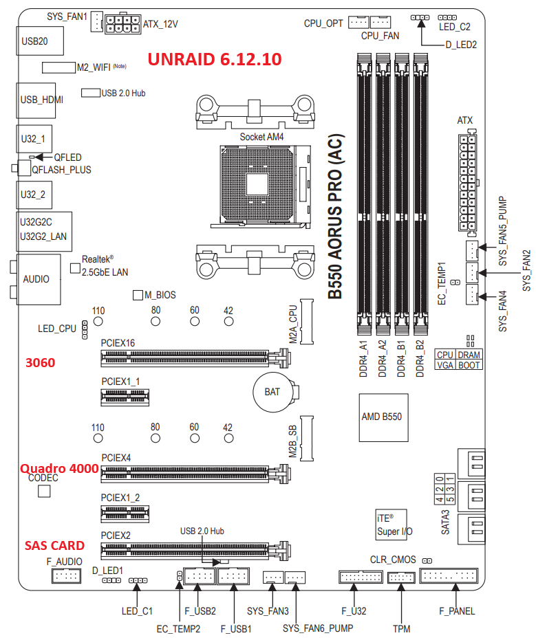

  5. Well, I finally had some time to try to diagnose this issue (a year later!). I've upgraded the BIOS to the latest version to see if that would help things. It seems like it hasn't made a difference. Attached are maps of my MOBO with the config pre- and post-upgrade beyond 6.12.10. On 6.12.10, everything worked well with these devices in these slots: 3060 (x16), Quadro 4000 (x4), and SAS (x2). However, after the OS upgrade the SAS card will ONLY work in the x16 slot. Rearranging things made space a little tight (the 3060 is RIGHT up against the Quadro 4000 (please see attached image), and I lost the front USB ports as the 4000 can't fit with the cable in place), which is the only thing making me a bit nervous. Diagnostics are attached (if desired) radagast-diagnostics-20260221-1155.zip My questions are: 1. What changed with UNRAID after 6.12.10 to force this? Is it something that I can change or is this the only path forward with all these parameters? Certainly willing to live with this, if needed, but -> The amount of space between the 3060 and 4000 seems WAY too close to me - is this potentially dangerous? Thanks very much for your time! Jeff
  6. Thanks so much for this - you saved my bacon! In case anyone with the same issue as me sees this: I was upgrading my AORUS B550 Pro BIOS (to try to get unraid 7 to work) and it refused to boot from the flash drive. Removing the " - " allowed it to boot properly. Really appreciate it - thanks!

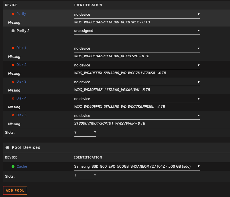

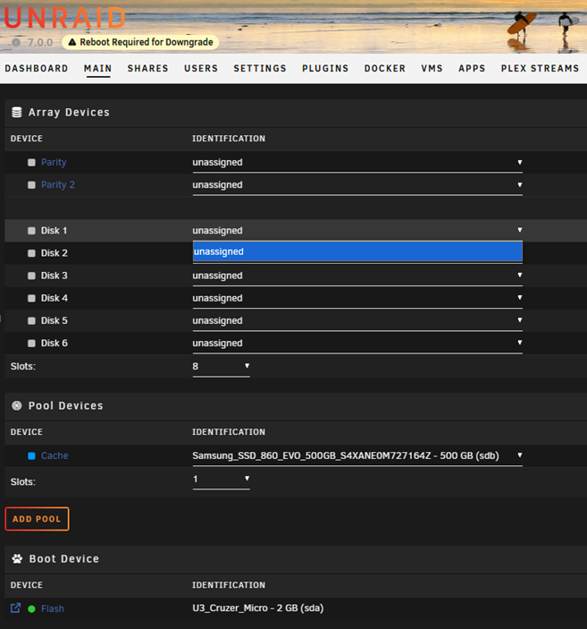

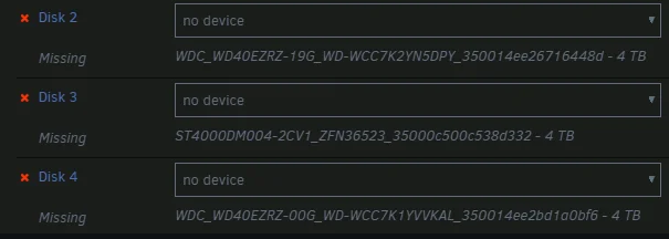

  10. Hi Everyone, After attempting the upgrade from 6.12.10 -> 7.0.0, all the hard disks in my array went missing. I'm sorry, I didn't grab a screen shot of my personal config, but it looked just like this: I attempted to set a new config, but the only device that was found was my cache drive (which is plugged directly into the MB). Based on the cache being available, I'm guessing my SAS card might have something to do with it. I thought I'd downloaded the diagnostics while in 7.0.0, but it seems not to have saved - so sorry about that! I've already rolled back to 6.12.10 and things are working just fine again, but I'd be glad to try again, if you want the diagnostics. Also, this happened before when trying to upgrade from 6.12.10 -> 6.12.13, but I just dismissed it as a fluke and figured it would be worked out before another update. Anyone else have this issue or happen to know what's up? Thanks very much!

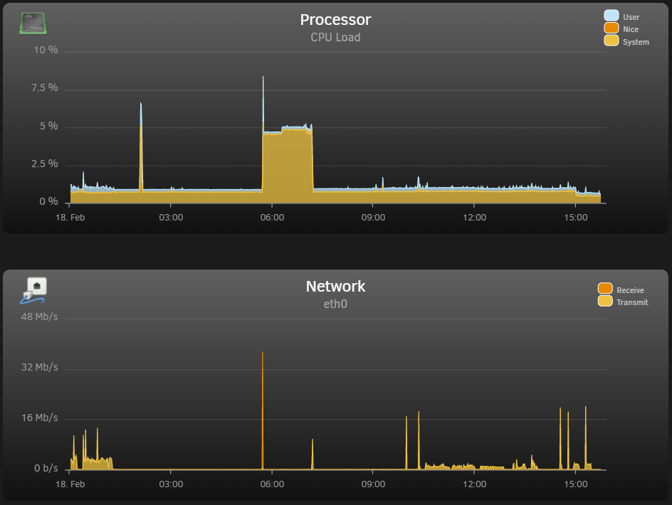

  13. I don't think the fan speed was higher, but honestly can't remember. If it happens again, I'll make sure to take a look to compare. I didn't know that about the docker page, but I do have (and have had preivously) kept it in basic view - thanks for the info! I'll keep my eye on CPU usage when I go to the dashboard page, but I don't think I'll be visiting as frequently until it's resolved. Thanks again!
  14. Thanks for the link! Apologies - I didn't mean for you to have to Google something for me; just thought it might have been a prominent issue or something. I was looking into persistence mode and found this - it seems like pulling the GPU out of P8 (deep sleep) may invoke some RAM usage. However, does forcing it out of deep sleep cause any extra 'wear' on the card? Maybe just increases the likelihood of fan failure? Sorry, these aren't direct questions (unless you know the answer, haha), so I'll keep digging. Maybe this is related to the CPU load increasing? While googling that error, I came across someone in a previous thread mentioning something very similar to what I was seeing with the CPU issue. They seemed to think it was related to @b3rs3rk's plug-in, but there's no direct proof of that. Sorry - bad phrasing. I just meant that the CPU load increased to 4-7% and stayed there for no apparent reason until I started/stopped the Plex stream; everything else behaved normally (GUI/system was fully responsive, though I didn't do any sort of testing for all functionality). All that to say, I haven't seen this happen again, so maybe it was just a fluke? Edit - and I'm not seeing any other problems; sorry, forgot to answer
