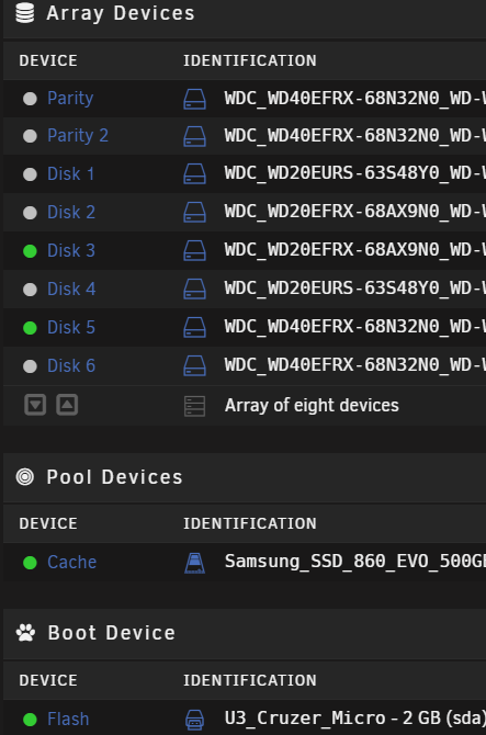

Based on SpaceInvaderOne's latest video regarding properly set up shares, I'm looking to upgrade my current configuration to keep media shares confined to one disk (if possible).  In that vein, I picked up 3 WD Easystore 8TB drives that are currently preclearing.  Here's my current configuration:
What I'm hoping to do:
Total number of disks stays the same; array size increases by 4TB.
New Config
Parity: WD 8TB
Parity 2: Removed
Disk 1: WD 8TB
Disk 2: Same
Disk 3: Same
Disk 4: WD 8TB
Disk 5: Same
Disk 6: Same
Disk 7: Previous 4TB parity disk
I saw the wiki articles about array shrinking and reducing parity drives but wasn't sure if there was a best practice for doing both at the same time.
Here's my plan to (hopefully) keep everything safe, as well as minimizing things like parity checks:
1. Move data (using unBalance) from the 2 drives I plan to remove onto the other 4 data drives (exclude them from all shares)
2. Run new config utility
3. Remove extraneous drives
4. Run a parity check
5. Remove parity 1x 4TB drive 2 (ensure parity is still valid)
6. Replace 1x 4TB parity with 1x 8TB parity
7. Add 2x 8TB drives and re-designate old 1x 4TB as a data disk for the array
8. Move data (using unBalance)
*9. Final parity check
Does that seem like a reasonable order of operations?  How do you guys feel about dropping from 2 parity disks to 1?  Please feel free to poke holes if I missed something or I'm being dumb.
Thanks so much!

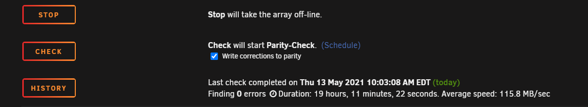

I think step 1 is complete.  I let parity rebuild on the 8TB and it just finished, but I just wanted to double check:
- after parity is rebuilt, are you saying to run another parity check? OR did you mean the data rebuild includes a correcting check?
Here's my homepage:
Which to me, looks like a correcting check was done during the rebuild.  If that's NOT the case, then I'll run another parity check before moving on to step 2.
Sorry for the billion questions and thanks in advance!
Rebuilding parity writes every sector so at this point it should be correct (it is not a correcting check - but a rebuild).   You can (optionally) now run a non-correcting check to ensure the rebuild was correct and I would expect 0 errors (a non-zero value would mean you have some issue that is probably hardware related).
Ah gotcha - wasn't sure if there was some distinction I was missing somewhere; thanks!
Better safe than sorry!  Started a non-correcting check and will look for any sync errors.  If there are, I'll report back (guessing that's a hard drive issue?); if not, on to step 2!
Thanks again!

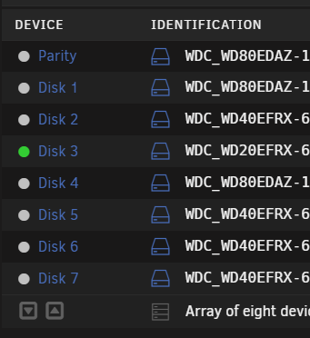

Just wanted to update: all steps are complete, parity AND resources were available consistently (other than downtime for physically replacing HDDs).
Waaaaay simpler and easier than I was expecting it to be.  Thanks so much @jonathanm and @itimpi for all the help - it's definitely most appreciated!
