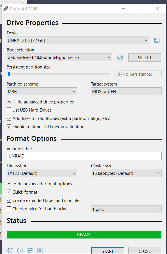

SOLUTION!  Well, a workaround at least.
I took the Debian live USB that was created using Rufus' "Add fixes for old BIOSes" option, and just replaced the Debian files with the Unraid files using a plain old Windows file explorer.  Honestly I'm a bit surprised that worked because it really felt like I was putting together puzzle pieces that were not designed to fit together.
Here's the recap:
  • Download a Debian live ISO file: start with debian.org/CD/live, and then choose your preferred download source, architecture, and flavor, then download the corresponding .iso file.  (In my case it was "debian-live-11.2.0-amd64-xfce.iso".)
  • Use Rufus to turn the downloaded Debian live .iso into a bootable USB.  Make sure to check the box "Add fixes for old BIOSes", which does some magic to make the USB bootable for my old machine.
  • Download the Unraid manual install files: go to unraid.net/download and scroll down to find the .zip file for the version of your liking.
  • Delete all the files on the Debian live USB and replace them with the unzipped contents of Unraid's manual install files.  There is no need to run the "make_bootable" script.
  • Remember to rename the USB to "UNRAID".

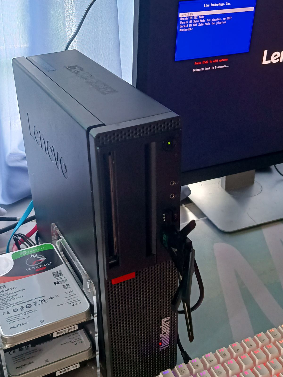

Longtime sleeper for about ~15years
Have a 10y.o. lenovo workstation, decided to start just now.
My humble initial set-up 2x16iron wolfimage.thumb.png.6c8fbb66f2508f183004e3763cf1ef85.png
Edited by USBGEN3_IGT_SATA
Well am trying this right now.   I changed to a new MB/CPU/RAM on a AX370 gaming 5 MB.
The MB even manually picking to boot off the UEFI USB screen goes blank then back to Bios without a reboot.
The other difference is I put my HBA card back in, windows sees all 8 Disks on the HBA card.
Wasn't sure about the "Enable runtime media validation" checkbox?
Edit: that didn't work, not checking the "Enable UEFI" checkbox the 2nd time to see what happens.
