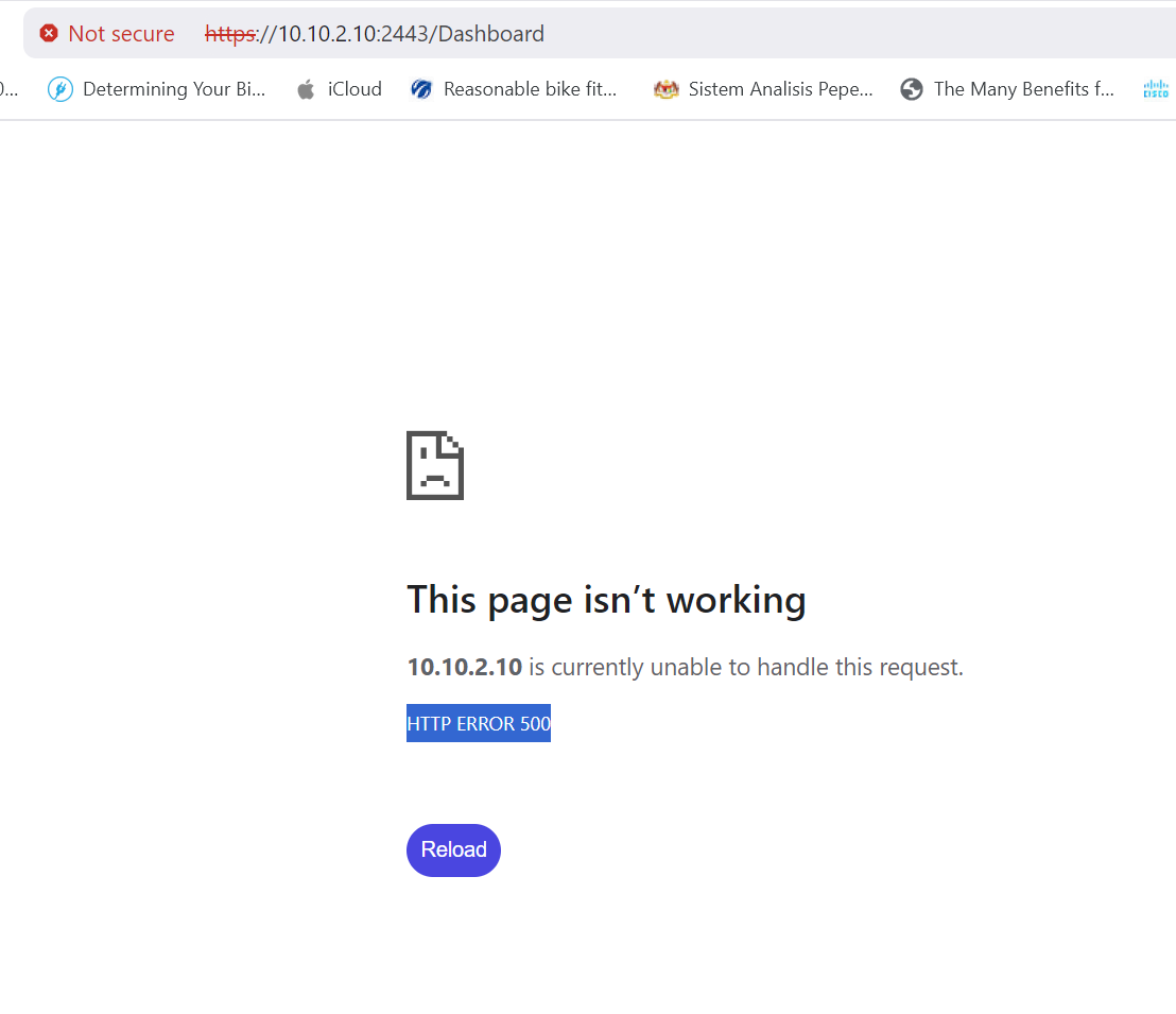

Page not working HTTP ERROR 500
Oooh. any idea which plugin? because i dont have much plugin install.

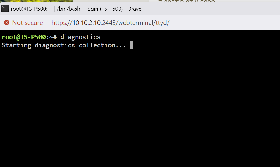

The diags are during the problem occur i ssh into the system and run the diagnostics command.
Hi this two day i encounter this issue suddenly i cant login after the server are up for a while and i need to SSH into the server and do a reboot and everything are working again. Attach are the diagnostic file and hope that the issue is been log. ts-p500-diagnostics-20260115-1531.zip
