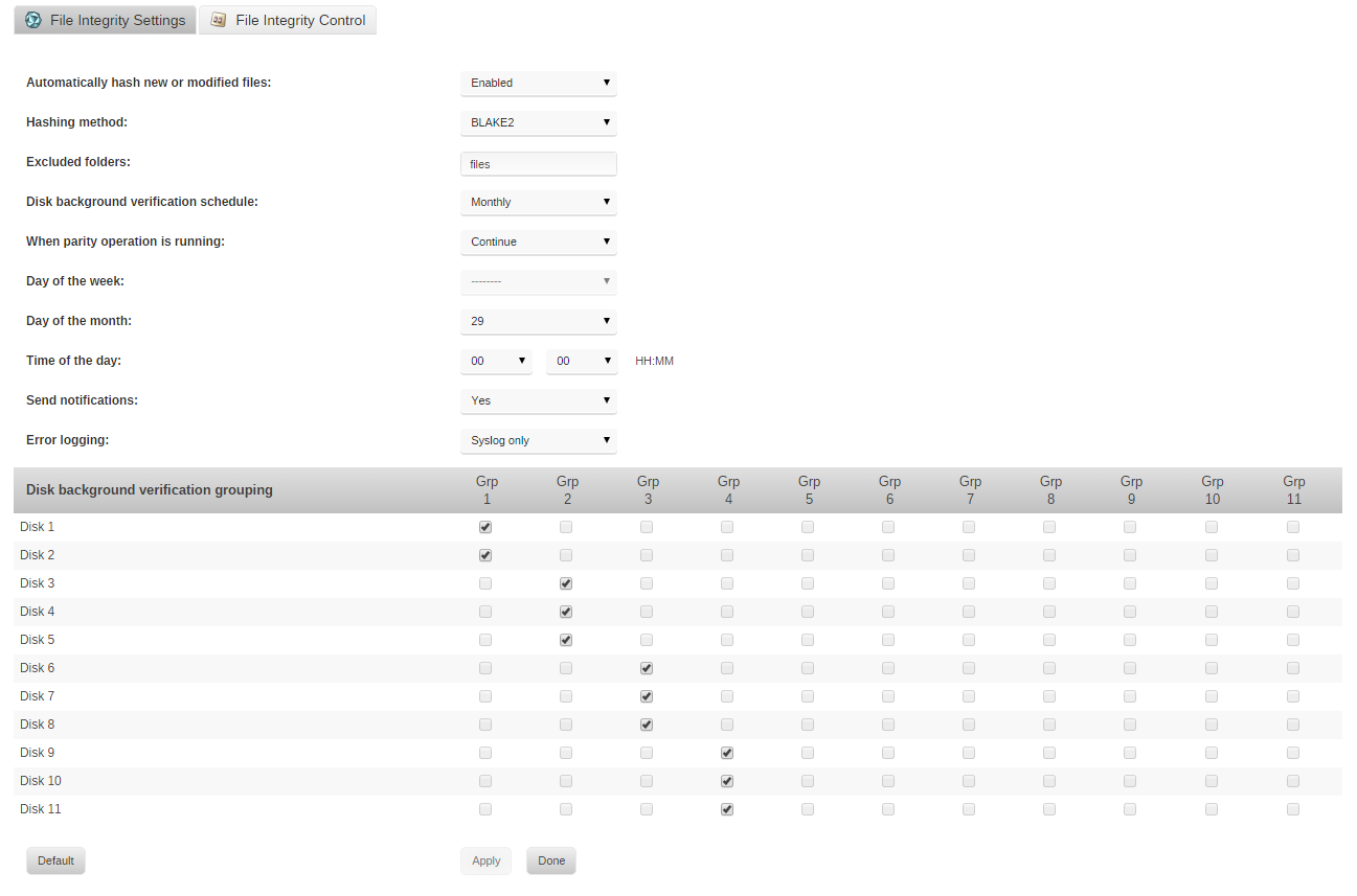

The settings page specifies how automatic file hashing and verification is done. These are processes which - once started - will keep running in the background and notify the user when a silent file corruption is detected.
For the automation of the hashing of new and modified files, the program inotifywait is used, this is part of the inotify-tools package which is installed together with the plugin as needed (it is not present on unRAID by default unless the NerdPack package is installed). It is possible to exclude both disks and folders (shares) from the hashing system.
The verification process is based on cron entries. The user can define groups of disks which are verified at the given schedule. For example if a weekly schedule is chosen then every other group is verified the following week. With setting up groups it is possible to do all in once or spread out the load over several windows. This is done because the disk verification processes are started in parallel, the bigger a group the more horse power is required from your processor.

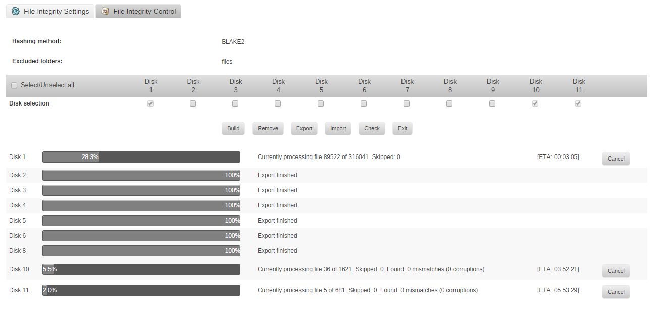

The control page is used for general operations. Here it is possible to select the disks and choose from the commands: build, remove, export, import, check.
An initial build needs to be done to have a checksum value added to the existing files. Building the checksums can be done either in a single go (when all disks are selected), or with intermediate steps (each time another disk(s) is selected.
Once the initial build is complete it is possible to export the checksum values to a text file (normal operation is that a checksum value is linked to a file directly using its extended attributes).
With the export files present (they are stored on flash), it is possible to import then back into the extended attributes or do a manual check to find file corruption.
Once an operation is started its progress is shown in real-time, and includes an ETA for those operations which tend to take a long time.
There is no need to stay at the same page or keep the browser open all the time. Whenever the control page is revisited from the same browser, it will update itself to the latest state.
Attached the settings and control screens to give an indication of what it looks like
