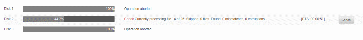

One small request: Would it be possible to show what action is currently underway above the progress bar?
I have a relatively underpowered CPU so I set a task in motion and then check back over the day and I am likely to forget exactly what is running.
Attached is a crude representation of what I am suggesting!!
Many Thanks,
The Capt.
EDIT: attachment updated to slightly improve representation of idea. (If single or multiple discs active, show what tasks are running)

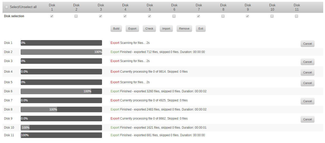

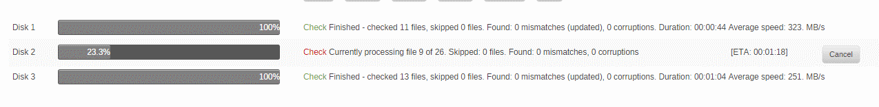

Have a look at version 2016.01.05a, see attached picture.
Active operations are in red, while finished operations turn green.

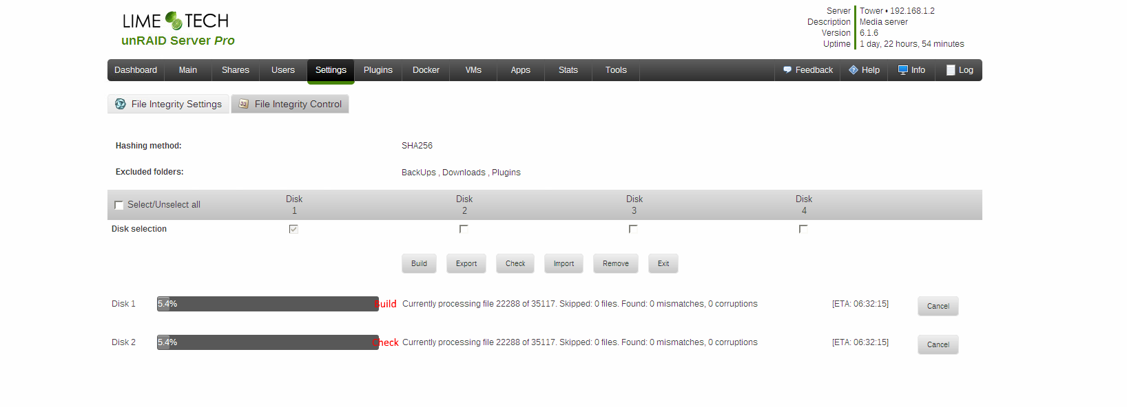

Small issue but I believe should be an easy fix, if when doing multiple checks or builds you change WebGUI page to e.g. main, and some disks had finished, when you go back to plugin page finished disks appear as aborted, see screens for better example, latest version 2016.01.05a used.

I believe this is related to the bug I just fixed, you may want to retry with version 2016.01.05b.
