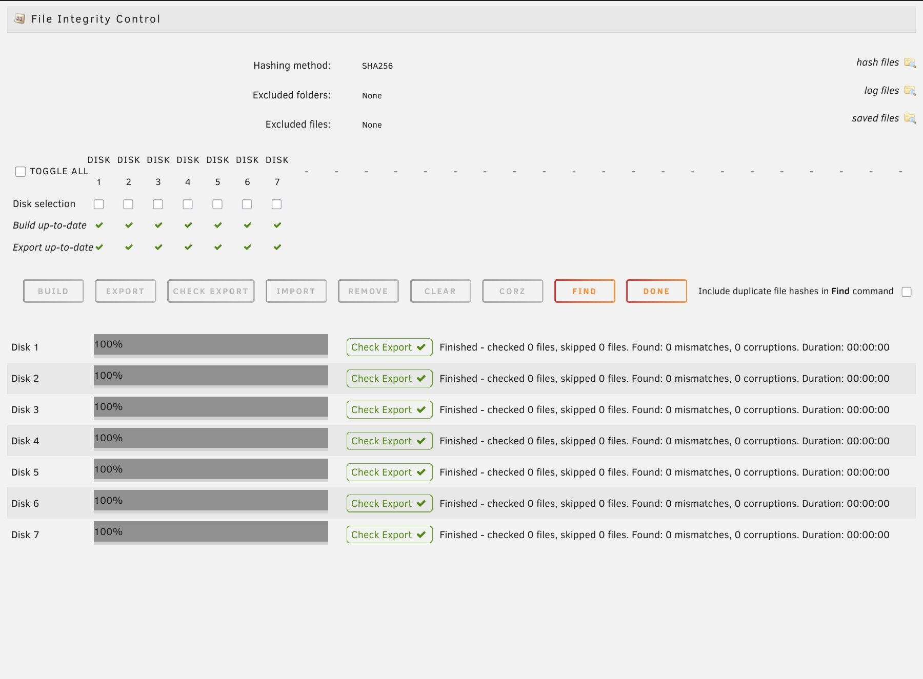

The build and export seem to go ok but the export check gives an instantaneous all clear (see screenshot). 0 files checked.Screenshot_2025-07-19-02-44-22-138_org.mozilla.firefox-edit.jpg Is this normal or am I missing something?
Incase anyone is having the same issue, it looks like changing the hashing method works. I've changed it from the default method to BLAKE3 and now files are beeing checked as expected.

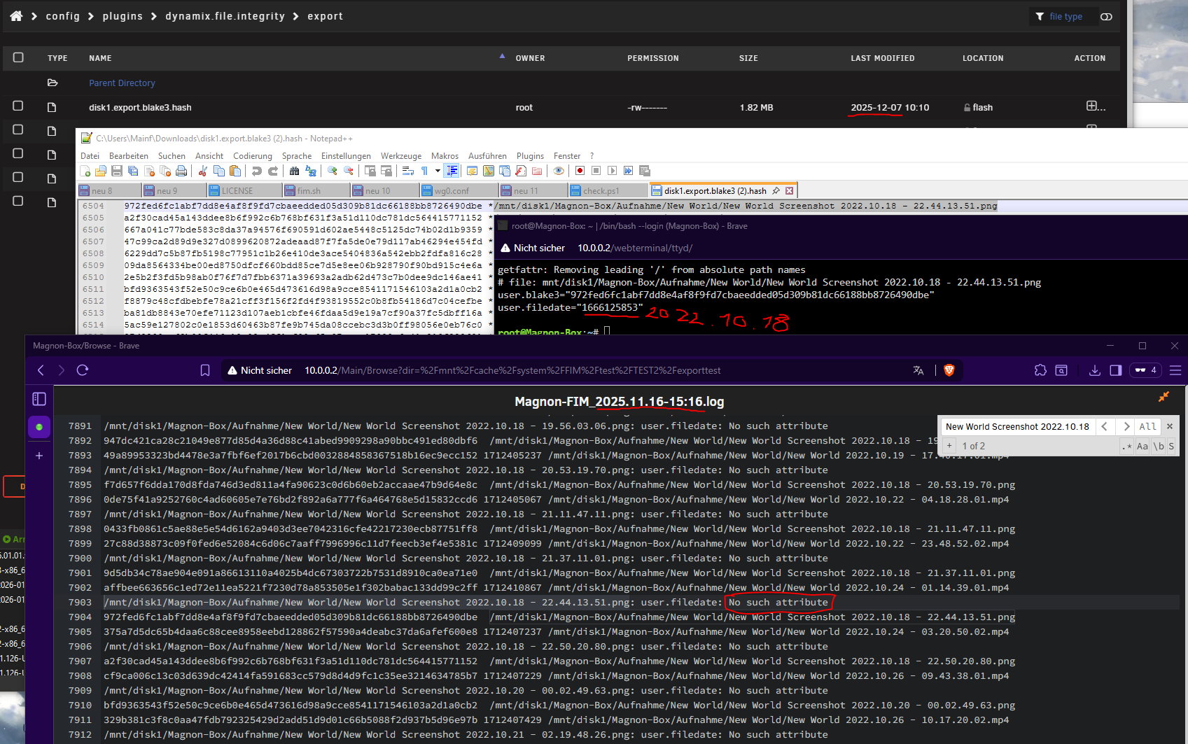

Ive observes something that should certainly be brought up. Im currently putting some finishing touches on something similar to this, but with more data points and also OS agnostic.
While working on the export feature, i noticed that a lot of files, which were processed by the plugins have their extended attributs not set, they all had their user.$HASH set, but the others like filedate, scandate were absent. So its basically useless for those files as there is no info about the mdate(as the export doesnt save it). It does like an issue with spacing in the filepath/name (not even special characters, but its too many files affected that i can say for sure)
So you should absolutely check whatever files you have summed with it if theyre actually still good.
Edit:
I did a retest, because of a youtube video i saw. It seems to work at least now the biggest issue is, even the current version failed to update the files. I do gonna add a screenshot of what i discovered and this just a tiny tiny tiny bit
raw
Edit 2
This is what the getfattr should have returned
Edited by Mainfrezzer

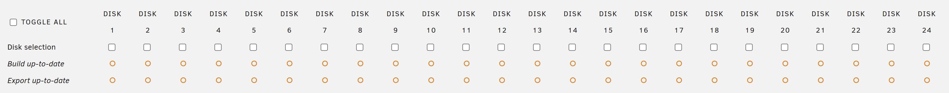

My control page always shows an orange circle = "represents and open operation".
The help text says that "For each disk the build and export state is maintained in near real-time."
To test this I added a test file (text, created with nano) to a disk and waited for 18 hours for it to appear in the export hash file. But it didnt.
It took a manual export for the file to be listed.
What is the expected behaviour?
What do the orange circles really mean?
Could it be that I am wrongly configured?
Thanks for sharing your wisdom!
