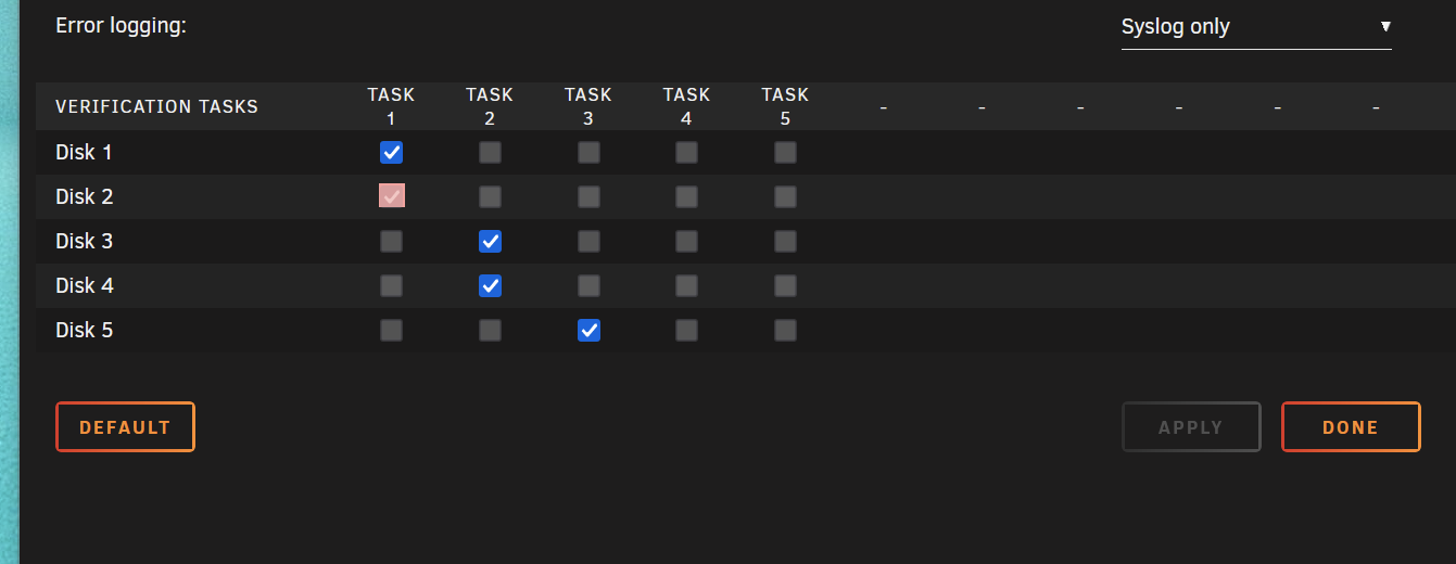

I just did a very quick pass through the code. The CSS seems fairly limited, so my guess (and that's really all it is) is that this pink checkbox is an artifact of the overall Unraid theme you have applied.
If you want to feel better about it- in your mismatch logs, are you seeing hits on files that are on that disk? If so, then your integrity checks are working and I wouldn't concern myself about it (unless @bonienl says otherwise).

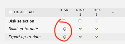

Hi everyone, I set up DFI for the first time today. It seems straightforward enough, but I seem to be running into an issue (?) that is puzzling me:
  • I hit "Build" to start generating BLAKE3 hash files for my all four of my disks at once.
  • Two of the disks are completed and the remaining two are still in the build phase.
  • I assumed that the hash files for the two disks that completed would be present, but clicking the "hash files" icon that opens the directory shows that there are no files at all.
Has anyone run into this before? Or, should I be waiting for the build to complete across all four disks first?
hashes are stored as Xattrs in the files. try getfattr -d filename. You can also export them to files on the boot usb.

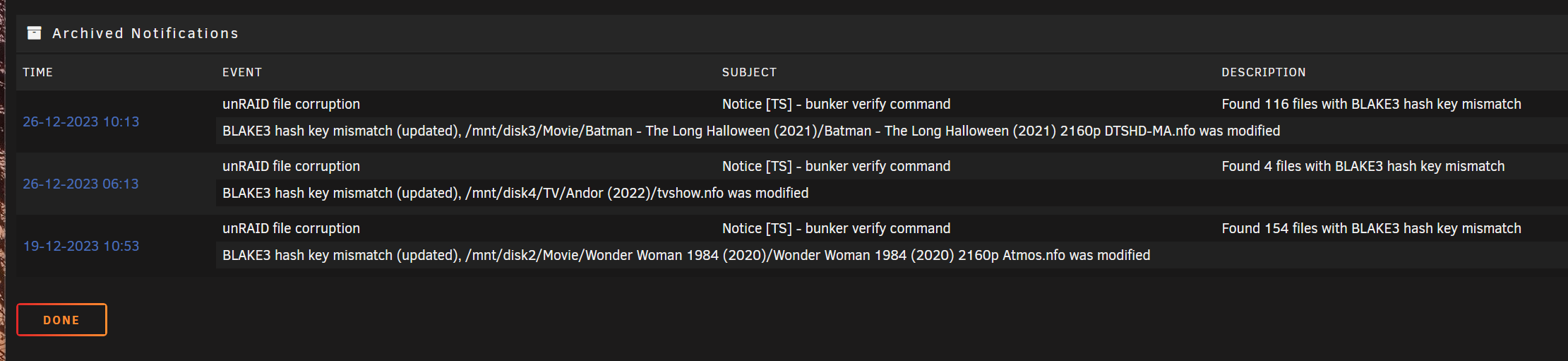

On 10/4/2023 at 8:44 PM, Mainfrezzer said:
the mismatch lets you know that the file was modified, got a new checksum but you have no current export of that new checksum(thats expected with .nfo files, there is no point in checksumming them).
the pink box is intriguing, no clue tho

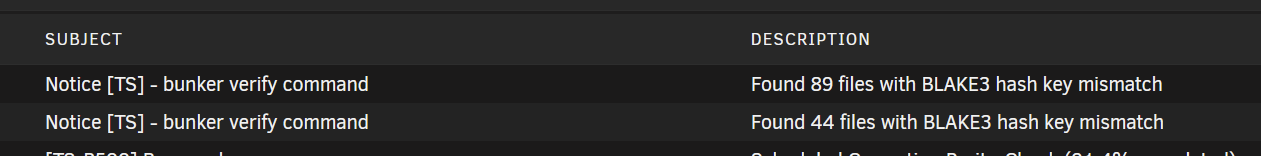

Recently the file integrity just finish checksum and this time no Pink Check box. but I'm still getting prompt that
unRAID file corruption: 19-12-2023 10:53
Notice [TS] - bunker verify command
Found 154 files with BLAKE3 hash key mismatch
How do i find what type of files are those?
Thank you, the getfattr -d -n command worked and output a blake3 value. The "Export" button doesn't seem to do anything at the moment... I do wonder if it's because the BLAKE3 hashes are still being generated on the other two drives.
Edit: Had a "duh" moment and realized I didn't select any disks before running "Export". Can confirm that exports work after selecting a disk, and I am just being a bit of an old fogey. Appreciate the help!

Each time when the file integrity runs i keep getting this type of errors.
How to resolve this? Ive already excluded *.nfo
You also need clear attribute on those .nfo file. and re-export the hash.
Edited by Vr2Io
Could you be able to guide me how to do that?
Use "Clear" button.
