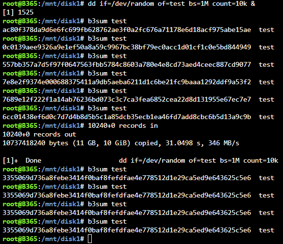

Below are simple test to show when a file not completely transfer/generate, if hash it will got different hash, but once completed then the hash won't change. This also the major reason for false negative. That's why I suggest disable "Automatically protect" and I almost trouble free.
Edited by Vr2Io
Are you supposing that a file that is a mere 2945 bytes was somehow hashed by the util before it completed writing and that's why the hash was incorrect?  Heh.  I sincerely doubt that.  Saying "A file's hash is different if you hash only a portion of the file." is kind of a silly thing to say.  Of course it is going to give a different hash.  It is different data.  I'd be incredibly surprised if we were talking about incomplete files being hashed, espectially given my initial report involving just 2945 bytes of data.  By your own admission, the util does not function correctly.  No point trying to defend it by saying it is mostly ok a lot of the time.  This is something that is supposed to be 100% correct 100% of the time.  If it is not, there's no point in using it.
Thank you...I believe this explains how I might have received my DFI integrity issue (files did not completely transfer, which I believe is caused by an Unraid defect for allowing/default 0 free space for a drive or the way Unraid pool handles 0 free space).

If you found hash mismatch, there are nothing hurt, you can completely ignore it like it never exist, and I would surprise file haven't hash will better then have. If you don't like FIP, you can use another tools, or use command line to call bunker or generate hash in your way. This just what tools you have and how the solution work.
I am not selling you use FIP, I just point out one of the issue why got false negative.
Perhaps the root cause is Unraid:  Files should not continue to exist if they fail to transfer/generate.

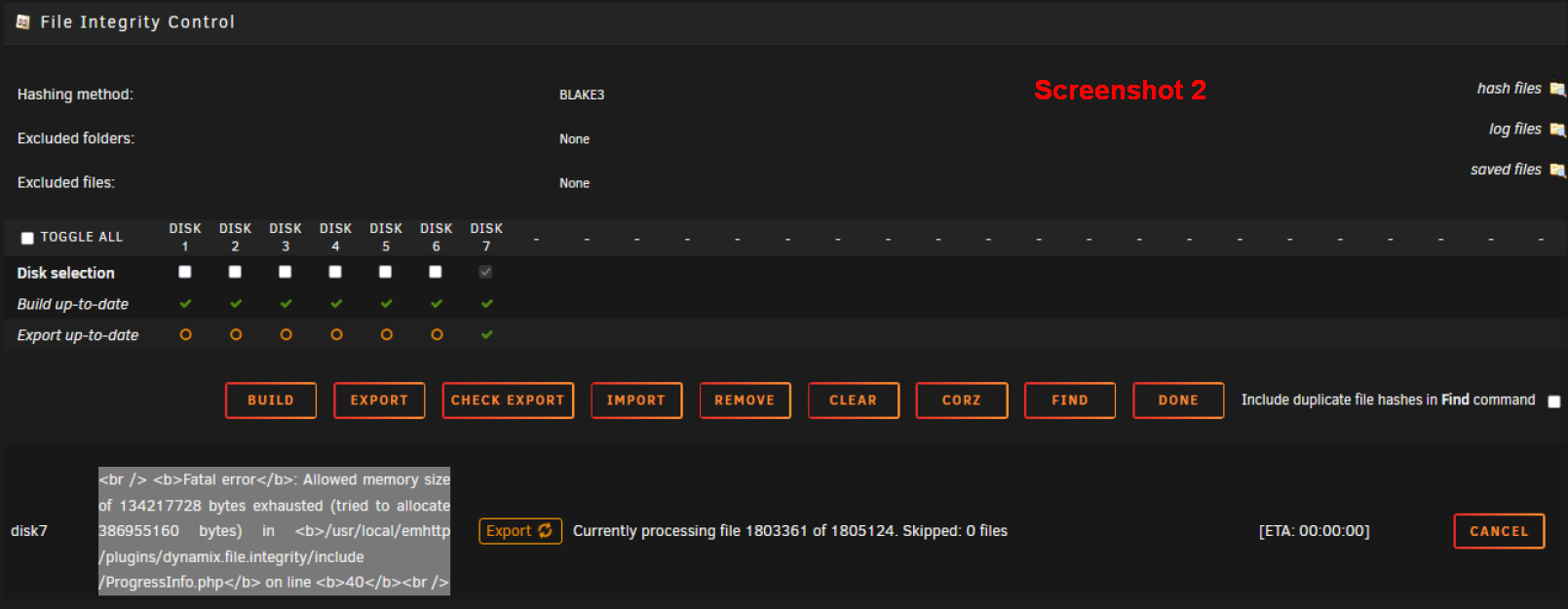

Hello.
I have a Disk No.7 (14TB) with very many Files (from small TXT to big Acronis TI Images).
File Integrity tells me, when I start Export: 1805124 Files.
Since it takes several Minutes, I leave the tool working.
After some Minutes I look on the screen, and it seems it is almost ready (Screenshot 1).
And some 30 Seconds or so later I get an error (Screenshot 2).
Where is the Error/How to solve this?

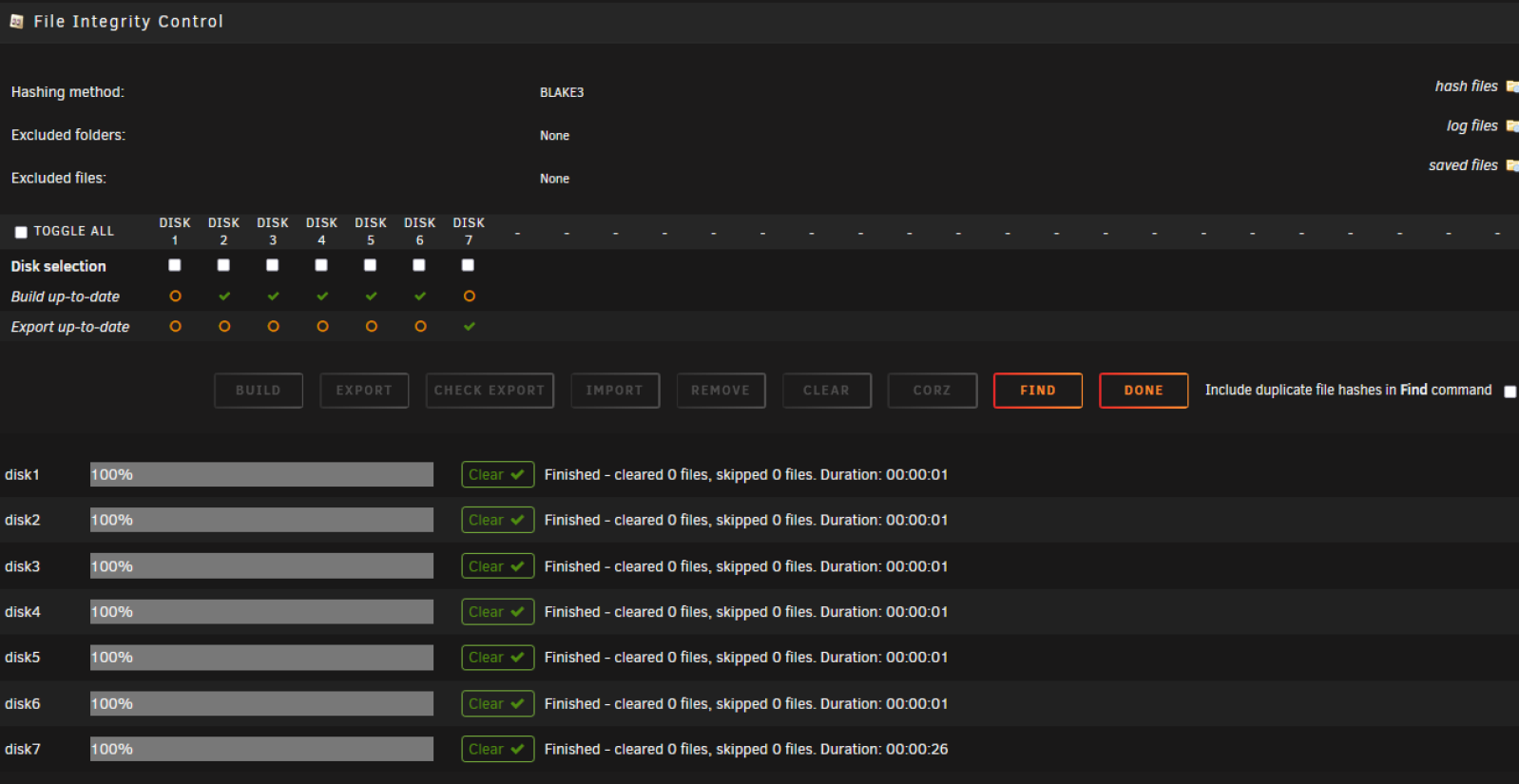

On 4/7/2022 at 10:51 AM, bonienl said:
Note for those who want to uninstall this plugin, before uninstalling the plugin itself you need to remove the calculated hashes, this is done by the "Clear" operation (select all disks and then Clear, see also the built-in Help).
After the plugin is removed, you can delete the folder /config/plugins/dynamix.file.integrity on your flash devices to remove all log and other files.
I wanted now to clear all those to uninstall the FI plugin.
But it looks like it did not clear anything.
I dont understand this plugin at all.
Sample check files by "getfattr -d <file>"
Could somebody answer this topic, it was asked twice on page 41, I think the query got lost in the rest of the discussion.
I have exactly the same issue, leaving me nervous.
I've started a rebuild of my disk 4, as I cannot export. I have a feeling that's not the right thing to do though??
Can somebody please elaborate on Sven's below issue, which is identical to mine?

So, after rebuilding, I've tried to export again. I get the same out of memory error. The system log says: Sep 25 19:56:30 Nexus bunker: added 756 files from /mnt/disk4. Duration: 00:36:04. Average speed: 280 MB/s Sep 25 20:05:05 Nexus bunker: error: no

Try below solution at page 43.
