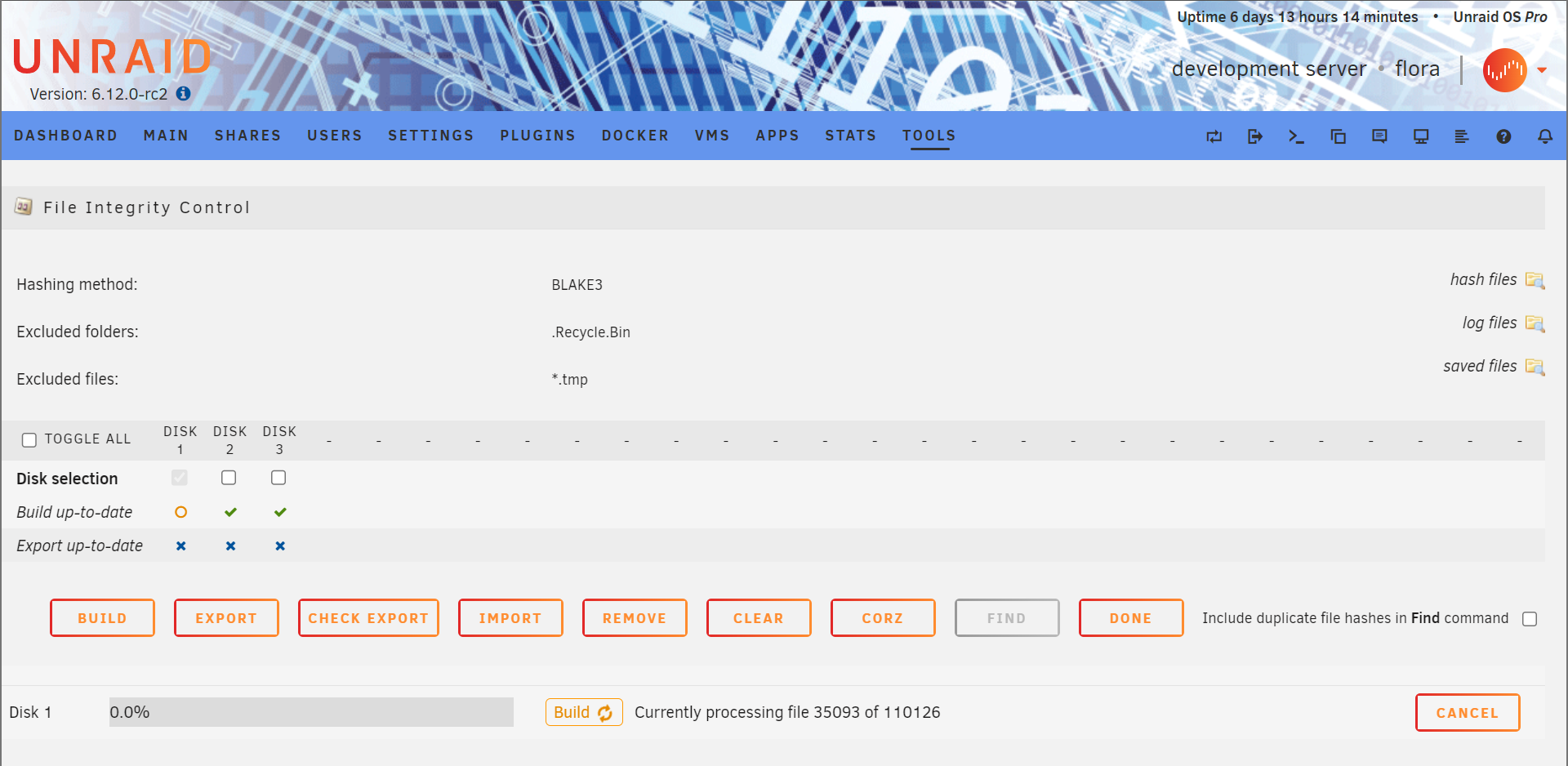

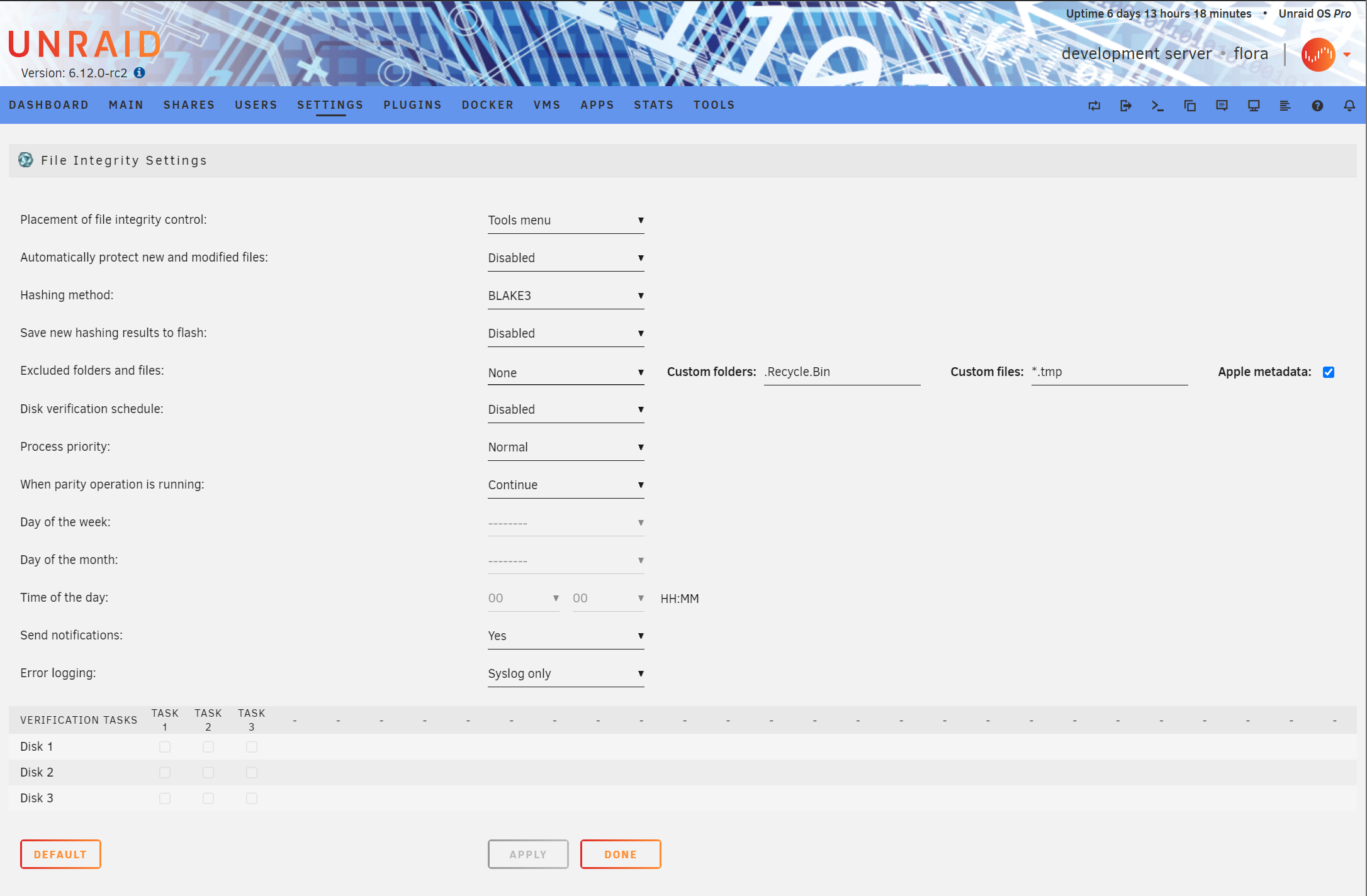

I tested this and everything works as expected.
Selecting all disks and then "Build" will create hashes for all new files.
These are my settings
Note 1: I have not enabled "Automatic protect", which is used to automatically generate a hash when a file is new or updated.
Note 2: I have not enabled "Verification schedule", which is used to do period verification of the existing hashes to confirm integrity.

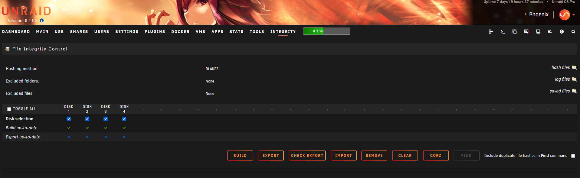

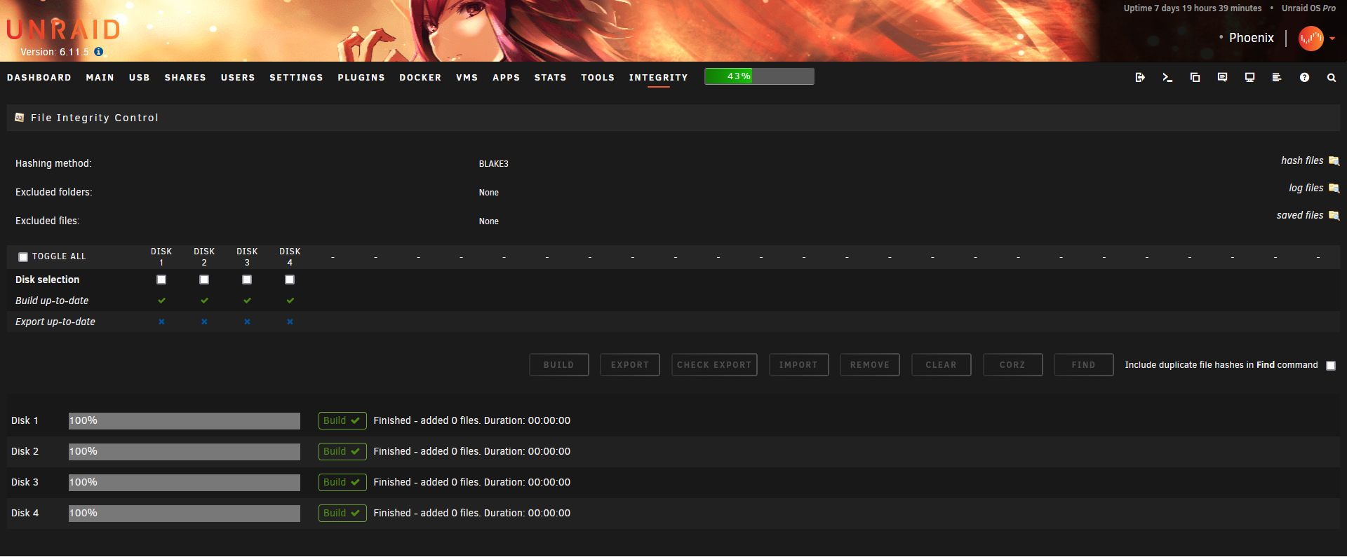

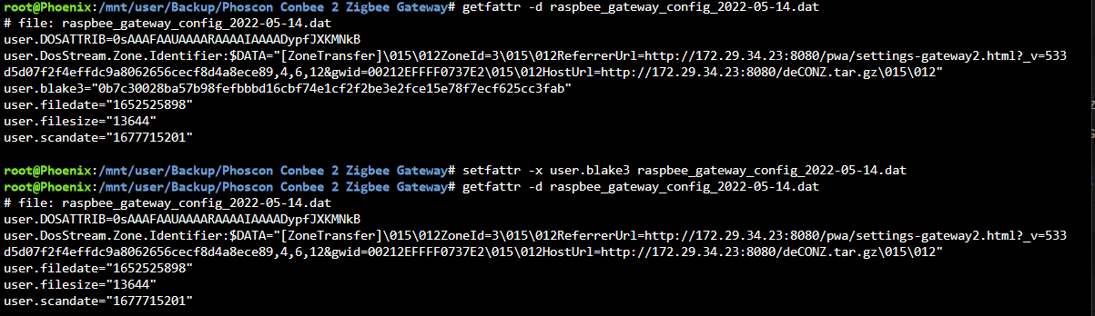

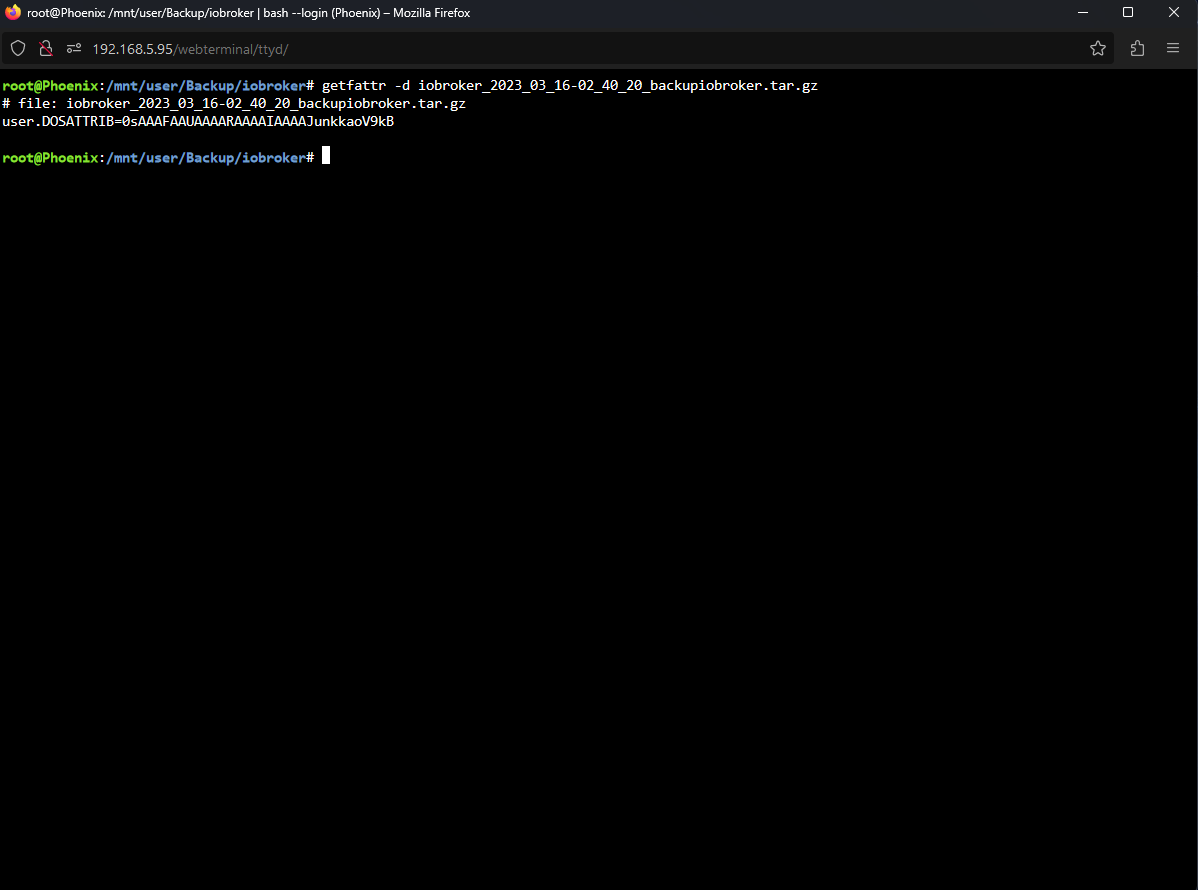

Well,
still no luck for me. Tried the same Settings as you @bonienl
but still nothing happend:
First selected all disks

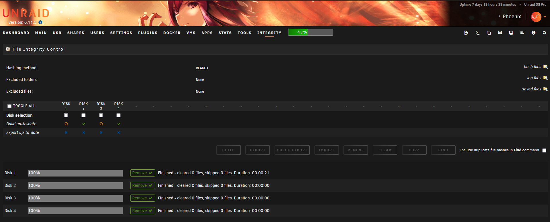

Now to be safe tried the remove command but here as well nothing happened:

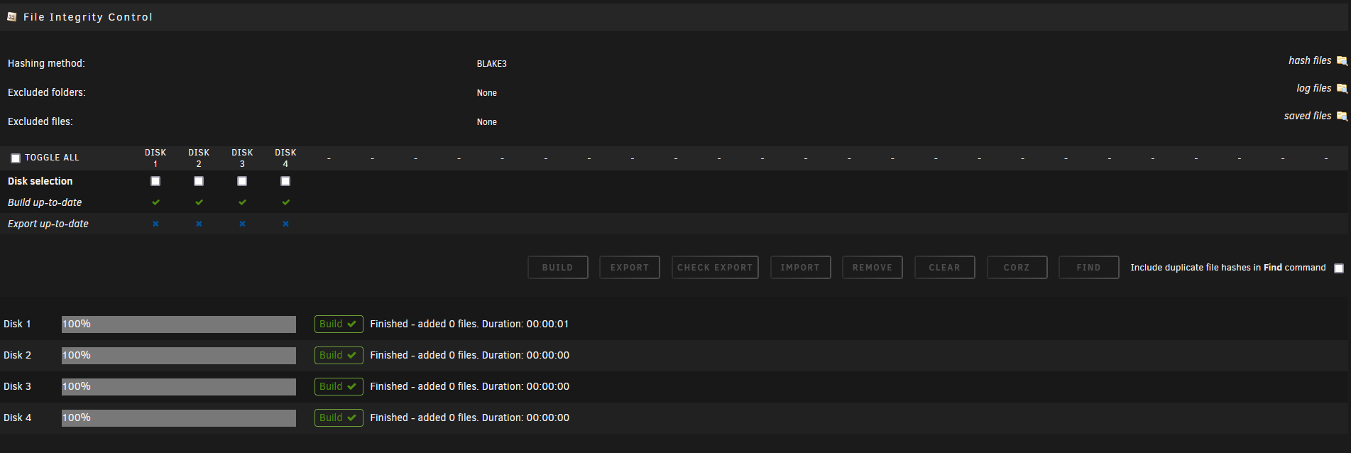

Then used the build option:
as you can see nothing happened.

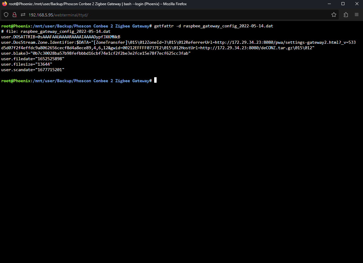

Now i checked to command line:
No hash has been added.
Also the next file was hashed before the plugin broke for me and yeah the Blake 3 hash attribute was added, however this attribute should have been remove from the previous remove command and as you can see it wasn't
You have a number of extra user attributes, which I am not familiar with.
Here is an example of a file on my system.
# getfattr -d 01-pihole.conf
# file: 01-pihole.conf
user.blake3="1df3f0fadee4bba95db9a2b5c513ff28ad6752c1e9d340532b468e22cef4285b"
user.filedate="1650279012"
user.filesize="1564"
user.scandate="1679741030"
What happens when you manually delete the hash attribute?
setfattr -x user.blake3 <filename>
The maximum size of the extended attributes depends on the file system in use. A file system like BTRFS is much more limited than e.g. XFS. Just wondering if you are reaching limits here!
The setfattr -x user.blake3 command does indeed work
well only my cache drives are formatted with BTRFS the main array drives are formatted as XFS
however running the normal build command from the plugin via the GUI doesnt work
still 0 files hashed

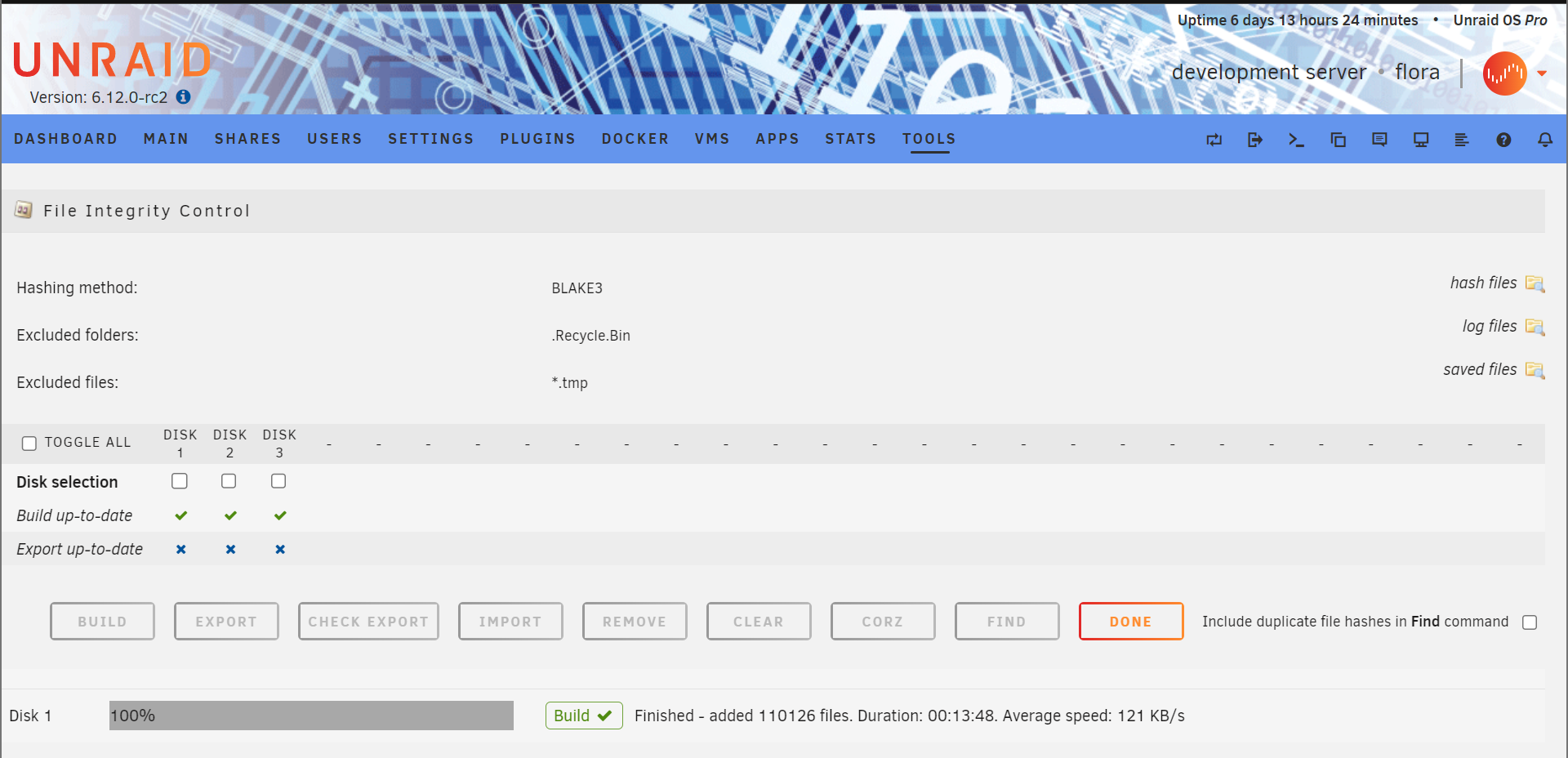

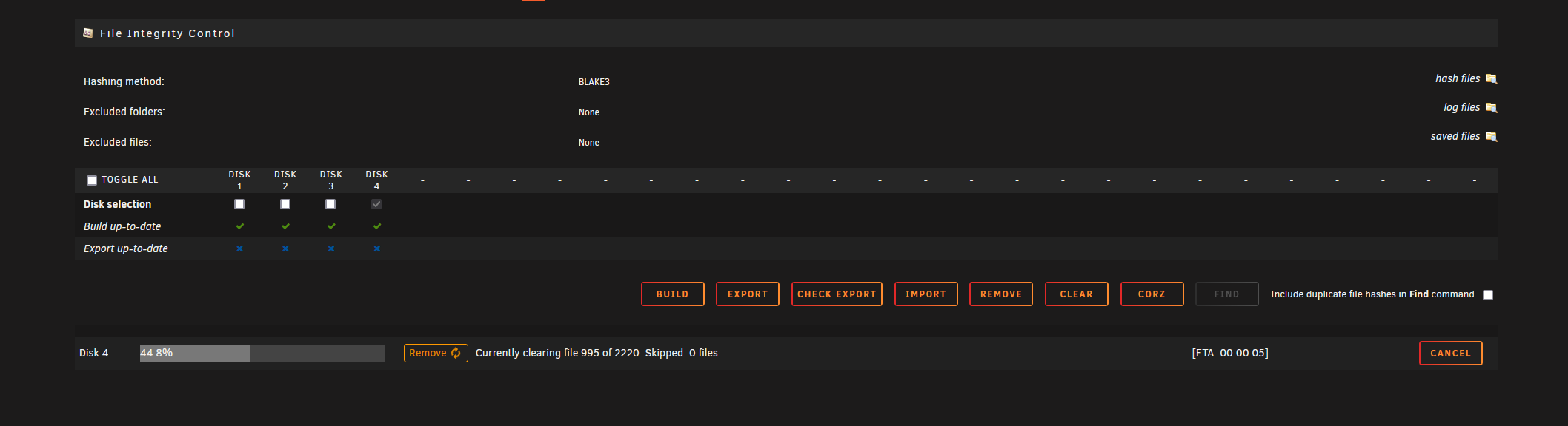

For me both Add and Remove work perfect. No issues on three of my servers.
The GUI is a frontend for the script "bunker" which performs the actual operations.
Can you open a terminal window and try the following
# Add hashes
/usr/local/emhttp/plugins/dynamix.file.integrity/scripts/bunker -a -b3 /mnt/disk1
# Remove attributes
/usr/local/emhttp/plugins/dynamix.file.integrity/scripts/bunker -R -b3 /mnt/disk1
The example has disk1, but you can choose whatever disk you want

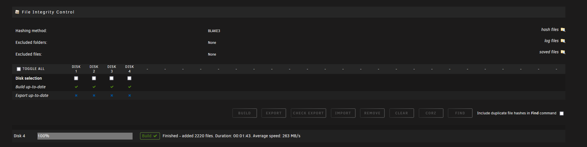

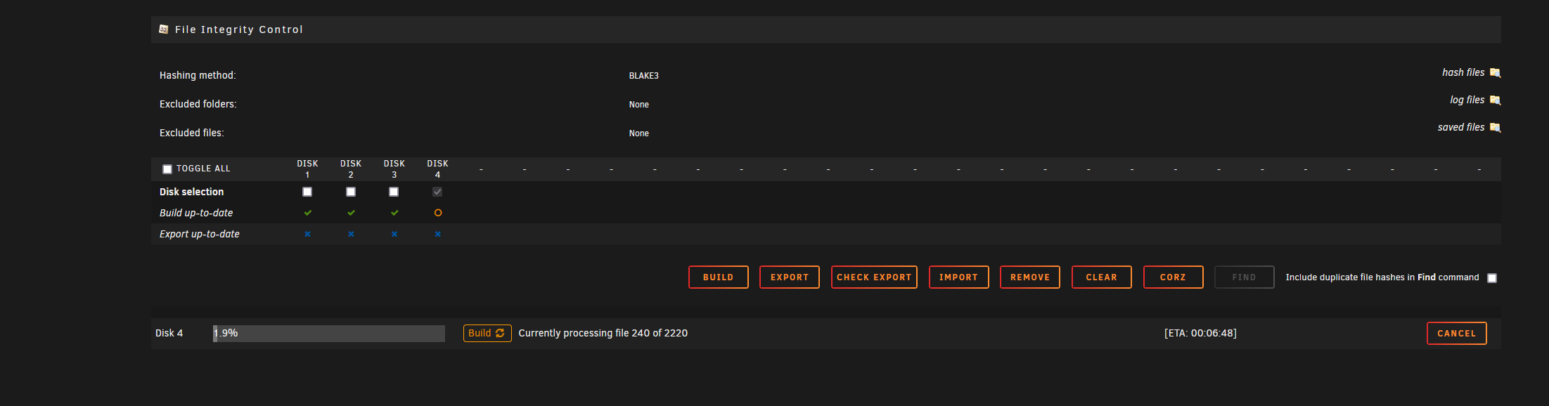

Using the command from the Terminal is working:
root@Phoenix:~# /usr/local/emhttp/plugins/dynamix.file.integrity/scripts/bunker -R -b3 /mnt/disk4
Finished - cleared 2220 files, skipped 0 files. Duration: 00:00:21
root@Phoenix:~# /usr/local/emhttp/plugins/dynamix.file.integrity/scripts/bunker -a -b3 /mnt/disk4
Finished - added 2220 files. Duration: 00:02:27. Average speed: 184 MB/s
I made an update to the plugin, please try and let me know.
Thanks
Updated the Plugin and now its working again :D

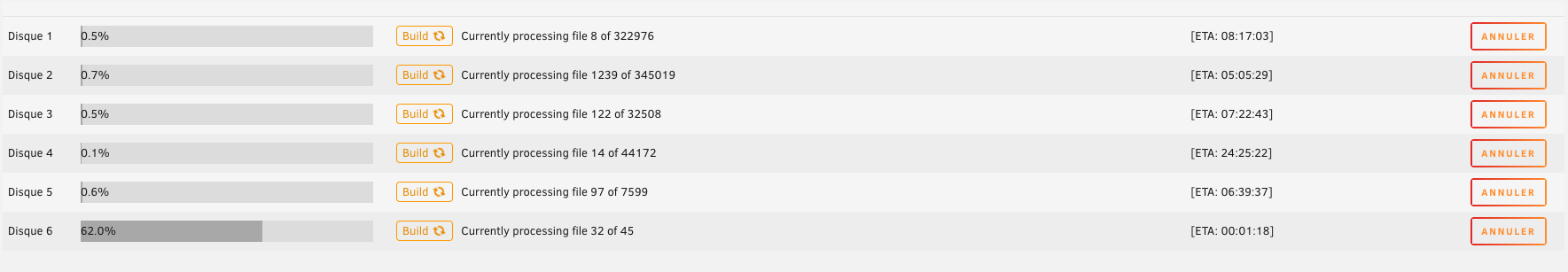

Having the same issues several users had addressed here over the past years, but I did not find any solution.
The Status shown by file integrity does not update.
Both build up-to-date and export keep showing open operations.
i gave it another try with the latest update and it seems to work now.
