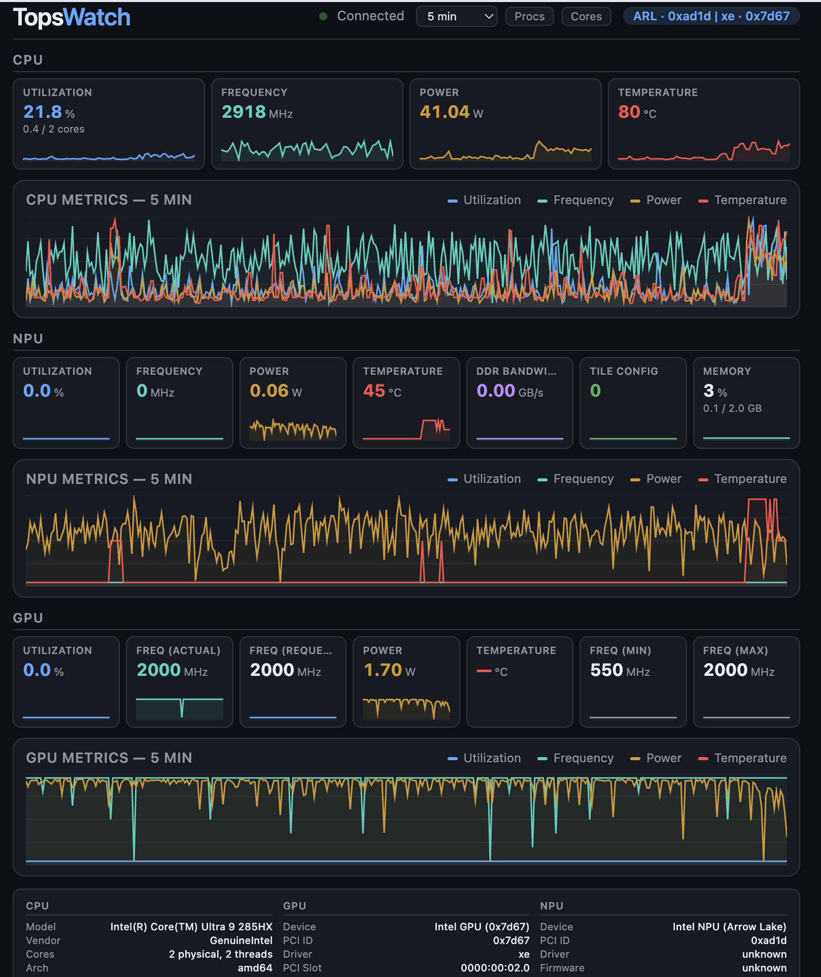

  9. @SimonF i think i asked you a few months ago about xe driver. At this time if i remember correctly it was not available because of unraid kernel (before V7). I didn't have time to look at it since. But i have a new server (running in proxmox) with intel gear which has integrated gpu+npu.cpu. I tried to use it for local inference without great success. Anyway i found a repo about a tool to monitor intel gpu with xe driver (also i915) details of compatible hardware are on the repo. I compiled it ti run it in a docker container and it seems to be working great. Maybe you can do something with it. the repo is Topswatch
