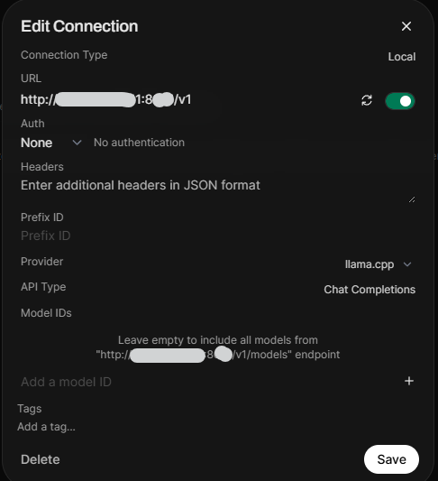

  3. Instructions updated to add multi model sections to the WebUI! Simply update the post argument to the new one added in the main post, run (or add to User Scripts) the attached above script to generate your 'presets.ini' file, and then that file will automatically list and pass all of your models to WebUI. This will enable you to have switchable models on WebUI without having to manually reload the llama.cpp container.

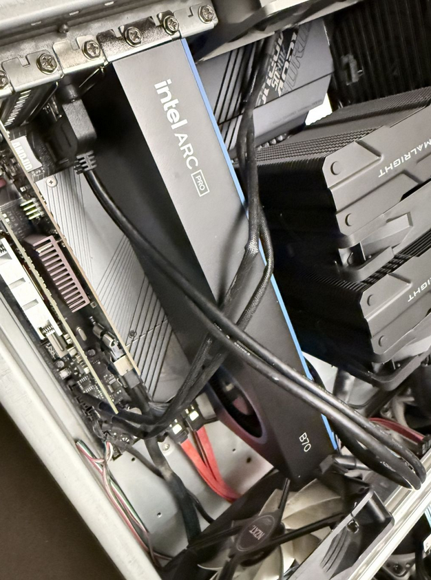

  7. I've finally got AI working on my B70. I had searched a lot online and nothing was coming up due to software support not being available. Here is what I found was working, and what you'll need. - The graphics card NEEDS to be its firmware updated. You can follow the guides here from Stupifier or by having it connected to a baremetal PC running windows first! The Intel driver installer contains a firmware update for the card, and these are the only delivery methods. Personally, I would not suggest doing this through a pass-through VM. - Bios up-to-date, Resizable BAR (ReBAR) enabled, 'Above 4G' enabled. - Running Unraid 7.3.1. or above. - Have the plugin 'Intel GPU TOP' installed. I have tried multiple AI docker containers, and found that only llama.cpp works best, others don't work, or have very very little functionality. Check previous findings here if you're interested. Here are my settings for this docker container. Notes: - The model location has to be inside of your selected models folder defined in "Model Storage Path". For the post argument, you only need to run the included script below, I use 'User Scripts' to run it as I add models, and that's it. - My setup has an intel 14700K which has integrated iGPU, it is possible you may need to change the Post Argument last part to --device SYCL1 (or maybe remove that part), if you have more cards or a different setup. Generation presets.sh Edit this script to edit the path to your models, and to add your graphics card information (such as the VRAM, etc) so that it can accurately setup the settings for the models. Con to this setup, when you have to change the model you have to do it in the post argument, it can't be done from the UI or from open-webUI. My open-webUI connection looks like this:

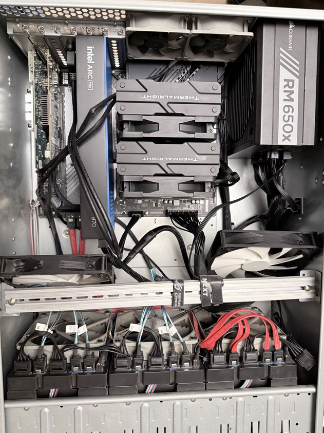

  8. I love this machine, great components, nice setup, beautiful. Definitely a great turn key solution for small-medium businesses, and anyone who just want everything done. (turns on firewall) However; most people here know how to build-setup their own server, so building this machine (different similar case) with some drives would come-in at about 1K $ less, here in the U.S. anyway.
