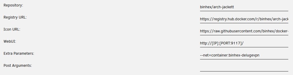

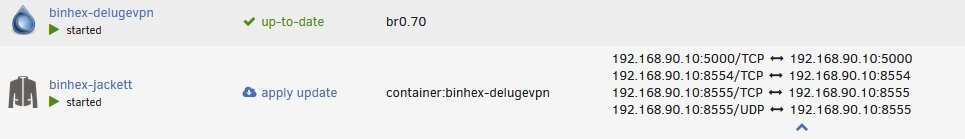

  7. I have been running my binhex-flaresolverr behind my binhex-delugevpn container for some time. Just recently I noticed that it is failing to work with Prowler (also running via binhex-delugevpn). It results in a connection refused every time. If I move the binhex-flaresolverr out from behind the binhex-delugevpn it works fine. I am a bit lost as to how to troubleshoot this as there isn't any useful logging showing why it fails.an I can curl flaresolverr from my Prowlarr container just fine: sh-5.3# curl http://192.168.xx.xx:8191 {"msg": "FlareSolverr is ready!", "version": "3.4.6", "userAgent": "Mozilla/5.0 (X11; Linux x86_64) AppleWebKit/537.36 (KHTML, like Gecko) Chrome/143.0.0.0 Safari/537.36"}sh-5.3#
