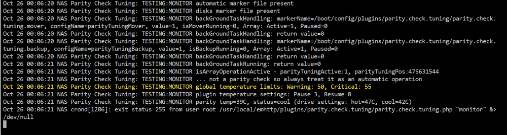

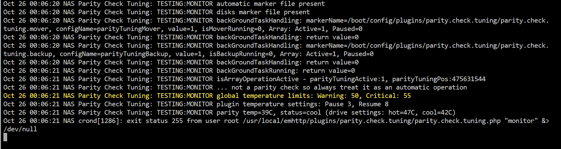

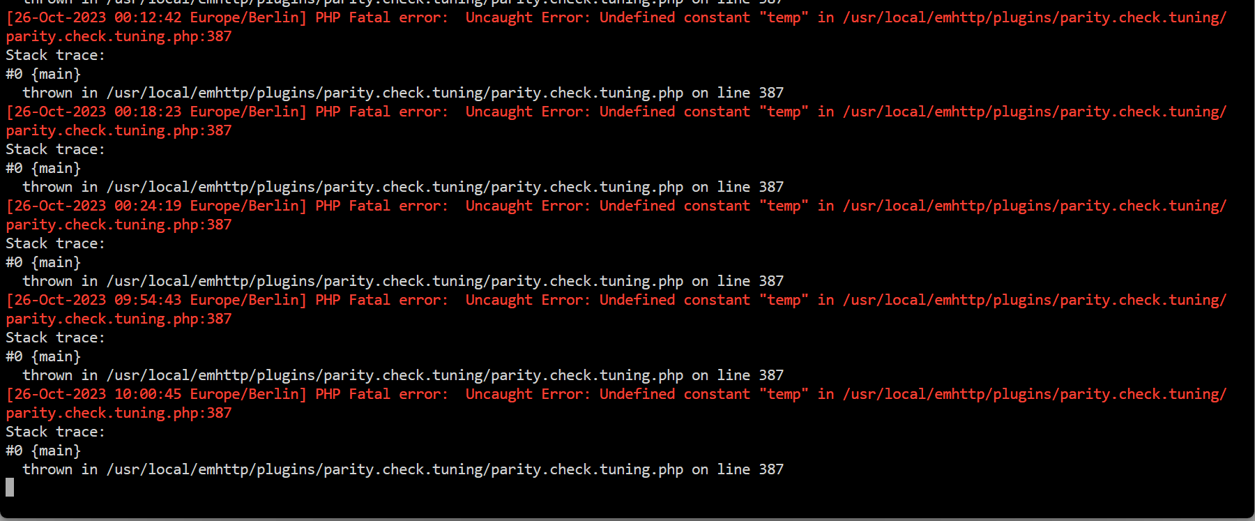

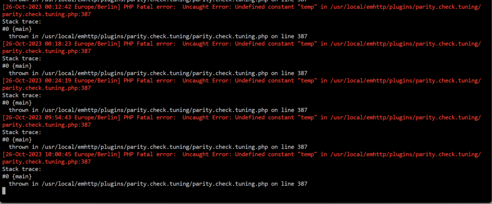

  13. This is what the PHP Settings error log tells me:
  14. This is the line where the temperature value is triggered
  15. Parity check tuning is not stopping anymore on disk overheat. Everything is activated, but the array rebuild just keeps going. Led to 4 completely overheated disks with Smart failure, as disks are very slowly overheating after some hours and cooling cannot be improved unfortunately
