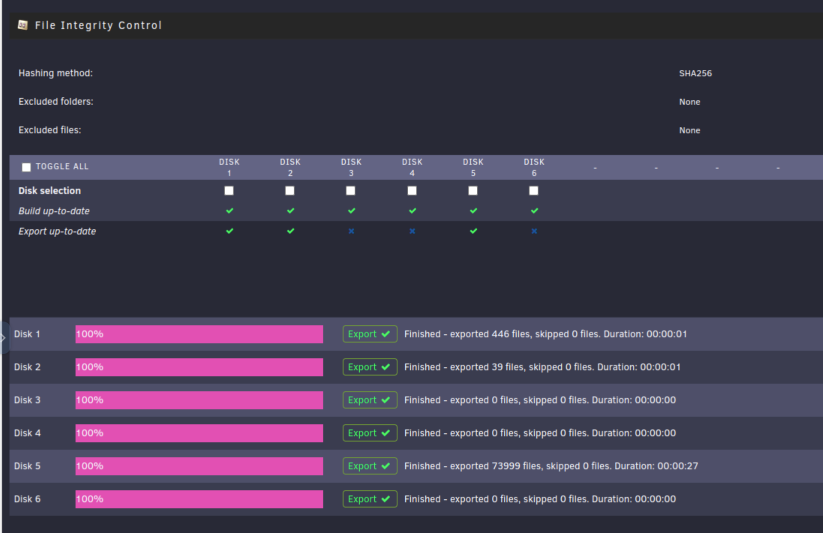

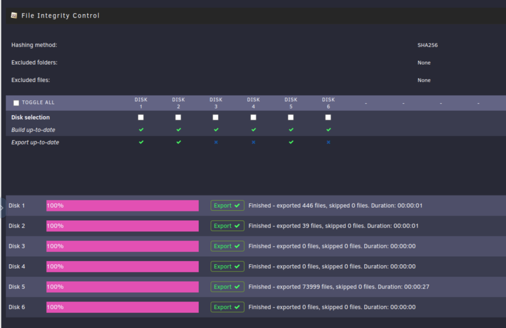

I have 3 disks that always refuse to export properly, even though the plugin says otherwise.  Is there something I am missing?
