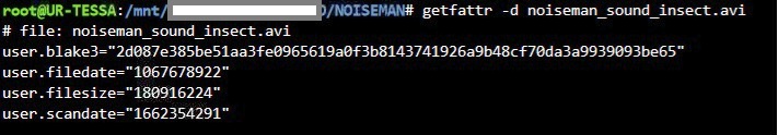

4 hours ago, Vr2Io said:
Sample check files by "getfattr -d <file>"
Thank you.
I did check one of the files:
getfattr -d noiseman_sound_insect.avi
And it looks like the blake3 checksum is still there (see screenshot below).
But I did follow the instructions:
"for those who want to uninstall this plugin,
 before uninstalling the plugin itself you need to remove the calculated hashes,
 this is done by the "Clear" operation (select all disks and then Clear, see also the built-in Help)."
And after I did this I removed the plugin and deleted the folder /config/plugins/dynamix.file.integrity
Edited by DataCollector
14 minutes ago, DataCollector said:
Thank you.
Strange, clear operation haven't clear extend attribute. If you want clear it, pls try install FIP again ( set blake3 ) for that or left those attribute there should be no hurt.
Yes. Strange.

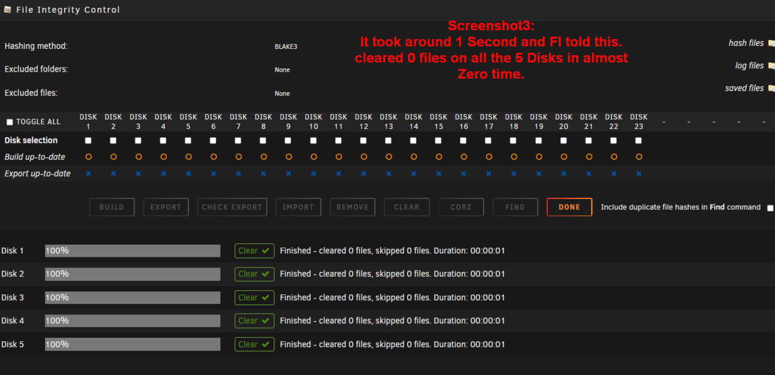

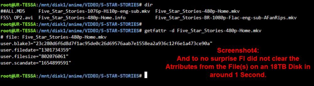

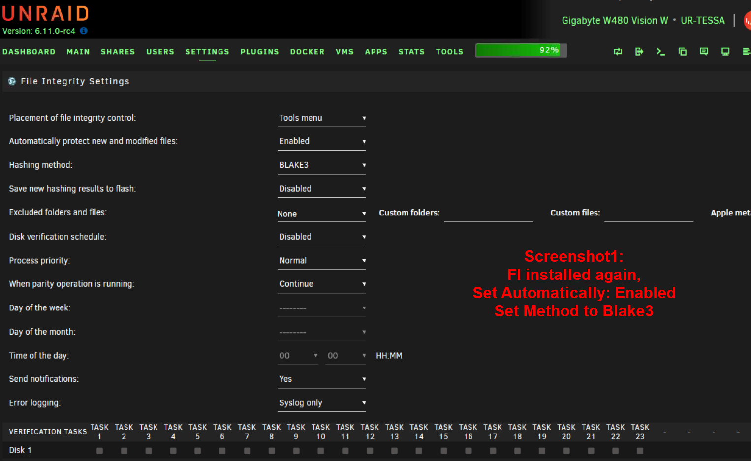

Now I installed FI again,
"Automatically protect new and modified files": Enabled
Method: "BLAKE3"
<Apply> (see screenshot 1)

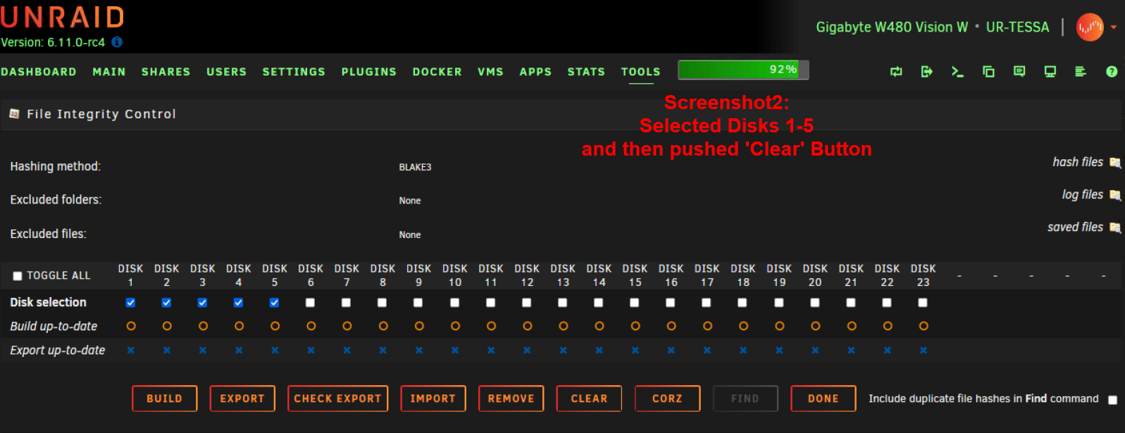

Then I spun up the first 5 Disks of my '1st System' (look at signature) manually and started in FI "Clear" for those Disks #1-5.
(see screenshot 2)

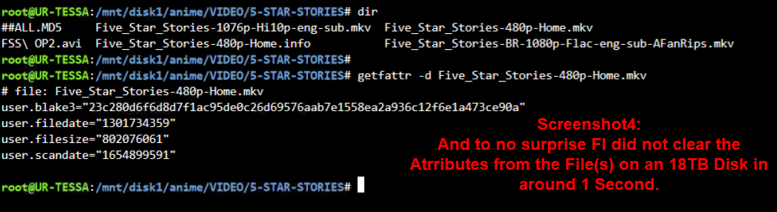

FI toook around 1 Second and then showed in green "cleared" (see screenshot 3)
And I then looked again at the attributes and Blake3 is there.
(see screenshot 4)
I am very sad.

Pls try
/bin/bash /usr/local/emhttp/plugins/dynamix.file.integrity/scripts/bunker -r -b3 /mnt/diskX
or
/bin/bash /usr/local/emhttp/plugins/dynamix.file.integrity/scripts/bunker -R -b3 /mnt/diskX
, where X is disk no.
/bin/bash /usr/local/emhttp/plugins/dynamix.file.integrity/scripts/bunker -h , would got bunker help
Edit : Overlook you should use remove instead clear
Edited by Vr2Io

EDIT: it seems "Clear" is the wrong command.   Today I tried "Remove" and that command did work on the disks for some time.
